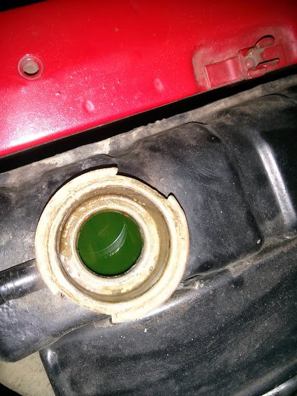

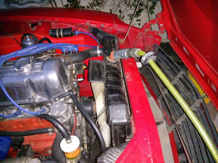

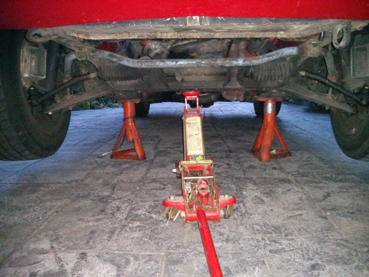

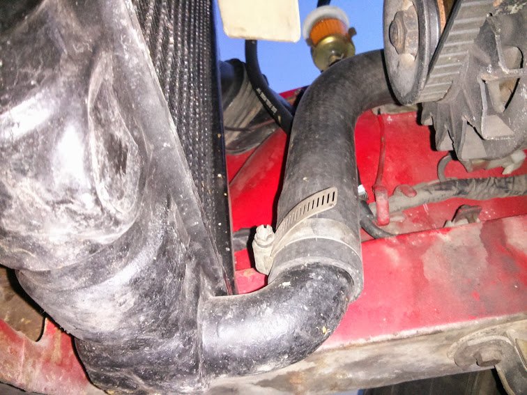

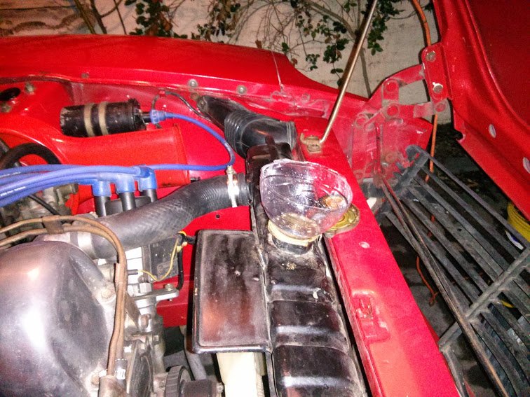

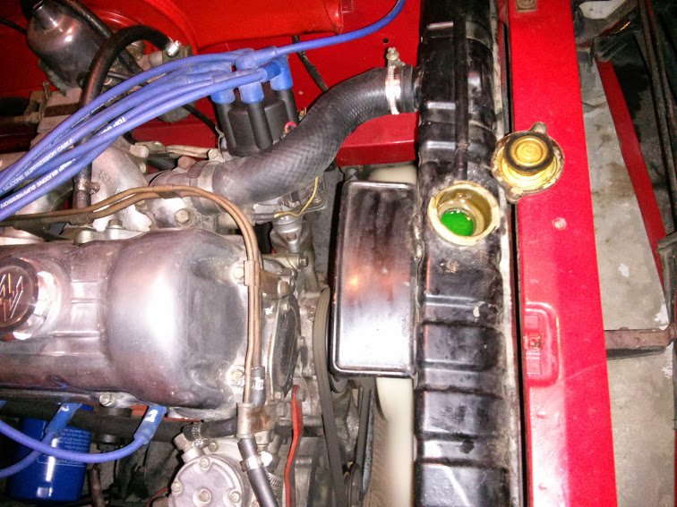

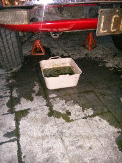

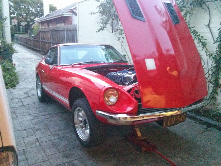

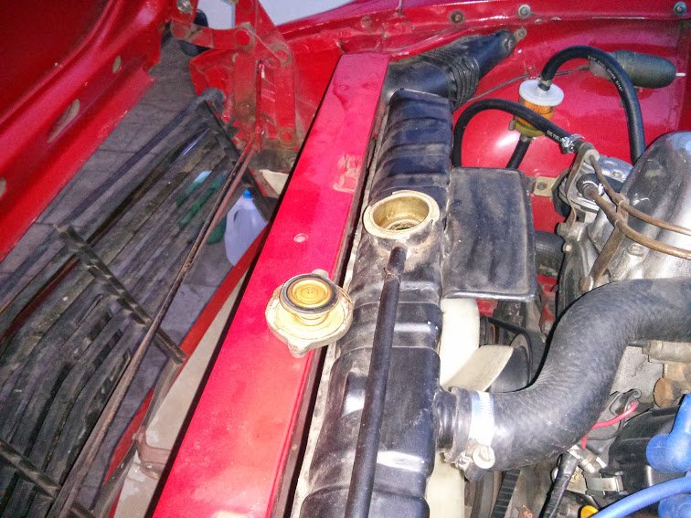

Administrators gav240z Posted April 27, 2014 Author Administrators Posted April 27, 2014 Ok so as promised a quick guide to coolant flush on your Z. I'm going to make an effort to have more 'how to' such guides on the forum in general. Since I started a build thread on my 72 240z and I went through my previous history of owning a Z I remembered that when I started I really was very naive when it came to my Z and working on cars in general. Creating guides like this will help others who are perhaps looking to get started with the mechanical work an idea of what's involved and more confidence to give it a go. Before you start you may want to run your car up to warm / hot and then allow it to cool again. I did a sneaky drive around the block (since it's not registered at the minute) Step 1. Jack up your car. I like to use the cross-member to do this. I place the axel stands under the chassis rails where the tie rods connect to. It's a solid section of the car and it won't bend the metal here. Step 2. Remove the radiator cap. How the coolant looks before being drained, as you can see still pretty green, not rusty water like many Z's these days You don't have to do this (remove the cap), but it helps drain the coolant faster. You may also want to have a new radiator cap ordered in advance since a cap that looses pressure could cause over-heating. Mine seems ok, but I'll replace it later at some point - just as general maintenance. Step 3. Drain coolant. There is no drain 'rooster' on the 240z radiator. Unless you've gone aftermarket. Therefore we need to remove the lower radiator hose. It's held on by a jubilee clip. I recommend using a 10mm socket to undo it, but I used I screwdriver. If it's particularly old you may find it rusted in place and difficult to remove with a screw driver only. Therefore you can skip some headache and go to the socket. Again a good maintenance item would be to replace the jubilee clips. I personally like the t-bolt/clamp's you see on modern intercooler couplers etc.. They provide a more even clamp around the hose and seem a bit more robust than older style jubilee clips which can fatigue and crack and not tighten properly. Again not something I did as mine were still ok, but I might do that in future. Getting the hose off the radiator pipe could be difficult as it tends to bake itself on, if it's been a while since last removed. The trick is to wiggle it left to right to try and break the seal on it. You'll want to have a bucket under the car to catch the coolant, as it will gush out coolant when it's removed. As you can see we had a bit of a minor accident, this was pretty hard to prevent unless I had a bigger tray / bucket under the car. Hence the reason I did it in the drive as opposed to garage. Step 4. Flush the crap out. I used tank water (rain water) to flush all the remaining coolant out of the radiator, the heater core will still have some crap in it or remaining coolant I should say. So what I did was fill the radiator with tank water until the green stuff disappeared and all that came out was clear looking water. You can see the clear water in the radiator pipe. Step 5. Removing as much old coolant as possible. The idea here is to remove as much of the old stuff a.k.a coolant (I don't recall what brand it was previously) because it could have additives in it that react with the new stuff and in some cases this could accelerate corrosion or cancel out the anti-corrosion properties of the coolant. This is why it is good to use the same type of coolant each time if possible. So make note of what you used so you can use it again in future. In the previous step I showed how I used tank water to remove as much of the old stuff as possible. I then re-connected the lower radiator hose and tightened the jubilee clip back up and filled the radiator again with regular tank water. Then I ran the car up to normal operating temp (about mid-way on the temp gauge. Unfortunately not the best photo - I should have checked it when I took it, but it's about mid-way up the range. Turn the heater on and set the controls to heat to allow the coolant / water to move through the heater and back into the cooling system. Once it's up to temp and been running a little while, turn it off again and allow the engine / coolant to cool down. Step 6. Drain the coolant - which should be mostly water now anyway. This should remove most of the old stuff and allow you to top up again with new stuff. The picture above is the old coolant + tank water that was drained, as you can see it looks a very pale green colour now. Step 7. Filling with coolant again. I didn't have a spare 'clean' funnel to use, so I cut the top off a water bottle and used that. I filled about 3.5 litres of concentrate. It's just a regular ethylene glycol based coolant, if you're not sure what brand to buy just make sure it's compatible with an alloy engine head. I then used about 2.5 litres of distilled water. This is somewhat optional (see posts above), but for the small extra expense I did it, since the car will be sitting and not driven often - I'm hoping to resolve that in future though. Step 8. New coolant, run to temp. So with the new coolant and water mix, I started the motor again and let it run up to temp with the radiator cap off. I would squeeze the lower and top radiator hoses to try and force the air bubbles out of the cooling system and burp it. Note: Be sure to wear tight fitting clothes here, you don't want to be wearing a scarf or loose shirt and have the radiator fan grab you! That wouldn't end well. I would top up with distilled water as I went gradually adding it if required, but honestly it didn't seem to need much only a couple of drops here and there. Once I was confident the thermostat was open I checked to see if more water was required but didn't really need to add much. I then placed the cap back on and gave the car a few revs. I've kept the left over coolant and water just in case I need to top up again. I guess a good drive would be useful here, then allow the car to cool before opening the radiator cap to check if the water level has declined again. Top up as necessary, but if you find you have to continue to do this often then you may have a leak - check your hoses are tightened properly or busted water pump (common) etc.. or worse blown head gasket or a leaking engine head from corrosion or overly aggressive port job etc.. I should point out that this is just the way I did it, but if you have any additional tips / tricks or suggestions on ways to do this better feel free to contribute your own thoughts to this thread. On my FD RX-7 I used a lisle funnel. https://www.google.com.au/search?q=lisle+funnel& To help with the burping of the cooling system, unfortunately I didn't have it with me in Melbourne (it's in Sydney) but I recommend these as a good funnel to have and will make life easier. Although it seems the 240z cooling system isn't that hard to burp. I'd also like to eventually switch to Evans waterless coolant - I've heard great things about it. https://www.google.com.au/search?q=evans+waterless+coolant But you need to ensure you are totally free of water before using this stuff and there is a transfer liquid you use. It's also expensive, but is a lifetime product. I'll probably give it a try when I have finished the rebuild on my Safari Gold motor. Quote
Administrators gav240z Posted April 27, 2014 Author Administrators Posted April 27, 2014 I should also add that I put the old coolant in an old container, and the coolant on the drive I washed down with the tank water. Since coolant is toxic you should make sure it's not within reach of pets or small children who may try and drink it. Coolant is sweet smelling to pets in particular who may try and drink it. So make sure you keep it out of reach of children or pets. Ideally take it to a local council chemical waste disposal place - look it up on their website. Quote

zeds4ever Posted May 22, 2014 Posted May 22, 2014 Not bad Gav, back in the old days we used to take the radiator completely out . Turn radiator upside down & place a hose in bottom hose fitting making sure that the hose was sealed with rag around it so as to ensure the resultant water pressure when the hose was turned on fully would flow thru the radiator thus removing any sediments etc would be totally flushed out via the top openings. There are a few other old farts on the forum who will attest to this method. Regards: Alan. Quote
Moderators PB260Z Posted May 22, 2014 Moderators Posted May 22, 2014 Not bad Gav, back in the old days we used to take the radiator completely out . Turn radiator upside down & place a hose in bottom hose fitting making sure that the hose was sealed with rag around it so as to ensure the resultant water pressure when the hose was turned on fully would flow thru the radiator thus removing any sediments etc would be totally flushed out via the top openings. There are a few other old farts on the forum who will attest to this method. Regards: Alan. Not sure about the "old fart" comment, but this works. I find that a Nylex garden hose fitting is snug fit in the lower radiator hose, tighten the clamp then turn the tap on and shake. This usually results in rusty crap all over the lawn. Quote

84ker Posted May 23, 2014 Posted May 23, 2014 Great write up! Just another method, after you remove the bottom radiator hose to drain the radiator refit the hose. Remove the thermostat housing and thermostat. Then you can put your hose in the top of the radiator and with the heater tap on you can flush the entire cooling system including block and heater in one go, you can also put your thermostat in a jug of boiling water to make sure it's opening properly. Once done refit thermostat with new gasket and fill with coolant and water! Quote
