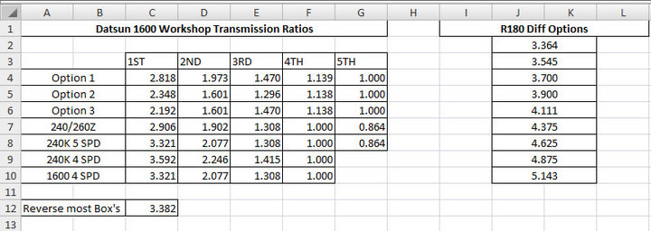

lampy Posted March 12, 2014 Posted March 12, 2014 Wish i could find a option 3 for my 1600. Hard to get a box with a 1:1 1st gear for a high rpm 4 cylinder Quote

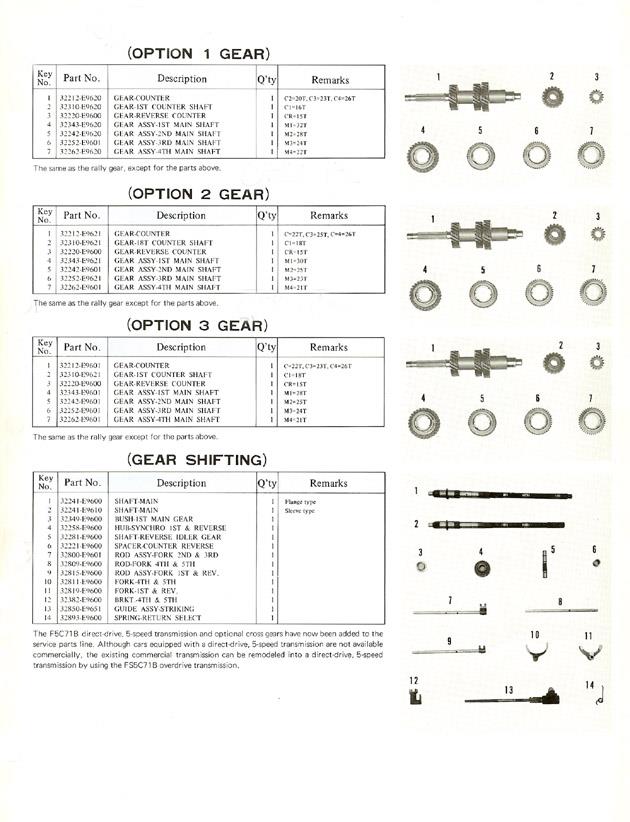

dat2kman Posted March 12, 2014 Posted March 12, 2014 Hodgo, can you possibly message me a decent high res scan of the page showing the pictures of the gears and their corresponding ratios/tooth counts, thanks. Also, What is the shift pattern on your various option boxes? Have heard various, depending on wether it was a proper factory box, or, some XXX company gearbox modifier, ie Albin/Holinger/etc First to left then either up or down,,, or first to far right then up,?? Gears 2-3-4-5 always in the H pattern I have some internal pics of the Holinger version that is in the Y, bit odd, it is full synchro on first, which is where fith would normally be, ( reverse is same position) but it has dog engagement on 2.3.4&5, in place of synchros, tooth count is odd too, it's a combo of Opt2 and Opt 1, George stipulated to Holinger, exactly what he wanted! Quote
bluerat Posted March 13, 2014 Posted March 13, 2014 All the one's I've seen are the same as the Stanza 5 speed, ie rev where 1st is, 1st where 2nd normally is and so on. Doddy had an Option 3 in the ex Portman Bluebird and even with a 5.1 it took some serious clutch action to get it off the line...but zippity doo dar after that!! My understanding the only difference between the works ones were extra little holes and slot's in the housing to get a screw driver in there if it jam's in gear. Mazda rotary C/R box's were like yours Jase, 1st where 5th normally is then 2nd to 5th in the 'H'..but you probably knew that!! I cant remember the brand. Lampy look into a 200sx etc etc etc 6 speed, if you get the right one they have a 1-1 5th, but unless it's the Nismo one the rest of the ratio's aren't spot on for a 4 cyl. Quote
