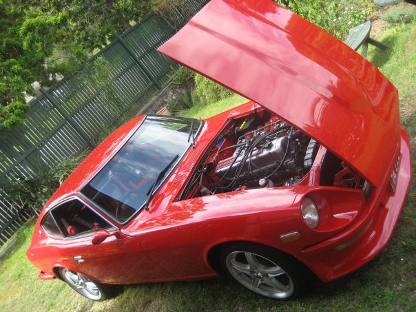

74zzz Posted October 1, 2013 Author Posted October 1, 2013 Thanks for the info lads! I would like to keep it local as the more distance I feel less in control of cost and whats being done! but i will check out MIA haha Dat2k it already has triple 45 (not matching so am getting new set) very shaved head port matched manifold, billet cam (not sure what specs though-smart Auto did this) l24 rod with flat tops. The head has too much taken off it was 10.20:1 compression - Jim at smart decided to put a head saver kit on it to be safe (i'm not sure what this does to durability. currently has 160 at the wheels. was thinking considering the head had 2500 work of work before i bought the car and then I spent a further 2500 reconditioning it and the billet cam- I think the top end is done......hoping to take it to 3.0 or at least 2.9 so more bottom end work. Maybe I should take it back to JIM at Smart he seems to be the pick in bris. have budgeted 6000 total considering money already spent. Many have tried to convince me of the rb25 swap which I have really considered recently in terms of reliability, tunability and potential HP however have never been able to get a real picture on total cost to make this happen (the purist in me wants to stay carbed and asking cost is asking how long is a piece of string) but i guess the weigh up is cost as i wouldn't tackle a conversion DIY style. cheers all for the advice and if anyone has done a final costing for the rb swap I would like to see it! Quote
74zzz Posted October 1, 2013 Author Posted October 1, 2013 forgot to mention has a standard gearbox with heavy duty clutch and a standed ratio clutch r200 lsd and hilux front conversion and lowered kings already. have been out of the z loop for a number of years due to being OS so would love to meet and chat with brissie z owners whenever your free or on cruises! Quote
dat2kman Posted October 1, 2013 Posted October 1, 2013 Sounds like you are well on your way! Leave the head as is, it may need the fully adjustable twin sprocket timing chain tensioner setup. Jim has fitted these, i can supply him with them, or you get one from my stock. Stick with Jim at SMART, you already have a relationship there, he knows what you have etc. Re the triples, when you say "unmatched" what are the model numbers? I can check my Weber model books to see how "unmatched" they really are, it will be, mostly, slight differences in the internal progression passages, which may not be an issue. The bottom end! A decent harmonic balancer, if not already, a set of longer forged rods, a set of shorter height pistons, balance the lot, maybe knife edge the crank a bit, a bigger capacity cast alloy sump, a Turbo 280ZX oil pump, ( got thosenew, here too!) Be mindfull of not upping compression, a 280ZX distributor, if not already. The block will need to be sonic tested to see what you can punch the bores out to. Any more than 80 thou, they get awful thin in places! Bigger capacity involves a Diesel crank though, jim has done a few of these. He farms out work for balancing and machining to the right people!! Sounds like you may need a close ratio gearset swapped over into your box, cheap, or, a c/r set fitted to a later RB type box, a bit more expensive! When you are ready for that, i can get you going. Quote
