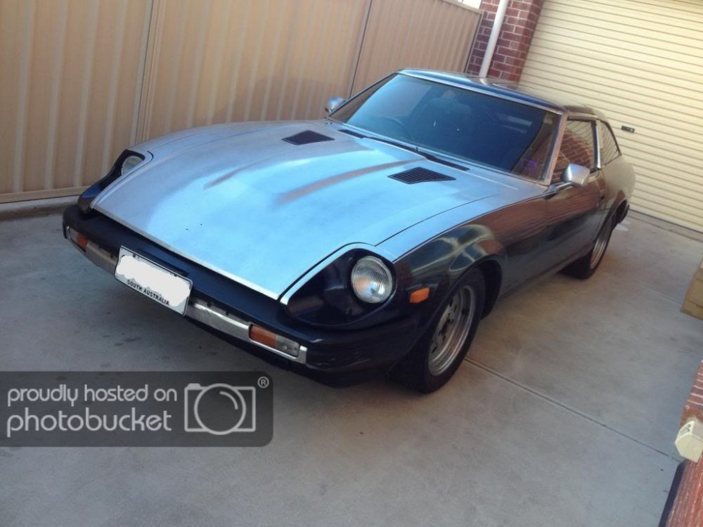

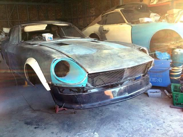

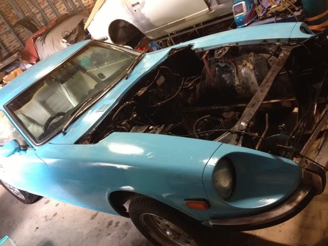

Bit of work done over the weekend. Due to silly weather gale force winds and rain any work i planned for outside went through the window.

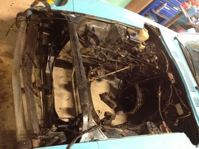

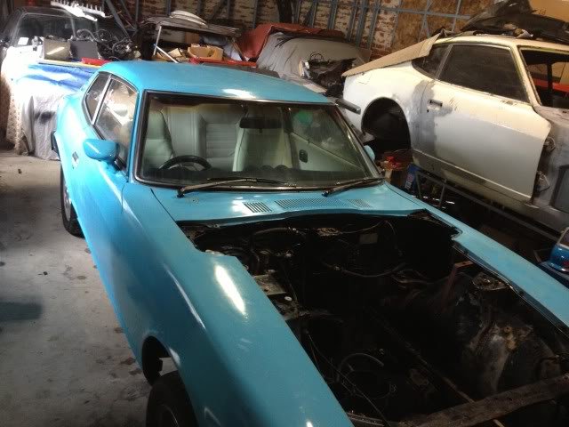

So rearranged the workshop and sqeezed the 260z inside. Didnt think was possible but it was.

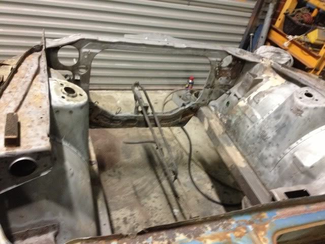

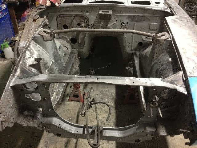

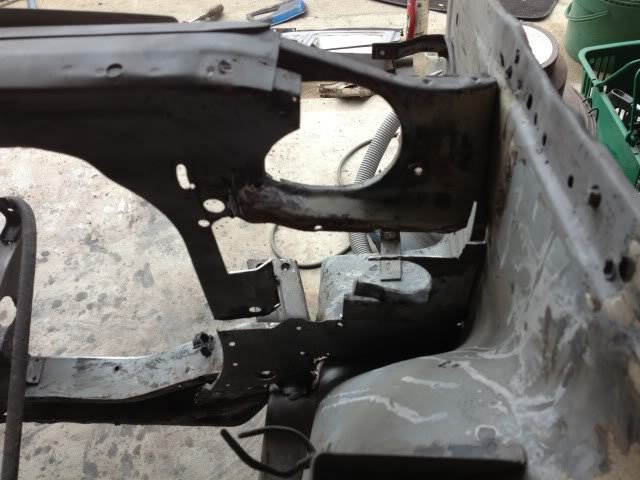

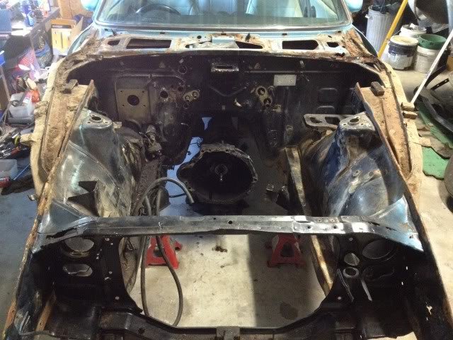

Took the engine out. And started stripping the entire front end.
Also managed to get a l28 n42 combo from Greg and few other goodies. But on that later. Priority is fixin the front end and painting it asap.
So more deconstruction

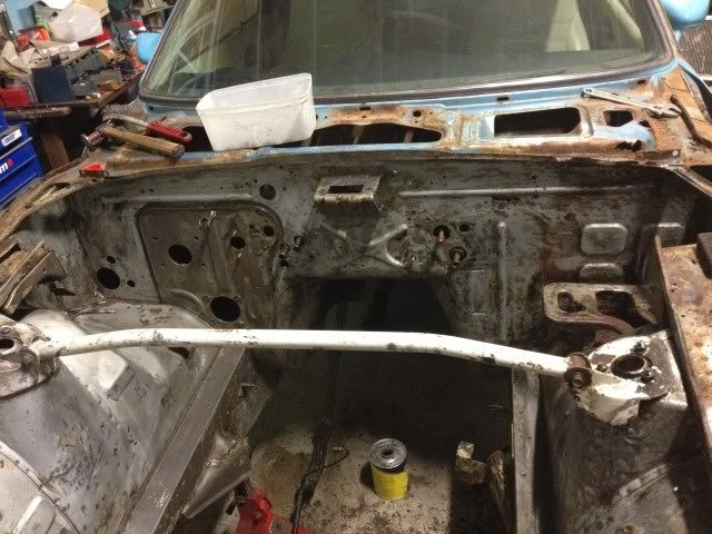

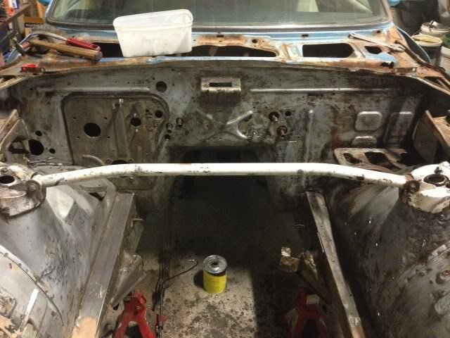

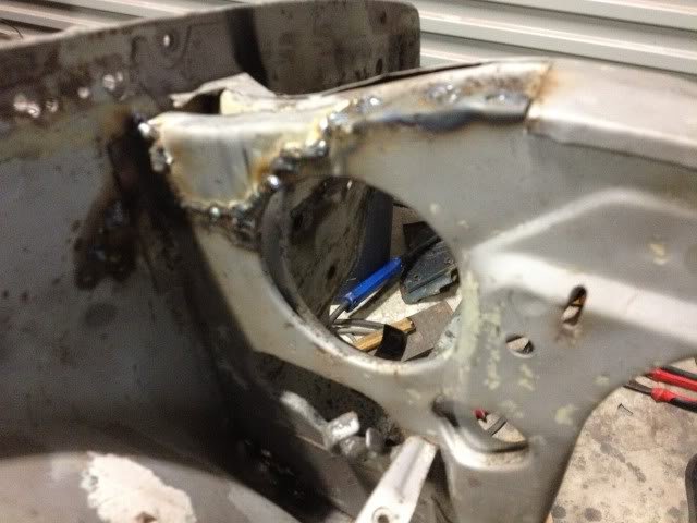

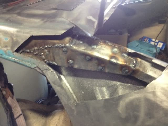

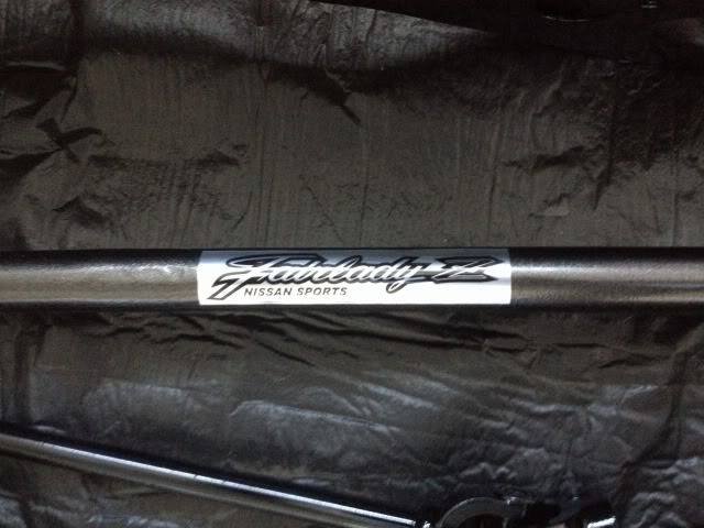

Now probably wondering why did i fit a strut brace. Well because of this

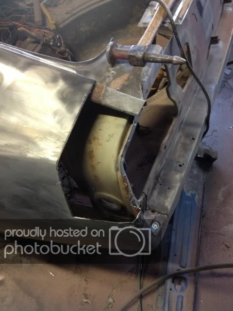

To fit the carbs the idiot installing it instead of extendg the manifold by 2" decided to bash the tower and skirt to fit. Fudging bush mechanics.
As i was planing hammering the daylight out of it wanted to secure the tower so no risk of bending it. Wasnt bent as strut brace fitted straight on.

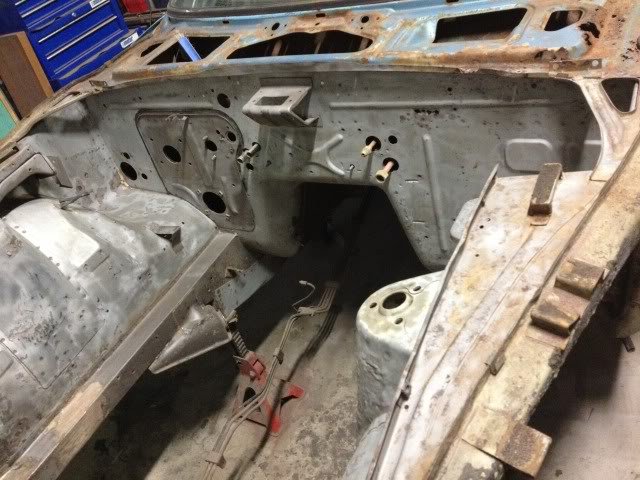

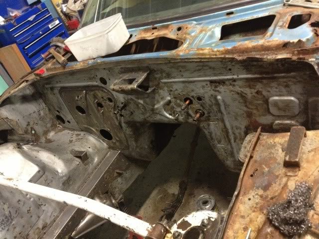

Lot better now. Also striped the paint to metal in whole engine bay. Still few spots but ran out of paint stripper.
Tonight finish the paint stripping, finilise the hammering and do some welding of extra holes the dodgy previous owners put on.

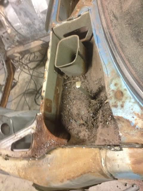

I ended up blasting the engine bay after all.
Sand.......bloody sand everywhere. I knew was going to be messy inside workshop but had no other option.Weather here is crap so outdoor blasting was no option. Bit dusty inside but oh well.

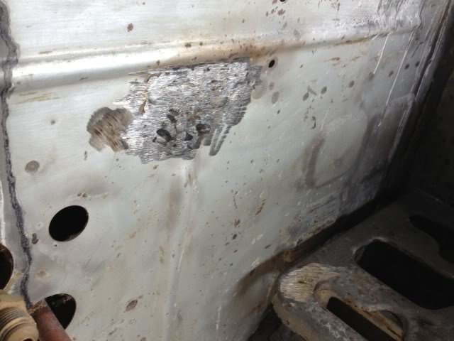

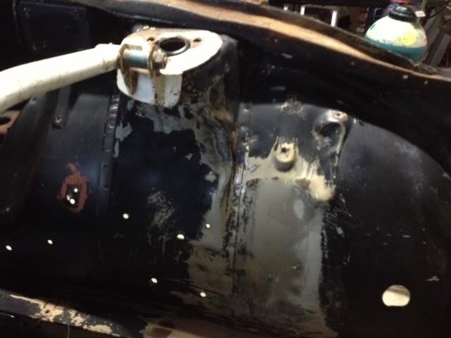

Than rusty bits removal.
After vacuuming the air box of 36years of crap
Than attacking it with renex as blasting was not an option at 9pm turning the air comp on.hammering was probably annoying enough for them.
Still bit to go to remove every tracy of black or brown crap if not it will eventualy come back to haunt. But at 10:30pm age got the better of me.

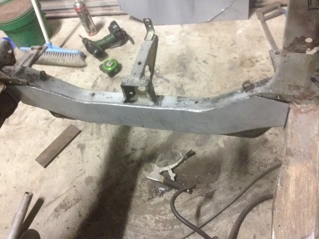

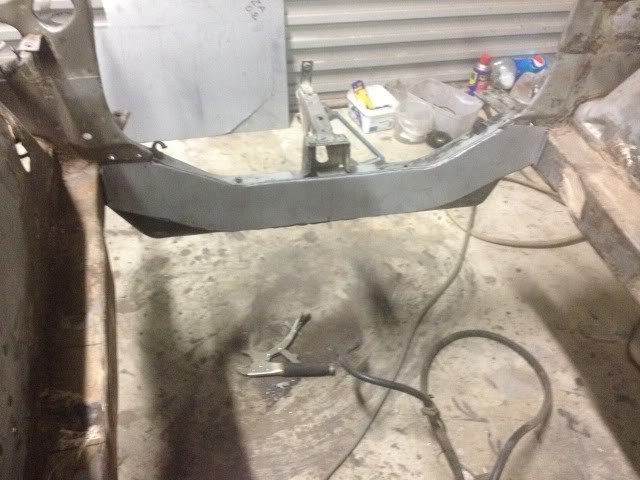

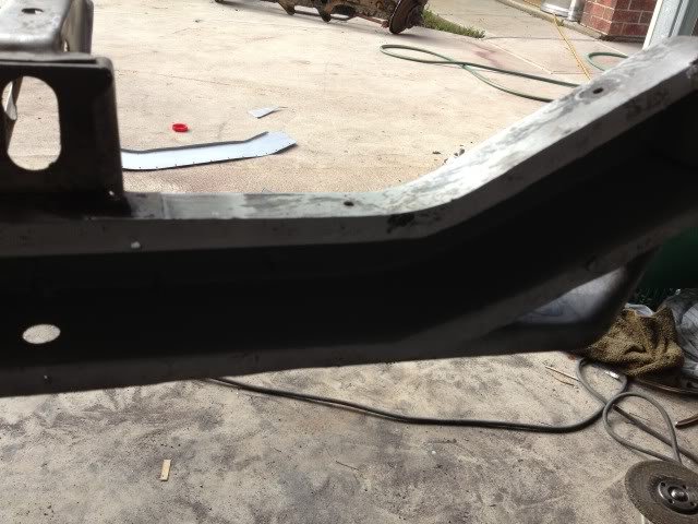

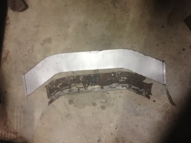

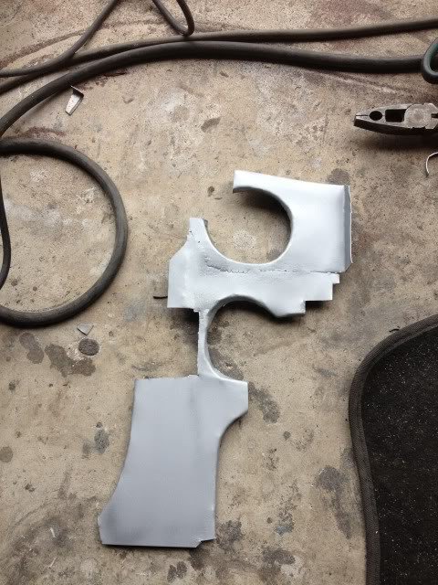

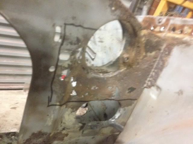

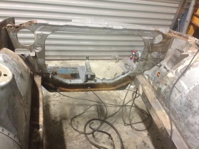

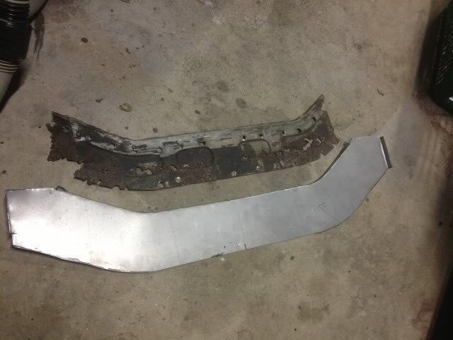

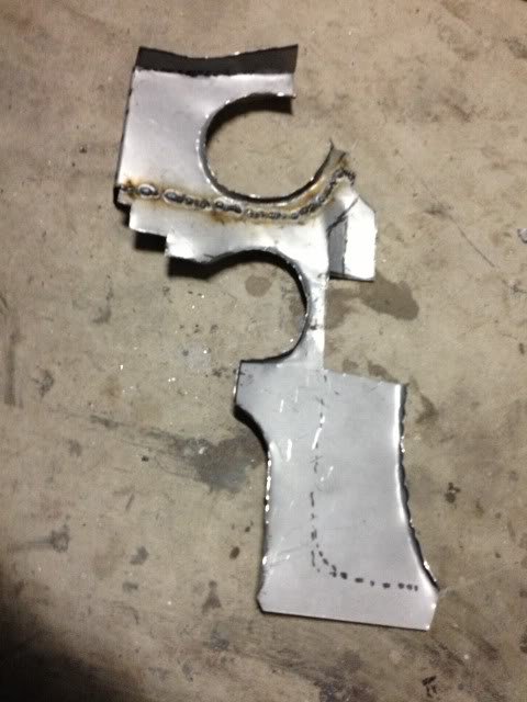

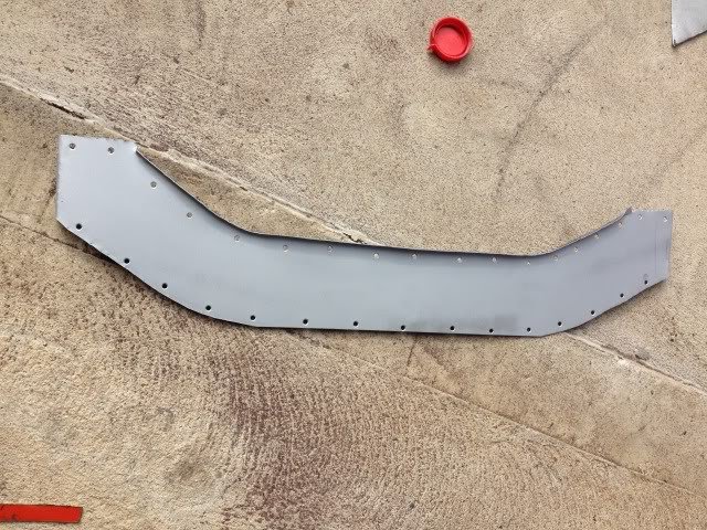

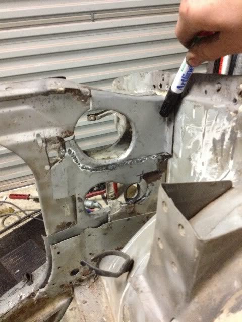

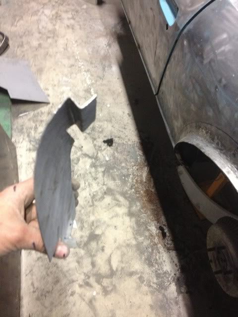

But still managed to fabricate the inner lower radiator panel.
Still few more final touches to do and preping the outer panel before welding can start.

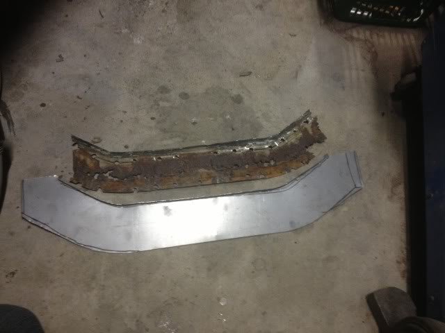

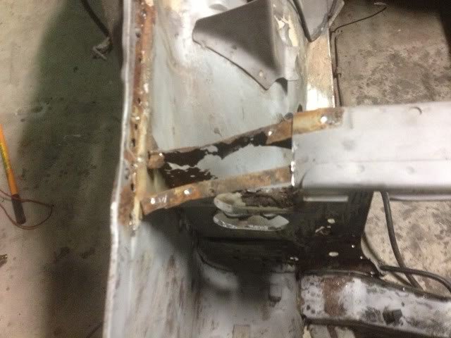

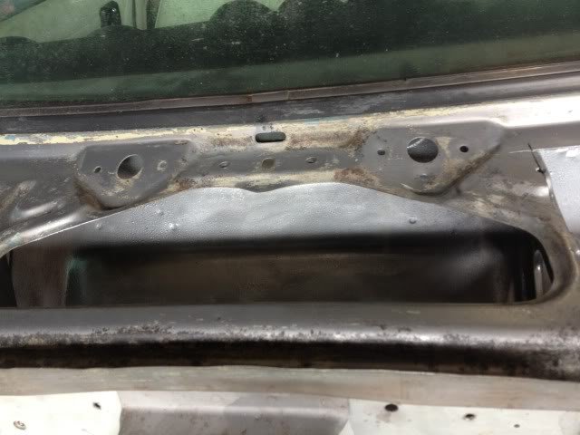

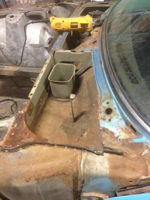

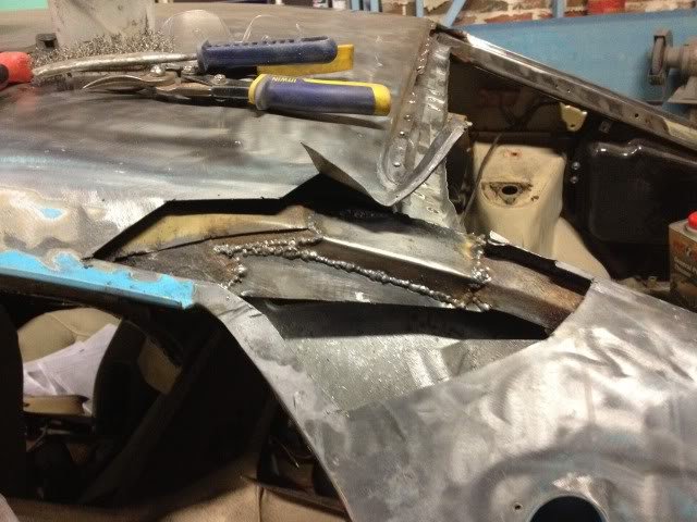

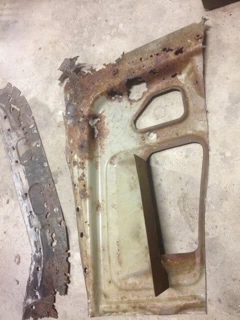

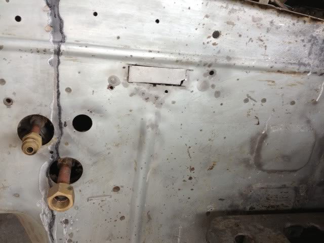

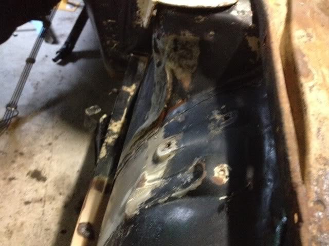

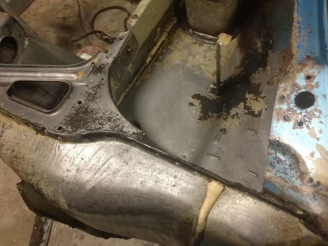

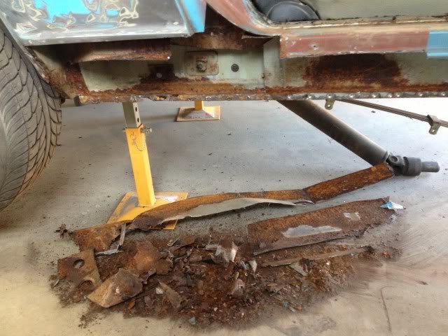

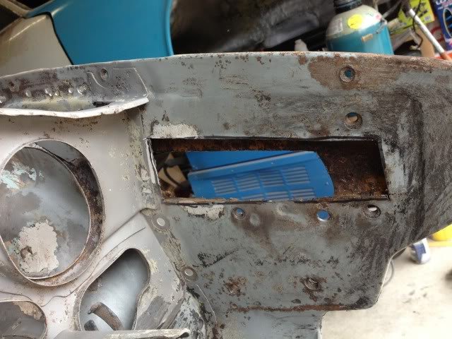

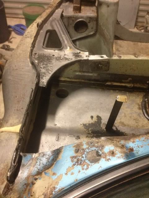

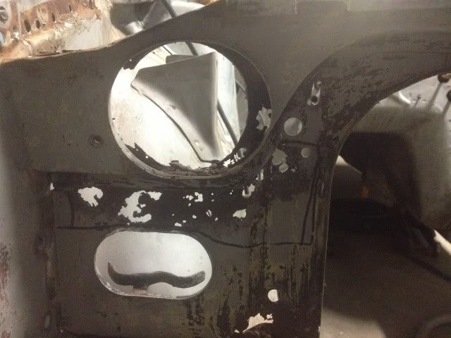

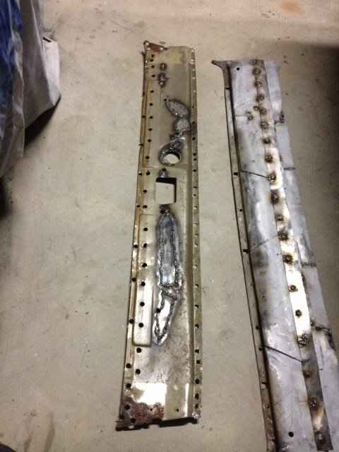

More rusty bits cut out.

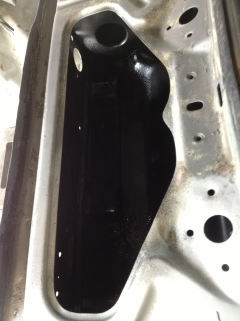

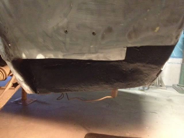

Now who ever has compliance plate fitted in this location 99% it will have a rust hole behind it. As this position damages the inner seal and will cause corrosion. I moved to upper position as per my 76 model so no future rust causing possible.

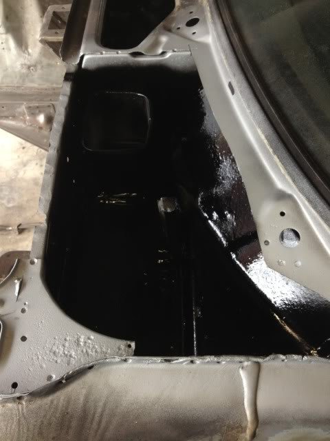

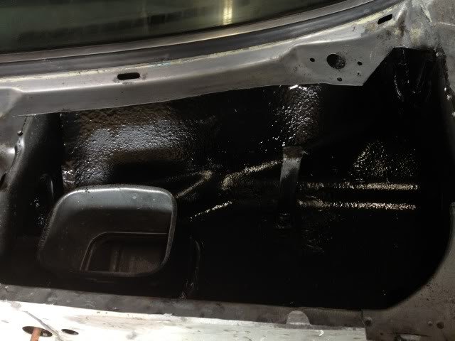

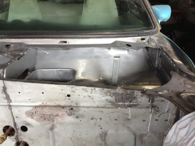

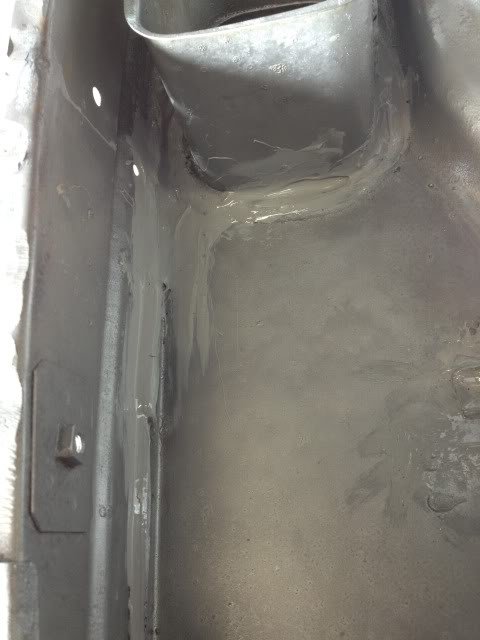

Air box all cleaned and treated.
Re-seled and improved further so no chance of rust re appearing.

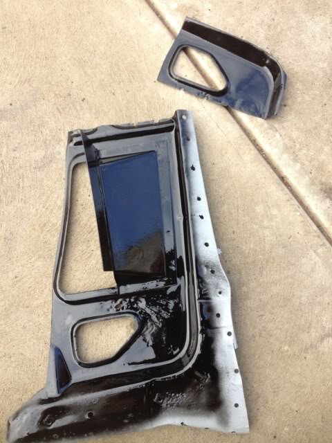

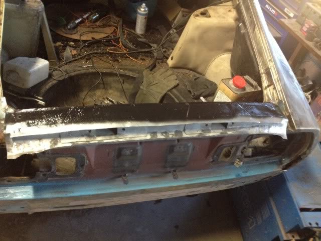

Than entire area body shutz tar type and anticorrosive not water based.
Replacement parts weld thru primed and enamel painted.
Than welded back

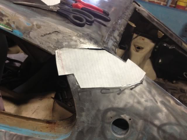

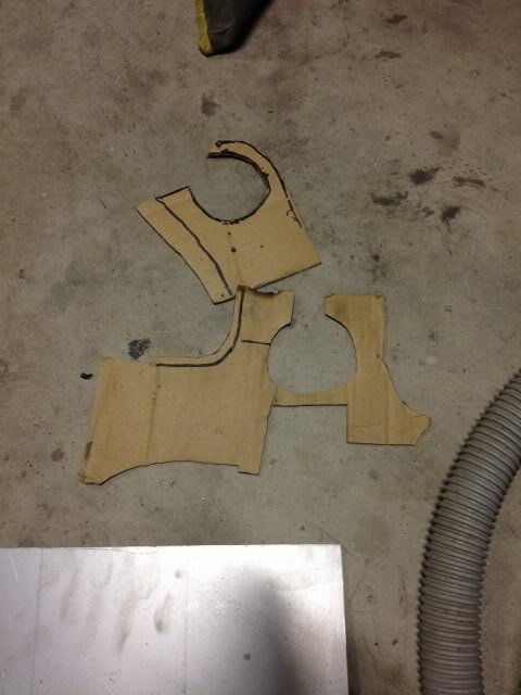

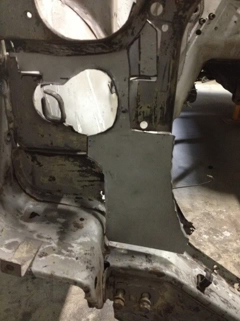

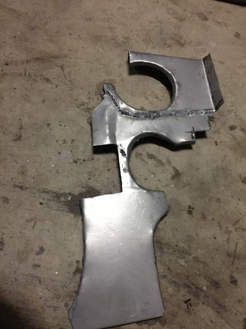

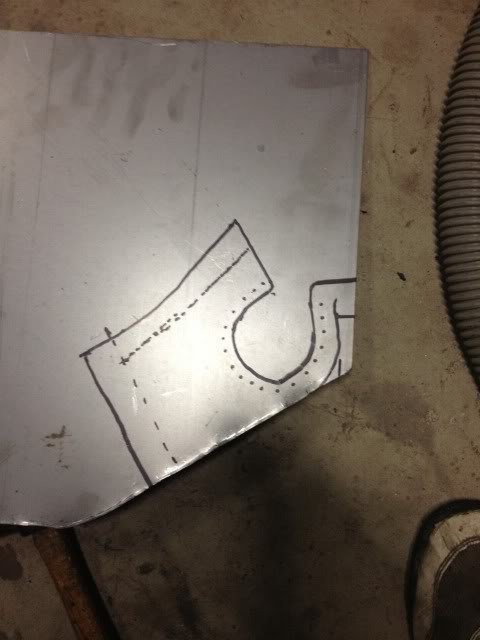

Than bit of carboard as stencil for the difficult shaped parts
Few trial fits and adjustments.
Purist will notice the bigger hole. Well for future improvments intercooler piping will go through there.

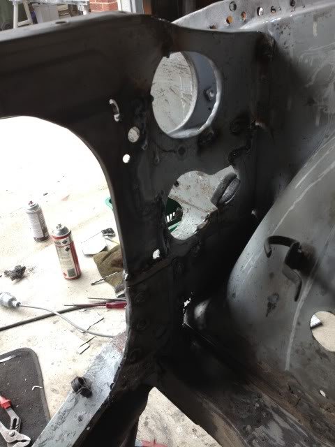

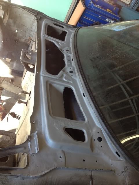

Welding few new bits in
Final adjustments and weld through primer

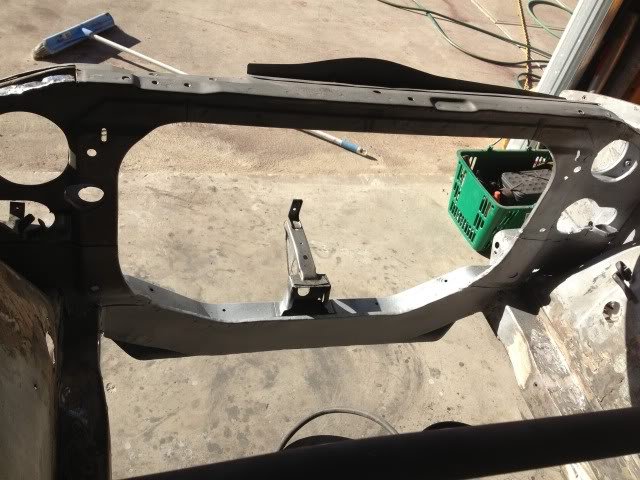

All welded in fairly happy with end result.

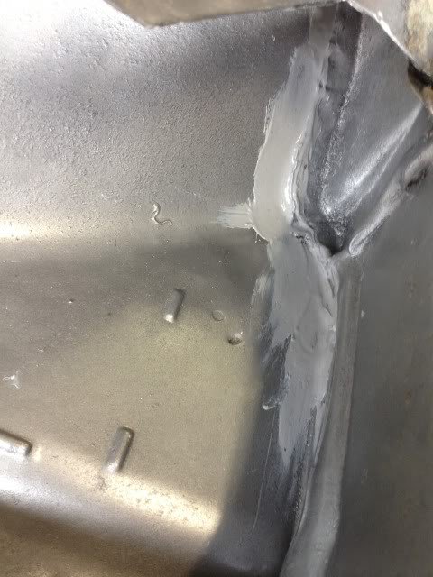

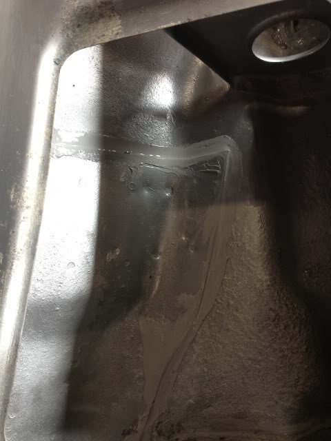

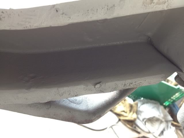

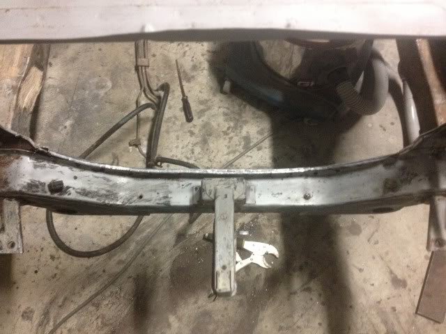

Now lower rad support same treatment as air box with few extra draining holes.
And final pic all weld ground and etch primed. Will coat entire rad support with body shutz. This will be daily so rain proofing it as much as possible and improving where nissan skimped out.
Still to do few small section on rad support an refit the reinforcments. Than sand and get it ready for paint.

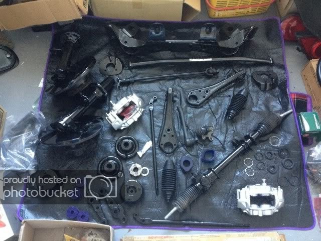

Few pic updates. Been working hard.

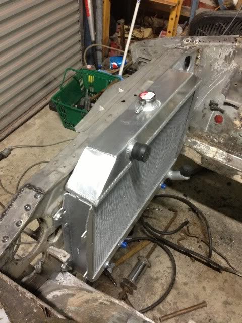

New radiator very surprised by quality for the price i paid. Damn chunky.

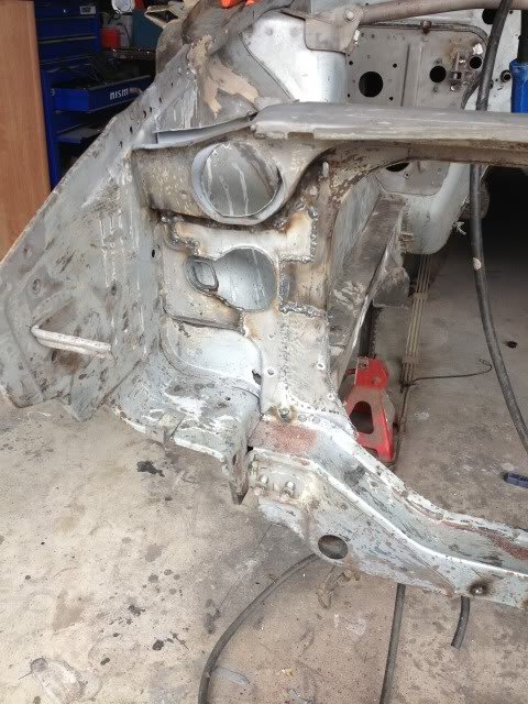

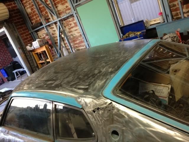

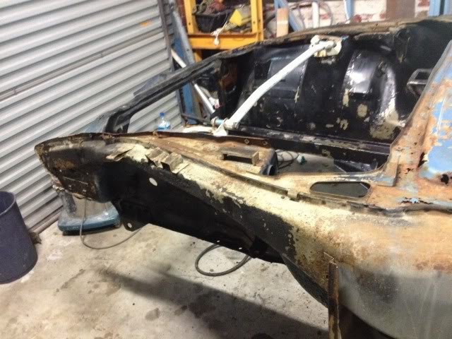

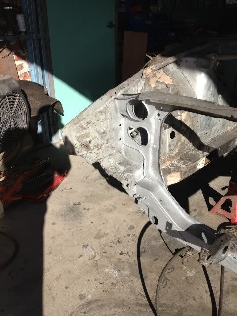

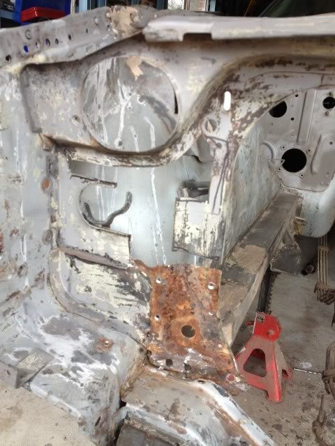

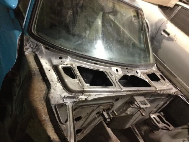

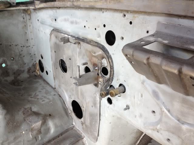

Engine bay 99% metal work done.

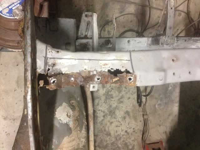

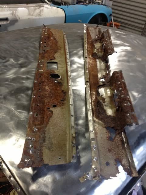

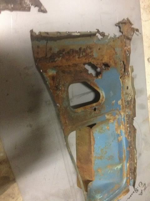

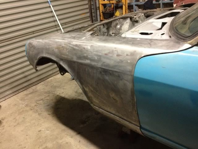

Than removing the paint from the panels and cutting rust out.
The last one was nasty she had a bit of water in the right seal. Lucky i kept the seals from my 2+2 parts car so shouldnt be to hard to fix.

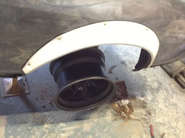

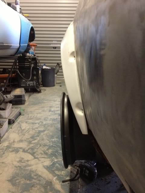

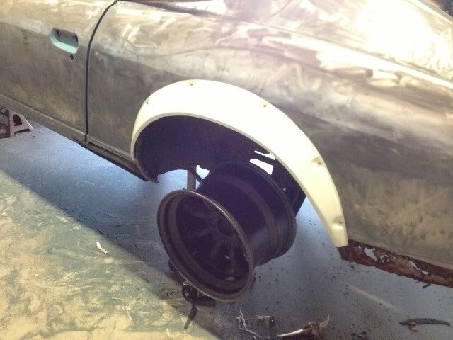

Oh than decided to fit the rear flares for first time. Quite easy job actualy thought it be harder. Left side the cut out wasnt as neat as right but first time takes longer and not always ideal but second one took 20min to do and looks lot neater.

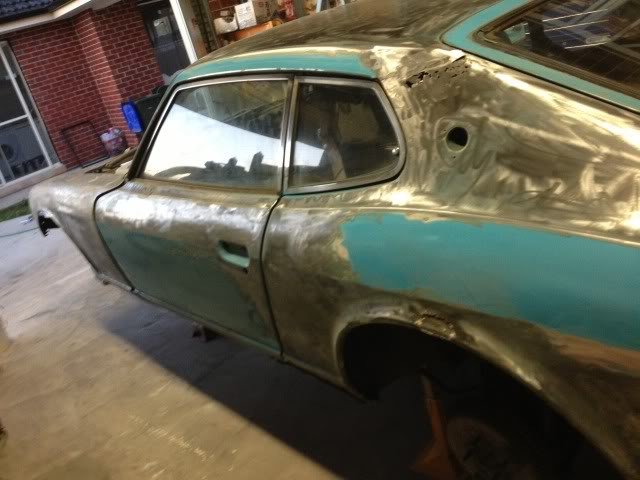

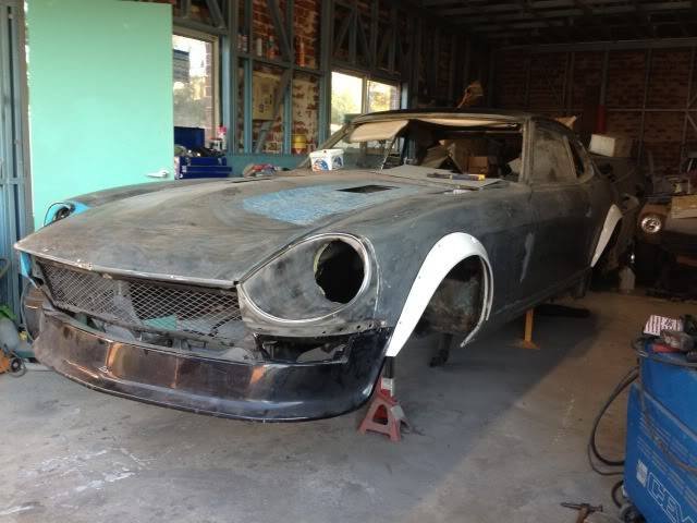

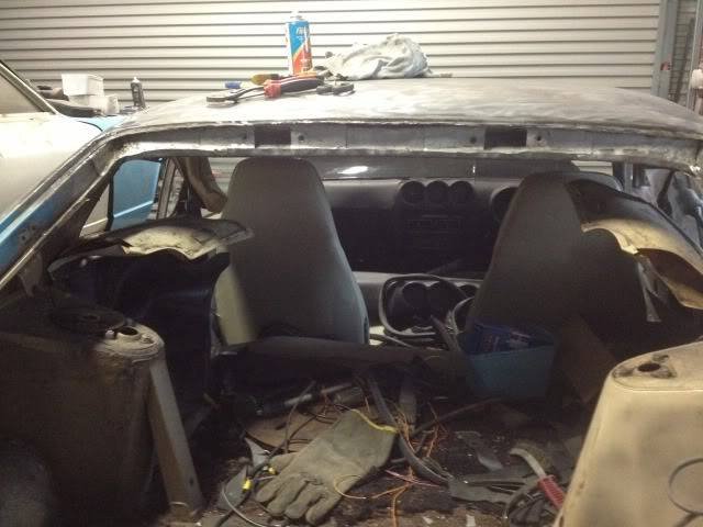

Ok i have been busy almost any spare time is spent in workshop. My Fairlady gets more attention these days that my lady is getting a bit jelous.  :-[
Anyway i get the pics do the talking. Lets just say lots of fabrication work and few surprises slows me down.

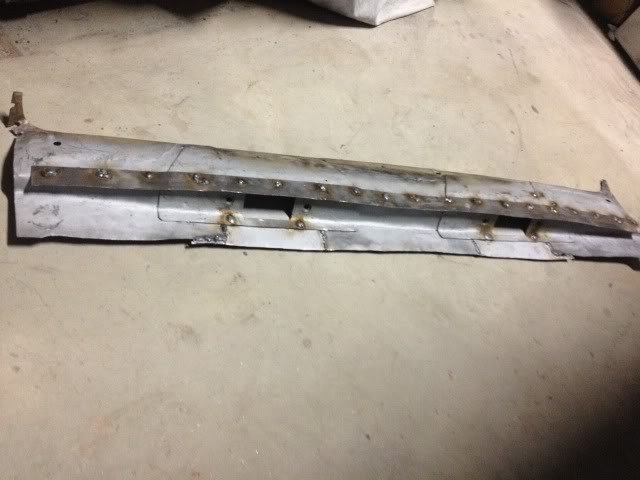

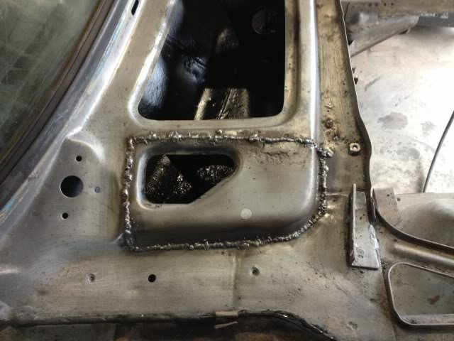

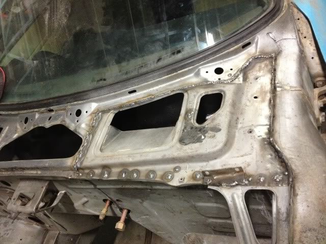

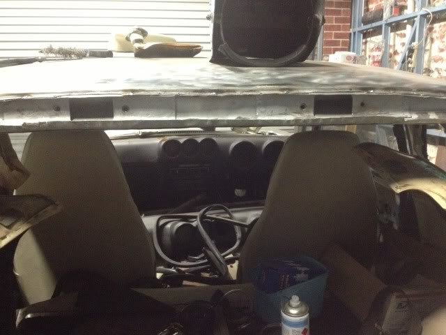

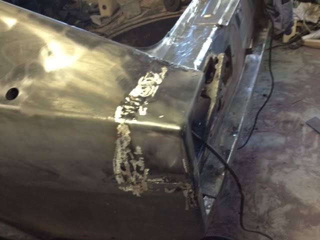

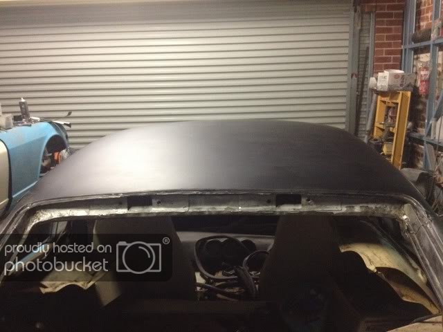

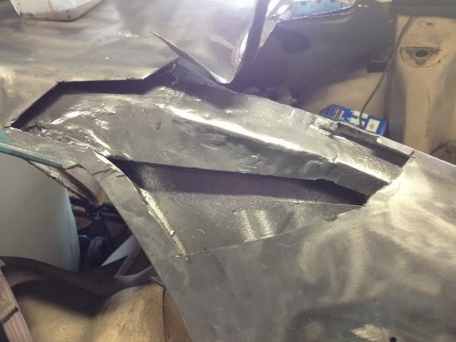

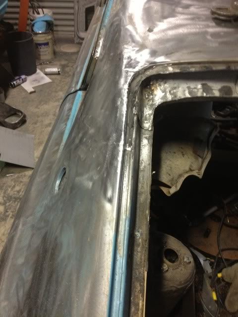

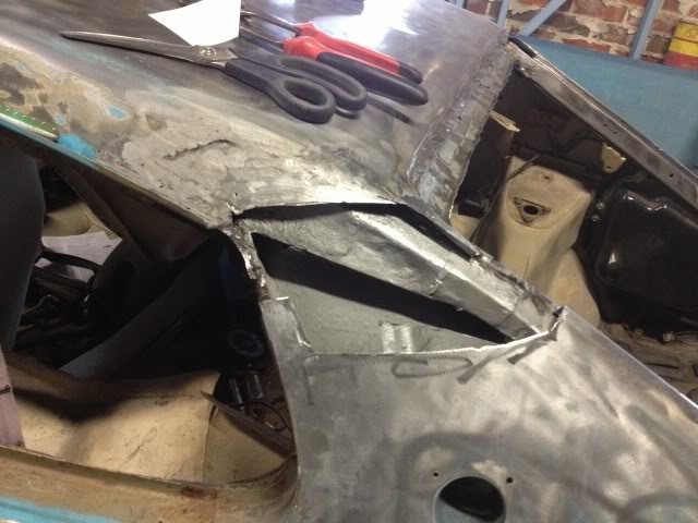

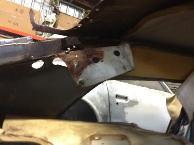

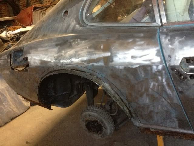

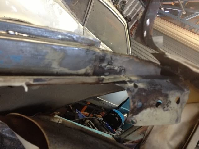

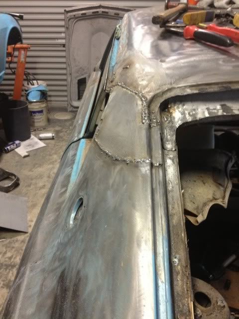

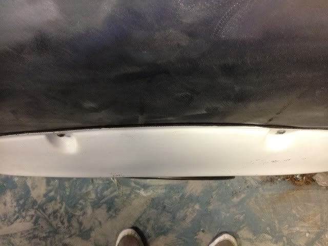

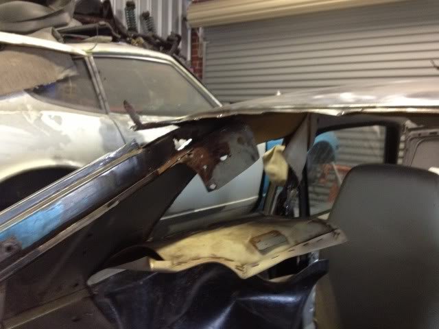

This what was left of hatch hinge area. Nasty

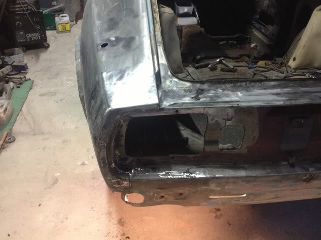

New fabricated hatch mount and b pillar repair.

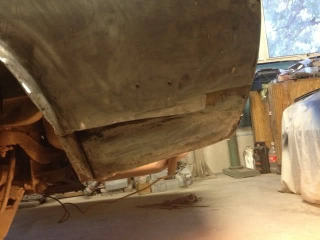

Than left 1/4 panel and slam panel repair

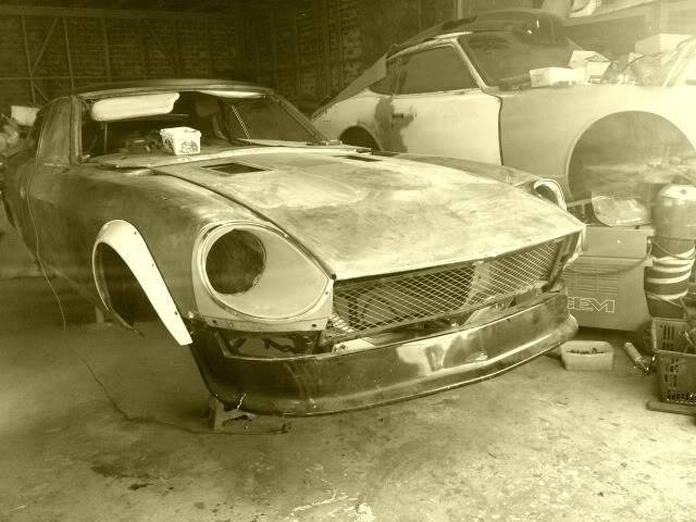

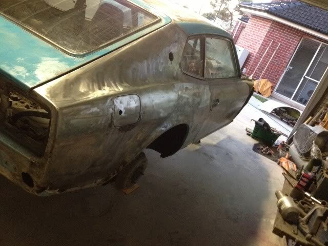

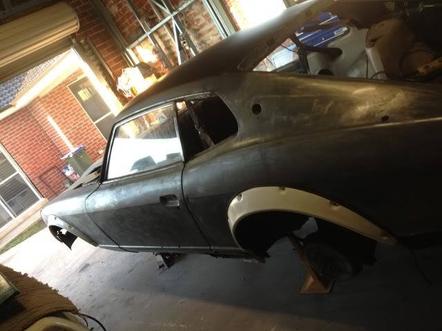

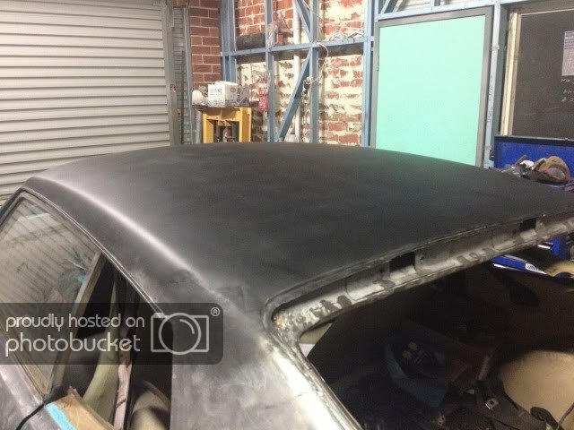

Also fitted front flares so i can start shaping the front guards.
And i thought it look cool like this.

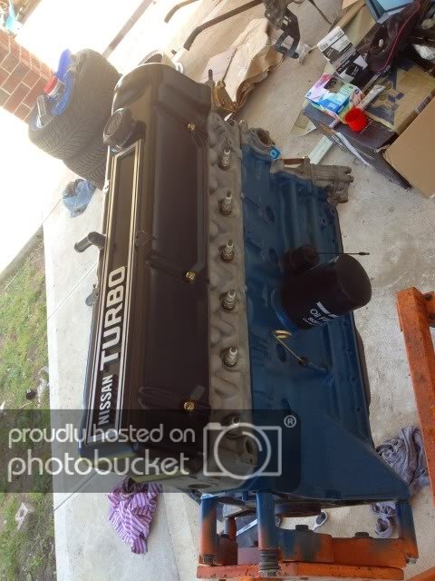

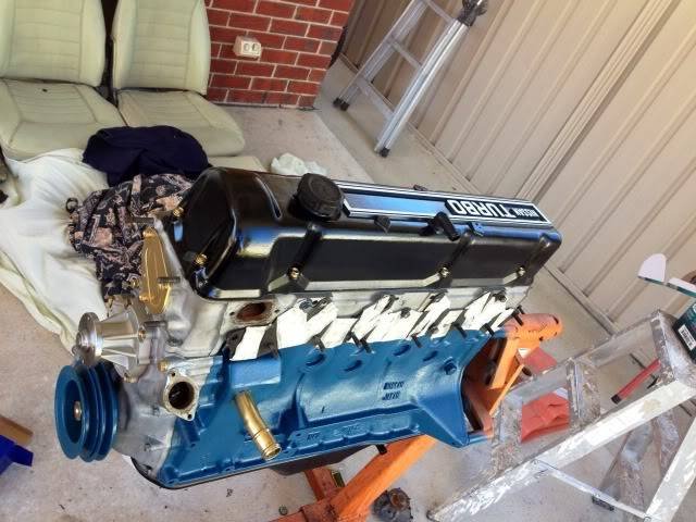

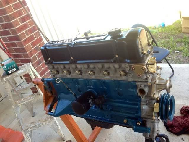

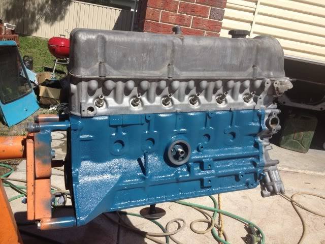

In times when i couldn't use grinder and hammer i did some quiet engine prep.
Still lot to do but keep chipping at it.

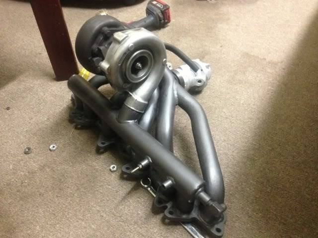

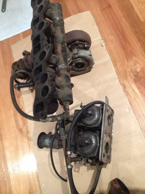

Oh the old turbo and carb has been sold and gone to Melbourne.
20hrs later after i droped it at ego depo i get a sms from the new owner saying
"Few hrs of cleaning" and this photo
Kudos to new owner awesome work.
He was over the moon when he recieved it 12hrs after i posted and started work on it. Also he was very happy with condition of it. Only pitty it aint going on a z but a patrol. Will be one cool 4x4.
As always great work mate, love the Fairlady mesh grille, this is going to turn out great I'm sure. Are you still going to have the turbo L-series or is just a valve cover now?
Did you buy new bolts or have the old ones zinc plated etc.?
Gav still be turbo but efi and bigger turbo than stock.
Got few unique bits but will show once bolted up to engine.
That be first stage.
Second stage pending funds and how actualy the l28 runs. If im happy with power it will stay, if not it get an rb.

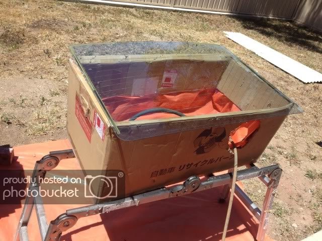

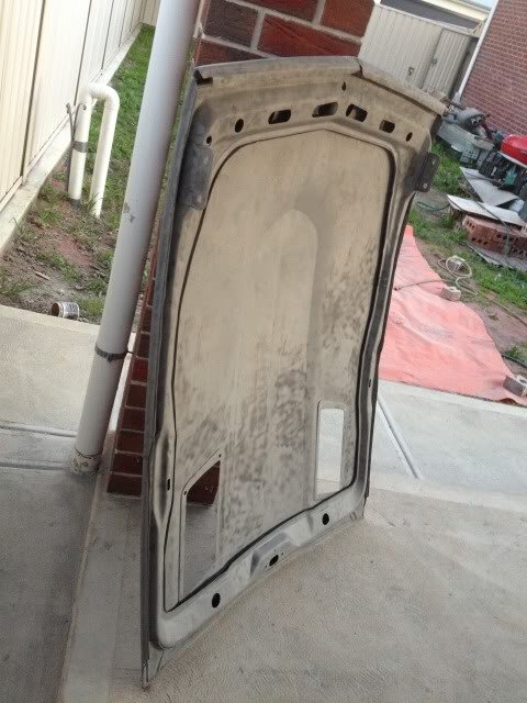

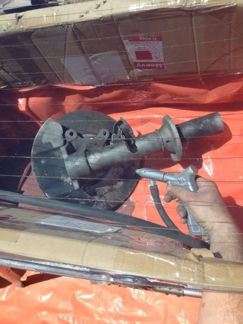

anyway few pics and my blasting booth that take no room and not limited to size. and cost less than $10  ;D
here it is the list of bits you need.
1x appropriate sized cardboard  box Free from Bunnings
1x Rear hatch glass from 2+2 (got 5 sitting around so if u need one let me know for blasting cabinet)
1x reasonably tough plastic ( i got a roll leftover from my house build the stuff they use on foundations)
1X roll of tape or duck tape ($2-5 bunnings)
1x multi-fold ladder ( i had this but comes in handy for house work and temporarywork bench area so good to have one around regardless , from $30 Sh or new 150+)
1x sand blaster gun from total tools $20
5min of time to knock something up like this
works well. Put  the grit on one side of the box. lift the opposite side so it has a run toward the bottom corner. poke the suction hose from blasting gun through lid of the box so its fixed. as you work the excess grit automatically goes to one side and gets sucked in again and reused. So no stopping cleaning filtering = time wasting. blasting process is slow unless u have industrial blaster. but the baby ones wont warp damage metal as just does not have that much grunt.
The large glass area give u good view of what you doing without using goggles that fog up.
also u reduce waste of reasonably expensive media. once finished lift the plastic liner run it through filter ie fly screen folded few times and put it in abucket for use next time. glass stashed side of the shed gun in your tools area and bulky box into recyling bin.
need bigger box for doors bonnets fridge boxes are good. so go to harvey's or like and ask if they have a large box you can have.
obviously you need a compressor. well you stuffed if you don't have a reasonable one.
nothing get rid of rust better than blasting.. though would use it on items painted several hundred times and massive layer build up. remove most by wire brush or paint stripper and finish off with blaster.

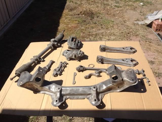

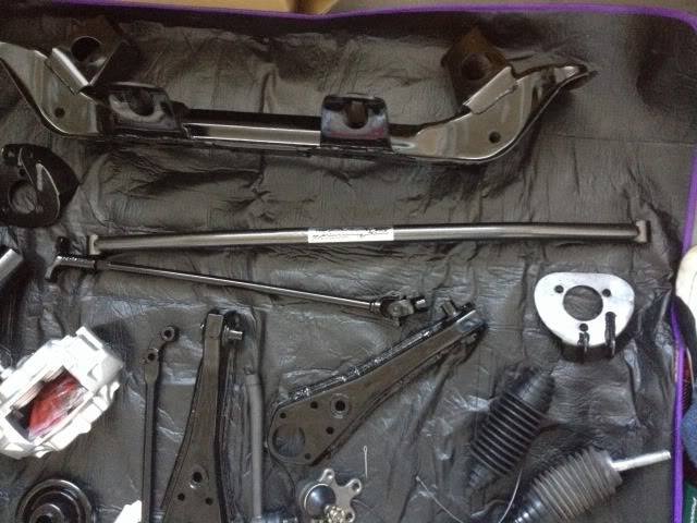

anyway few blasted items
and those items painted and ready for assembly when i get time.

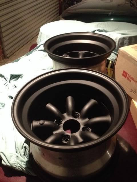

oh and these have been etched primed and awaiting new coat of Watanabe Gray/Brown
