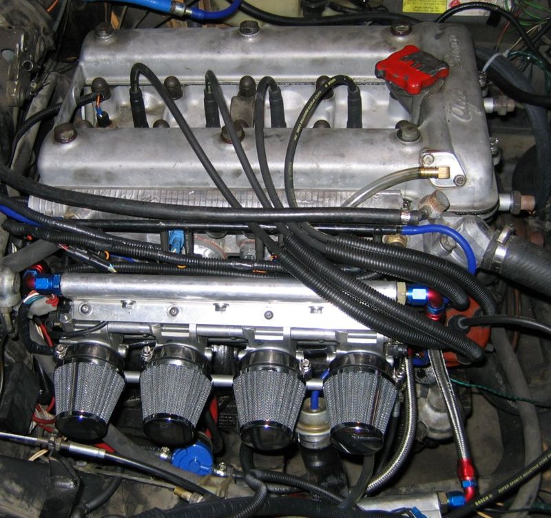

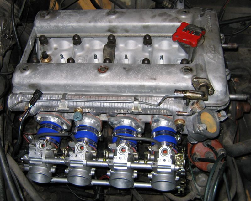

Zeddophile Posted January 21, 2008 Posted January 21, 2008 Just another take on the ITBs - a snap of mine on my Alfa, taking the cheap option (read: I've probably spent at most half the $ of what Zedman240 has on his, but a lot of hours). Using Suzuki GSX-r 750 throttle bodies and a Megasquirt ecu. Can't beat that sound. Quote

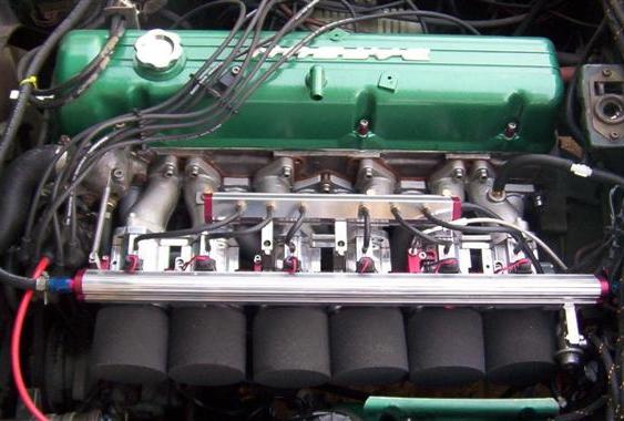

Hunter Posted July 11, 2008 Posted July 11, 2008 HERE ARE PICS OF THE L28 set-up.....off the website.... LOOKS VERY NEAT.. I have one question how does the engine know what airflow it is getting with this set-up? I am guessing it has something to do with the (vacum line??) manifold connected Here are the specs i found for this set-up on the website. Engine: 2.8l, stock internals, 3" mandrel bent exhaust ITBs: 6 45mm Extrudabody Individual throttle bodies with a Weber DCOE-style intake manifold ECU: Injection Logic, closed loop, electronic ignition Mileage: Over 25mpg in over 25,000 miles of testing on Extrudabody ITBs Estimated Horsepower: ~145 at the wheels Status: Project Complete. Full specs can be found here: http://www.extrudabody.com/TechInfo/what_you_need.html This is the video http://www.youtube.com/watch?v=ZOobACoLiL0 Quote
Hunter Posted July 11, 2008 Posted July 11, 2008 I wrote them a letter asking how much etc. This was the reply. Andrew: About $1600 includes everything from the Filters to the Head minus Injectors, it includes the Jack Shaft Linkage system, and a Manifold I have here on hand, it's a Mikuni Short Runner Manifold that has been set-up for Show Purposes, and looks Trick! Needs to be ported on the head side to get the most Flow out of the manifold/ITB's. Your Stock ECU really needs to be replaced with a Mega Squirt or Other Aftermarket ECU, the stock MAF system is pretty restrictive and not a good match for ITB's! The MS ECU will allow Alpha-N/MAP blend, where below 1200rpm the ECU ignores the MAP sensor, and delivers fuel based on TPS position. Once above 1200rpm it looks at TPS and MAP sensor to deliver the needed Fuel requirements! The Multiple Vacuum Pulses from each ITB will often cause the ECU to chase itself as the Map Sensor fluctuates from the 6 Vacuum Pulses! We only have the 1 manifold on hand. If you have a Weber Based manifold already, subtract $250 from the Above Price for a Total before Shipping! Hope this Helps, and thanks for your interest in Extrudabody! Just let me know if we can help you! Kevin Quote
Moderators Zedman240® Posted July 12, 2008 Moderators Posted July 12, 2008 HERE ARE PICS OF THE L28 set-up.....off the website.... LOOKS VERY NEAT.. I have one question how does the engine know what airflow it is getting with this set-up? I am guessing it has something to do with the (vacum line??) manifold connected Here are the specs i found for this set-up on the website. Full specs can be found here: http://www.extrudabody.com/TechInfo/what_you_need.html This is the video http://www.youtube.com/watch?v=ZOobACoLiL0 The ECU works out load by throttle position versus RPM. So if your throttle position is 90% and RPM is about 2500, it knows you're hard on the gas and need more fuel! That's the advantage of the ITB's, get rid of that restrictive air flow meter! Rather than measuring the air going into the engine, it works it out by seeing what the other sensors can tell it (the ECU). Hope that helps! Quote
