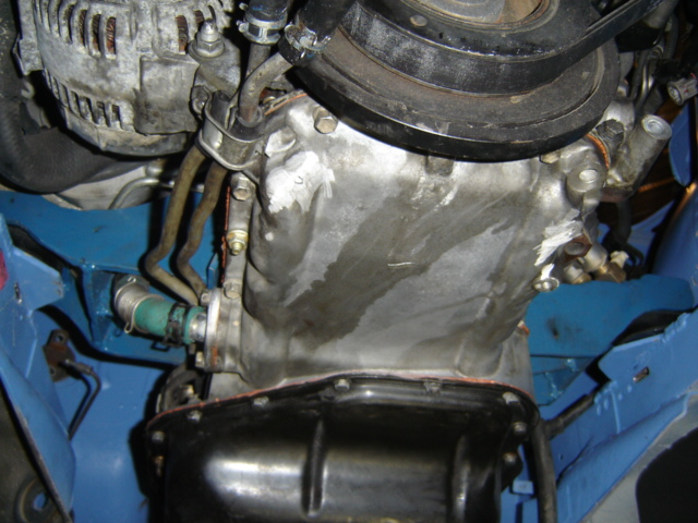

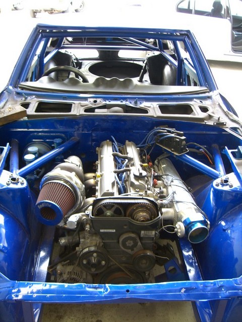

RUSSJZ-ZED Posted November 14, 2006 Posted November 14, 2006 A 2j will fit but it's 14.5 mm higher than a 1J,can have be a tight fit under bonnet.You can probably get a bit lower than mine, but then power steer could be a problem fitting. very tight around the twin turbo's as well, but unless you are planning on non road use,a 2JZ is huge overkill .The 1j engine in standard form has more power and torque than an RB26,later design,much stronger,And you don't have to shag around getting rid if the 4wd. It is only now that the Yanks have started to realise how good this series is. Japanese have been on it for years,The only reason it's not to the fore is it has always been put into heavy (and ugly cars) Also Brock/Richards winning Bathurst really helped the RB26 along here. I went for the later Vvt single turbo, more clearance in turbo area ( more power than Soarer/Mk3 Supra 1J engine, also max torque378Nms is at 2400RPM the 2jz is 430Nms at 3600rpm all these engines have the max Jap horsepower rating 0f 206Kws, I suspect the Supra for one has at least another 100Kw. I an actually stepping down the diffs from tyre shredding grunt 3.7/1 to 3.37/1, better cruiser, and still spins wheels in 3rd when I'm not trying.Even with this diff, very scary in the wet. wet = any dampness. As pointed out above, my engine mounts are off the rails about 6 inches behind the strut towers, which will be helping the balance 53%front /47%rear.It is a heavy engine ,1290Kg all up,10 litres fuel,no driver,aircon not fitted yet. There is no problem with steering clearance even with standard steering rack (turning it could be a problem,with that weight which is why I went power steer).Handling with power is magic. The engine and gearbox mounts have to fabricated,no drama there, update your tacho/speedo to electronic(I have just put up a post on how to set these up on www.zgarage.com )-could be an"au" after that.Using my other alias Splatt. Due to engineering in NSW not allowing aftermarket engine management(if you can alter the fuel/air, you can alter the emisions,not allowed-later perhaps?..)I am running a 4 speed auto, I have a R154 manual set up ready to go, Toyota runs engine and transmission through the same ECU -different one for manual. Auto was originallt temporary, I didn't think it would happen, but I really like the auto, it will be staying till it breaks. The only hard part of the swap is the wire up, If it wasn't for a genius called Sideshow(Jim) I would probably still be scratching my head.-Reasonable priced and he will travel- if you pay. TT 1Js are easierto wire. He had done 30 plus 1Js, but not a Vvt, He figured there would be more of them in the future so mine was a test.The Vvt runs a completely different ECU to any other 1J/2J also tranny big different. WARNING! whatever you buy,Toyota/Nissan ,GET A HALFCUT, If you buy just an engine/trans , it will cost a fortune for all the bits you are going to need, and won't get with an engine. Always get the map/airflow, harness and ECU particually on a VVt, completely different to any other 1J/2J that Toyota made. Just buying an engine is for when you are allready set up and need another one. You will need a rear sump to clear crossmember, 1J/2J/ came with 3 types(all interchangeable)front,middle and rear I have not seen a middle one, but rear clears easy, If you are "unlucky"enough to get a front sump(Chaser)these are in big demand for Cressida conversions ,$300 on toymods and they will kill for one, the rear type that you need are common,$70-$100 At the moment I'm planning on removing $2000 from Mr Howard to install a Gas Research system, I've used their stuff twice before and love it, engine perfectly set up for their carb. My typing finger(singular) has frozen up, anything you want to know, ask. If close to Sydney drop in. Quote
