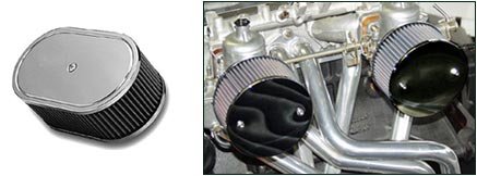

I'm interested in the airbox idea but I'm not sure if its worth the hassle. I could have the K&N filters for normal use and if I'm going to a show I could bolt on some of the weber air horns.

Is there any type of air filter that doesn't hide the ram tubes? The ITG one doesn't quite gel with the highly polished look I'm going for in my engine bay. I'm thinking maybe the K&N? Anyone have any ideas? Edit: So Shaun just pointed out that the ram tubes are for race and show. I think I'm probably not going to replace the horns in a hurry and get K&N filters.

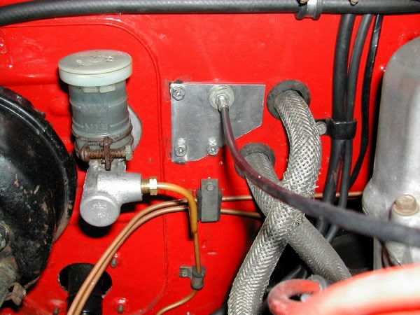

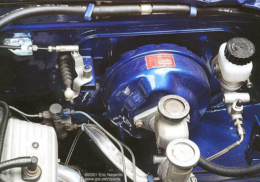

I'm not sure if it was you posting about this previously, but have you seen pics these before? I was researching cable accelerator linkages too.
