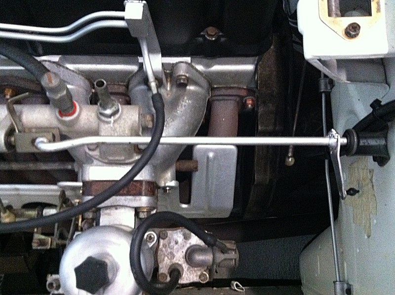

I decided to look at the fuel aspect of this since I wasn't getting anywhere with electrics. Before checking fuel pressure, wanted to see if fuel was getting into the carbs when accel pressed. Took off the zip-tied filters and tried one - it sprayed. Silly me didn't check all of them, but will have to do that next time. I put some carby cleaner down them and had another go at starting - worked! Voltage at battery when running was 14V
