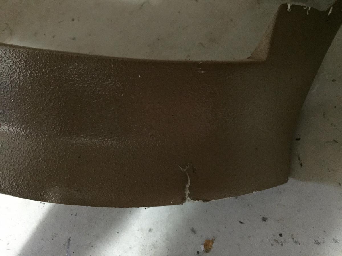

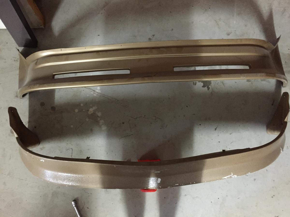

There is a few splits in the metal as a result of the impact, so I decided to oxy weld them up and patch them.
But after talking with my teacher at Tafe he said I should probably fabricate the lower edge where it's most damaged and weld it in.
So I started with a paper template (using the good side as a guide and will flip and reverse for the right hand side) and have started to make a section (not photographed).
Thing is, it's going to take quite a bit of work to get this bonnet up to standard. So I am actually contemplating sourcing another.
Anyone got a spare bonnet? Or got a bonnet that has a good lower right hand side? Can be vented or non vented..
More repair work last night at Tafe, bit of a tricky piece to make, has a curve in multiple directions and getting the sharp bonnet edge requires quite a bit of finesse.
