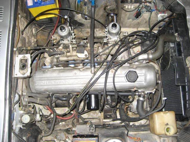

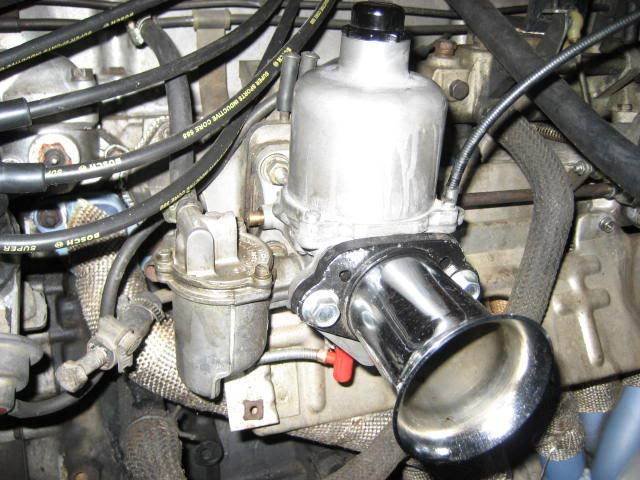

ZD44TT Posted July 2, 2007 Author Posted July 2, 2007 can anyone tell from these pics if I'm missing a mechanical fuel pump Quote
warrenz Posted July 2, 2007 Posted July 2, 2007 There is no mechanical fuel pump on your engine, the 260 had electric pump as standard. The 240 fuel pump sits at the front of the engine on the right hand side. You can measure the float setting and adjust them but people I spoke to said just buy new ones from Nissan. I agree the float is the most likely problem but maybe you should check you fuel filter, is it letting enough fuel through, how long since you changed it ? Are the back 3 plugs the same colour as the front 3 plugs, maybe you can narrow the fuel problem down to one carby. Maybe too late for this check as you have probably done a fair bit of flat running on the way home. Warren Quote

Hunter Posted September 21, 2008 Posted September 21, 2008 There is no mechanical fuel pump on your engine, the 260 had electric pump as standard. The 240 fuel pump sits at the front of the engine on the right hand side. You can measure the float setting and adjust them but people I spoke to said just buy new ones from Nissan. I agree the float is the most likely problem but maybe you should check you fuel filter, is it letting enough fuel through, how long since you changed it ? Are the back 3 plugs the same colour as the front 3 plugs, maybe you can narrow the fuel problem down to one carby. Maybe too late for this check as you have probably done a fair bit of flat running on the way home. Warren I know this is an old post but my 1974 260Z 2+2 has a mechanical fuel pump, stock standard. I think it was 1975 when our 260Z's may have changed. In my 1975 260Z 2+2 the seat belts have different mountings etc. I am guessing that one would have come with and electric fuel pump. Quote
