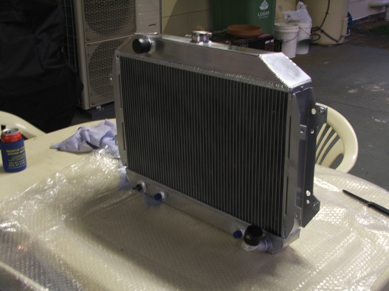

Mickl Posted July 15, 2013 Posted July 15, 2013 The radiator was a pretty good fit and the only thing needing to be done was to make the bolt holes in the cross member a little elongated....maybe an extra 2 or 3 mm extra was needed. The pipes for the gear oil are threaded so hydraulic type flared fittings now have to be sourced to refit the gear oil cooling. There is only 70mm clearance between the radiator and the clutch fan bolting plate so it is no longer possible to use the standard fan. I have bought twin 10 inch shrouded thermo fans which will fit very nicely to the inlet side of the radiator. I don't have air con so the fans will mount here fine. Next week`s job. I could mount them on the inside of the radiator and set up as a pull-fan as there is the 70mm space but outside as a push fan is easiest. The twin fans with mounts, electrics etc cost me about $92 over the net. Radiator was $157 delivered and much cheaper than a re-core. Maybe you could very lightly spray it black to hide the aluminium look? Send me a pm if you want the exact supplier`s addresses. Quote
sydney mike Posted July 15, 2013 Posted July 15, 2013 Hi Mickl, thanks for the pics and the confirmation that the stock fan will not fit. I want to go with the stock fan so I will go with the $500 re core cheers, Mike. Quote
Mickl Posted August 26, 2013 Posted August 26, 2013 The thread on the two pipes for the automatic trans fluid at the bottom of the radiator was metric (M 14x 1.5) rather than BSP and so it was very difficult to find appropriate fittings. Speedflow and others on the net didn`t seem to have anything which looked right but I finally tracked down two fittings at RYCO for $62.96 for the pair, which was a bit expensive but what can you do. Another complication with the tubes was the angle of the flare needed in the fitting (60 degrees) as there can be 4 different shapes. The ryco flared fittings parts number is 6680-0414 and it is called -414x1,5MET(JIS)F 60`CONCAVE for those who may follow this path Quote
