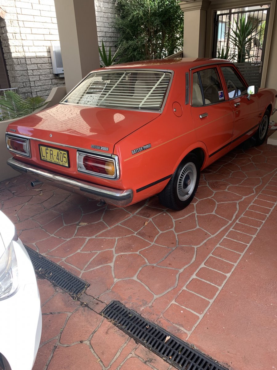

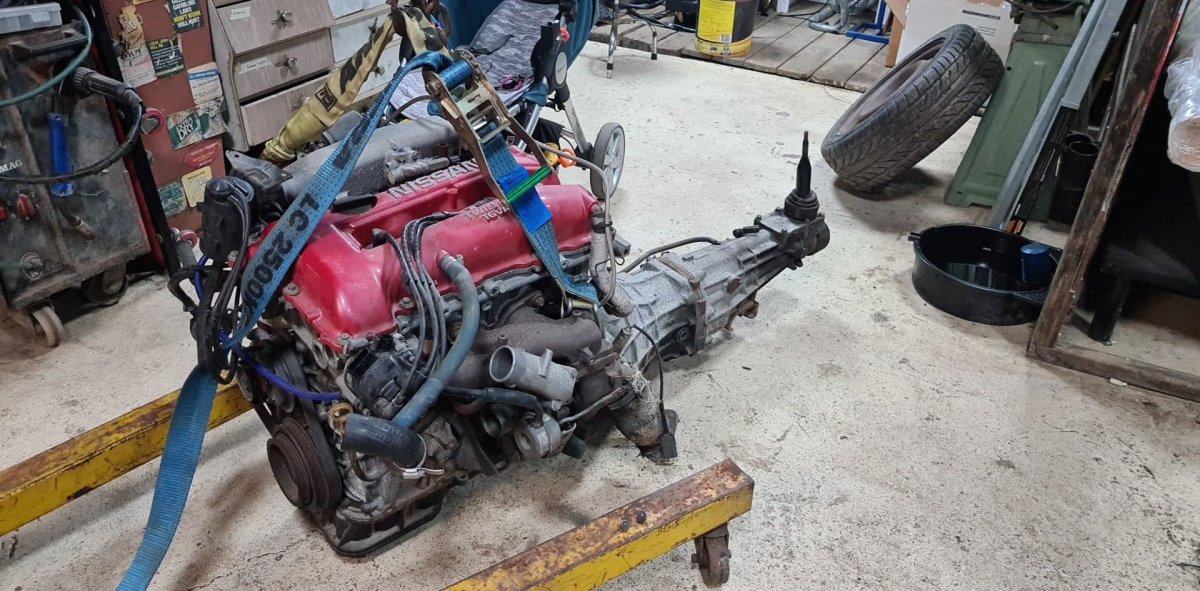

Shadz Posted June 11, 2020 Posted June 11, 2020 (edited) I’m starting a similar conversion in the next few weeks. Bought an 81 200B a couple of months ago and just managed to source a S13 SR20DET red top with a 5 speed gearbox that Was fitted into a Datsun 1200 Ute. Comes with intercooler, drive shaft ecu and wiring harness and exhaust. Edited June 11, 2020 by Shadz Spelling mistake Quote
