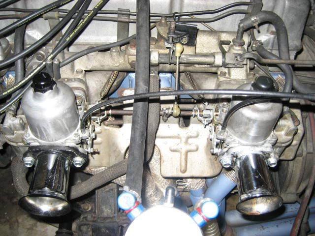

ZD44TT Posted March 14, 2007 Posted March 14, 2007 I think my cars idling too high around 1,000rpm.........should it be around 800rpm? Quote
zedevan Posted March 14, 2007 Posted March 14, 2007 the screw at the top centre in that pic, just to the right of the hose. i have my car idling a bit under 600rpm i think Quote
ZD44TT Posted March 14, 2007 Author Posted March 14, 2007 the screw at the top centre in that pic' date=' just to the right of the hose. i have my car idling a bit under 600rpm i think[/quote'] legend!! thanks.........your car rocks!! just did it.........purllls like a BEASTO!!! : )..............seems to like it around 800rpm. maybe thats worth 50km from a full tank.......have to wait n see. Quote

mossy Posted August 8, 2009 Posted August 8, 2009 Is this the only screw to adjust idle, my z idles about 1200rpm at the moment but backing off that screw won't do anything as its not touching the plate anyway. Quote

Moderators Zedman240® Posted August 8, 2009 Moderators Posted August 8, 2009 You may have to adjust the screws that adjust the butterfly in each carb; they are near the base where the carb bolts to the manifold. Its a small screw with a spring under it. But you will need a balancer as well as that screw adjusts the airflow through each carby. If you loosen them both equally, you may get away with it. Quote

mossy Posted August 8, 2009 Posted August 8, 2009 You may have to adjust the screws that adjust the butterfly in each carb; they are near the base where the carb bolts to the manifold. Its a small screw with a spring under it. But you will need a balancer as well as that screw adjusts the airflow through each carby. If you loosen them both equally, you may get away with it. Thanks, I think I'll duck down to DJM to get Daniel to quickly do it otherwise I'll probably stuff it up. Quote
