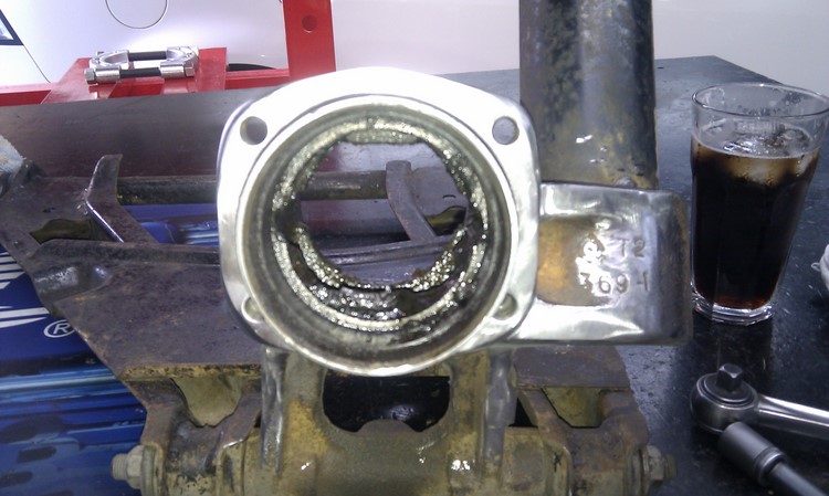

Scoota G Posted June 26, 2011 Author Posted June 26, 2011 Step 1: Modify the brackets Now if you have already jacked the car up taken off the wheels and removed the brakes that's fine as you will need the rear drum plates to use as a template for drilling the Modified R31 brackets to correct spec but if you have a spare set better to leave the Zed alone as it takes a while to modify them both correctly. As i have stated before choose your method to remove the backing plates, i don't think it's necessary to go into the process as it is well documented in the thread below. But there's a couple of pictures at the bottom anyway. So back to the modification, the calipers are mounted facing the front of your Zed. Mounting them at 12 O'clock will cause them to foul on the strut (many thanks to simon for spotting that one) so clamp the calipers onto the old backing plate in the proper position (slightly less than 90 degrees from 12 o'clock will give better clearance for the handbrake cable) and then drill your holes. If you decided to take off the hubs you won't have to cut the bracket further as we did which is shown it the photo below. Please be aware that these brackets may need a tweak as in elongated holes or further grinding to make them fit properly. Quote
Scoota G Posted June 26, 2011 Author Posted June 26, 2011 Step 2: Modifying the rear strut and handbrake mounting Now is the time you should get to Your Zed and remove the rear brakes and backing plates as described by Lurch in that now infamous thread. Either that or remove the stubaxles (personally i've never had a problem getting them out). Now if you have gotten this far and tried to offer up the Modified R31 bracket to the strut you will notice that it will not sit correctly on the bottom rear (in the case of our cut bracket, the other version may need more adjustment) so grab that saftey gear and grinder and carefully grind away the part of the strut it is hitting. There's plenty of metal there and i chose to do this rather than weaken the bracket. Take your time with this to make sure the bracket fits flush. After this you will need to unbolt the R31 Caliper handbrake mounting bracket bolt from the caliper with a 6mm allen key. You'll need to resize the hole that the handbrake cable slides into to suit the Zed handbrake and then shorten the mounting bracket shaft by about 50%. Then tap out the bolt hole deeper and shorten the allen key bolt to suit (or just buy two shorter bolts). With this modification the stock Zed hand brake cable will fit the R31 Calipers, another way to do this would be to use the stock Zed Brackets and weld them to the shaft of the R31 Bracket (after you lop off the top). Quote

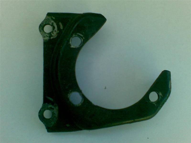

Scoota G Posted June 28, 2011 Author Posted June 28, 2011 Here's a picture of a stock set and machining them to 86mm takes them about 1.5mm past the inner edge of the stock bolt holes (R31). Quote

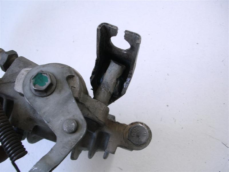

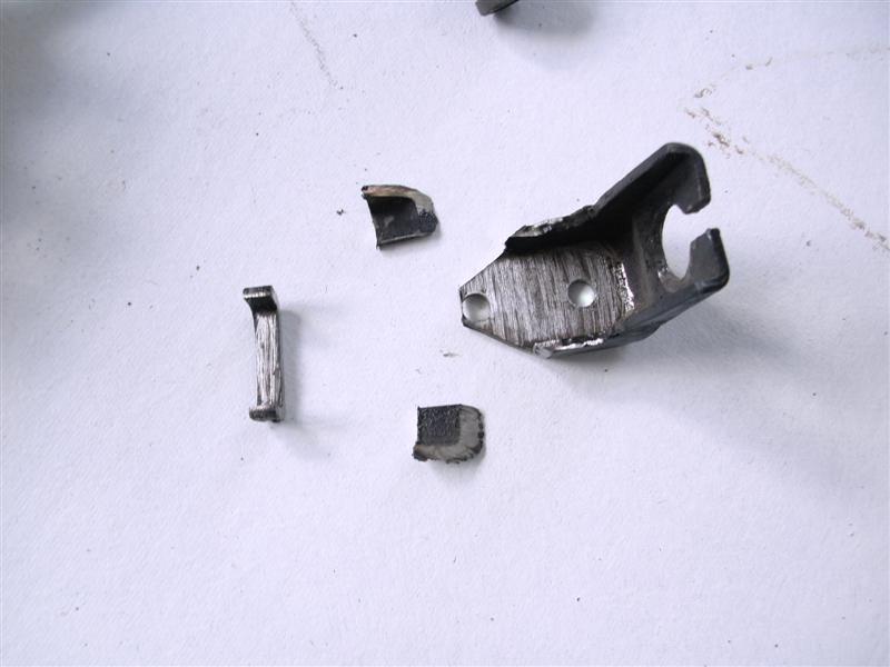

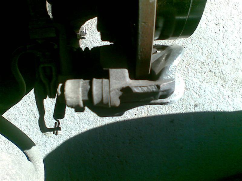

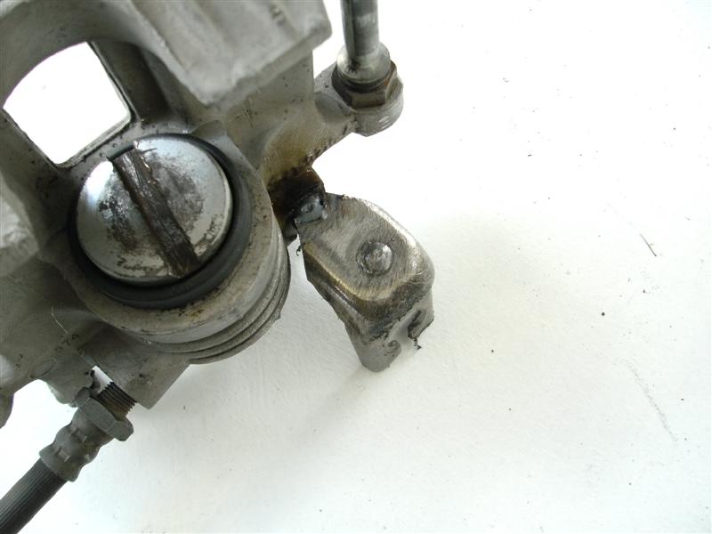

Scoota G Posted October 9, 2012 Author Posted October 9, 2012 Update on a revised handbrake setup. I was thinking about this since i did the conversion and have since done the same rear upgrade on my 2+2. First cut the R31 handbrake bracket as pictured. Then take the stock Zed handbrake bracket and trim it to the first bolt hole as shown. Then cut angles on it to suit either left of right caliper. Line up the Zed bracket on the R31 stalk and and plug weld the bolt holes. Then turn over and weld the other side (two decent tack welds will be heaps). Then squeeze the Zed handbrake cable at the end bracket and fit the R31 washer (perhaps a small amount of grease too) and a new split pin. You will need to bend the caliper handbrake arm to suit but it's very easy to do. After you fit the clip to hold the handbrake cable in place you will notice that the bracket point the cable away from the half shaft on a slight angle which helps with clear it much better than the previous modified R31 bracket. I have tested this setup and it works very well. This saves you grinding down the R31 bracket and reducing strength. Quote
Scoota G Posted October 9, 2012 Author Posted October 9, 2012 10 Brownie points to you Mark! Thanks Chief. Here's the cable installed. Quote

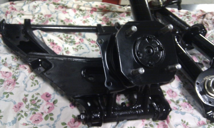

red76z Posted November 6, 2012 Posted November 6, 2012 Here are a few pictures of my R31 conversion by modifying the rear struts/hub to suit the complete bracket. I ground the bottom corner and took a bit off each other corner witch allows you to pivot the bracket between 2-5 o'clock . The best angle for the hand brake cable I found is about 3 o'clock. as they say (a picture says a thousand words). I hope this helps in future mods. Quote

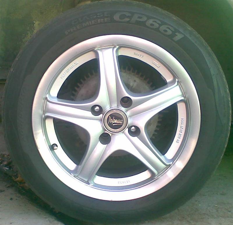

red76z Posted November 30, 2012 Posted November 30, 2012 The finished Look. P.S If you are replacing the rear hub bearings before you try to press them back into position or bash them in with a hammer and punch, Just put them in your freezer overnight and if they are like mine you can push them into place by hand. It works a treat.. Quote
red76z Posted November 30, 2012 Posted November 30, 2012 A few more photos to help you with your project. Quote
