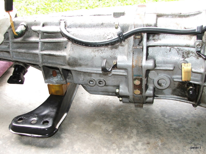

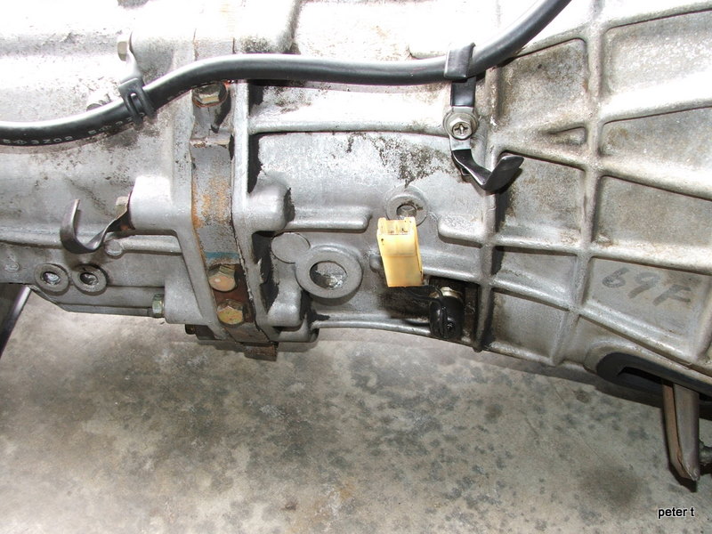

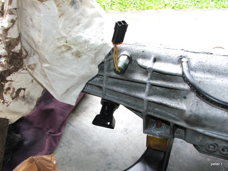

  What are the two switches on a SR20 box. One would be the rev gear but what is the other one. Thanks for any help. 8)
Not sure but I reckon bottom connector in the extension housing is for the speedo, the top switch in the extension housing is a neutral switch and the one towards the front of the box is the reverse light switch.
They look the same as the ones on my Navara box and in the same locations.
You should be able to tell if you have a multimeter and measure which switch is closed when you select different gears.
Mick
Thanks the neutral one is the one I won't be using. Speedo drive has to be changed to cable type which is under control.  :DU
