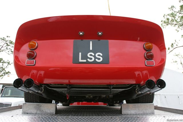

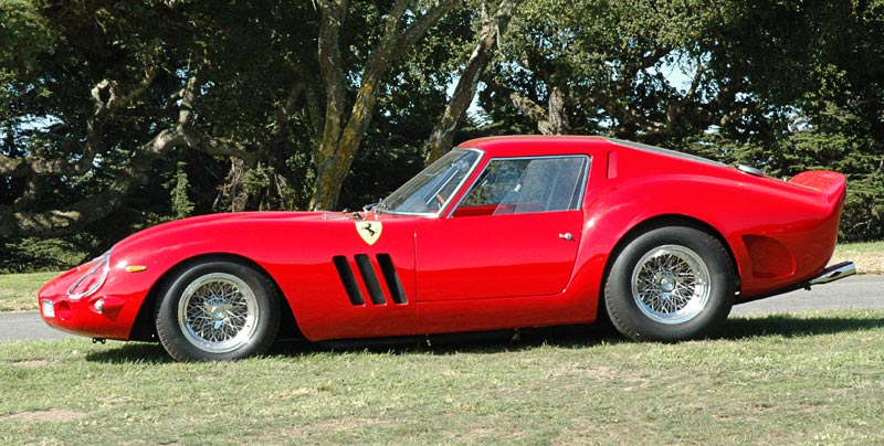

PeterAllen Posted January 5, 2011 Author Posted January 5, 2011 ... If you do fit one try to find an old XF/EA/EB sedan or equivalent dunnydore at a wreckers. Thanks - The ADRs are all over the place with this project. The shell retains the Datsun ADRs, but the LS1 has to ADRs from when it was manufactured and the 250 GTO body has its own unique ADRs. I might just hang a stop light from the roof cross-member near the interior light rather than attach it to the hatch glass. Quote

PeterAllen Posted January 6, 2011 Author Posted January 6, 2011 ...Is there a reason you don't want an LED 3rd brake light? ... I'm trying to keep it in-period, i.e.1962 Carello/Lucas lights. I have the stop/park and indicator lights. I would be most interested in any photos you have, thank you. ...If you decide to install the light inside the glass, you really need to make a shield (not the word I want to use there, but can't think of the proper term), that directs basically encloses the area between the light and the glass, so that none of it gets reflected off the glass and to the interior. ... A very good point - back to Plan A. Quote
