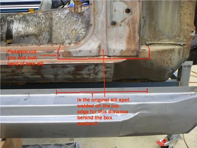

The structural box section that the door hinges bolt to is spot welded where it meets the top of the sill panel. The sill panel runs right through under this section but I don't know if the top edge of the outer sill panel is spot welded to the inner sill panel underneath the hinge box section? It will be easy to unpick the spot welds where the box section meets the sill and remove the complete sill if its not spot welded underneath. If it is spot welded it makes things a lot harder and may mean I have to cut the sill panel around this area and butt weld as per my picture?
So has anyone removed a complete sill and know if the top edge of the outer sill is spot welded for the length it runs behind this box section?

I did mine about 3 weeks ago and was worried about the same thing.
i drilled out all the spot welds i could see and gave the sill a good whack and found NO spot welds behind the box section, it just came out
hope this helps
Loui
I highly doubt it will be Dave - how would the factory get the spot welders in there, themselves?
Thanks Loui, very happy to hear that! How was the fit for the new ones? Any tips?
Lurch, they could have depending on the order they assembled and welded the parts.
Hey David
i havent got to that stage yet, i did a quick fit and found that the all z sills need to be trimmed a bit where the box section is
will put more info on my post when i do them
