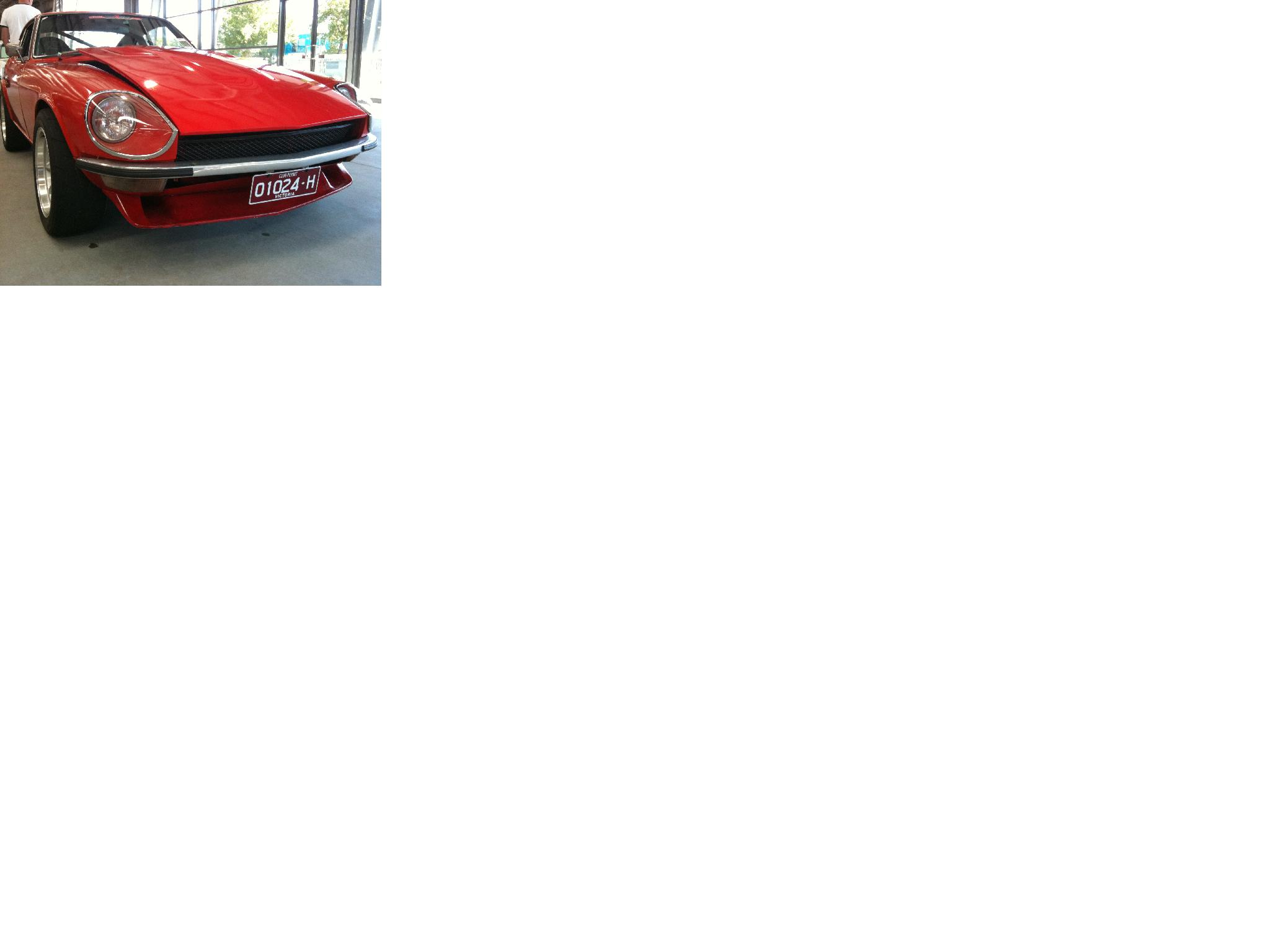

Moderators Zedman240® Posted July 28, 2010 Moderators Posted July 28, 2010 Yep, I have them on my 240 now. I'm running 225-50 tyres and the sidewall just sticks out around 5mm or so from under the lipped arches. I do get some rubbing from the fronts while turning and going up a driveway but not major. Best pic I can find for now is below...let me know if you need one from the top or another angle.. Quote

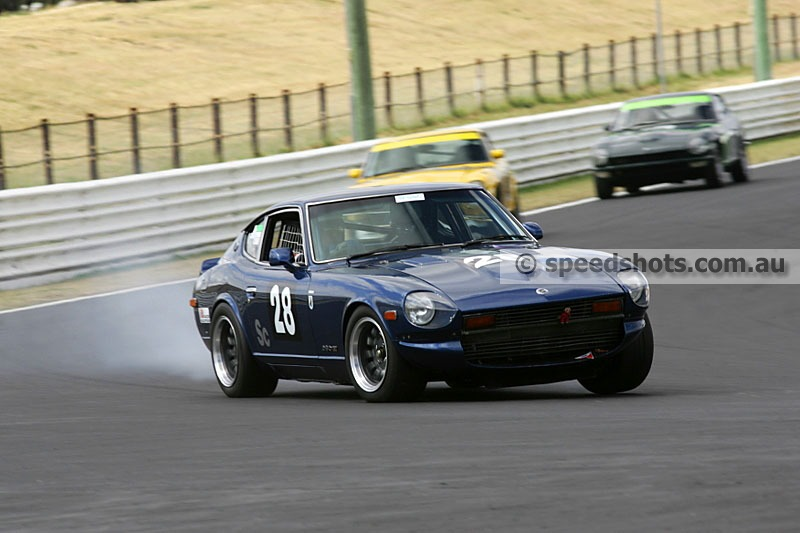

dat2kman Posted July 30, 2010 Posted July 30, 2010 pic of mine with 15 x 8 and 225/50 x15 rubber, front guards are fine, rear guards have had a bit of lip trimmed from 10 o'clock to 2 o' clock All works well. Note to lurch, this is when I am not in Historic group S mode !!!! Quote

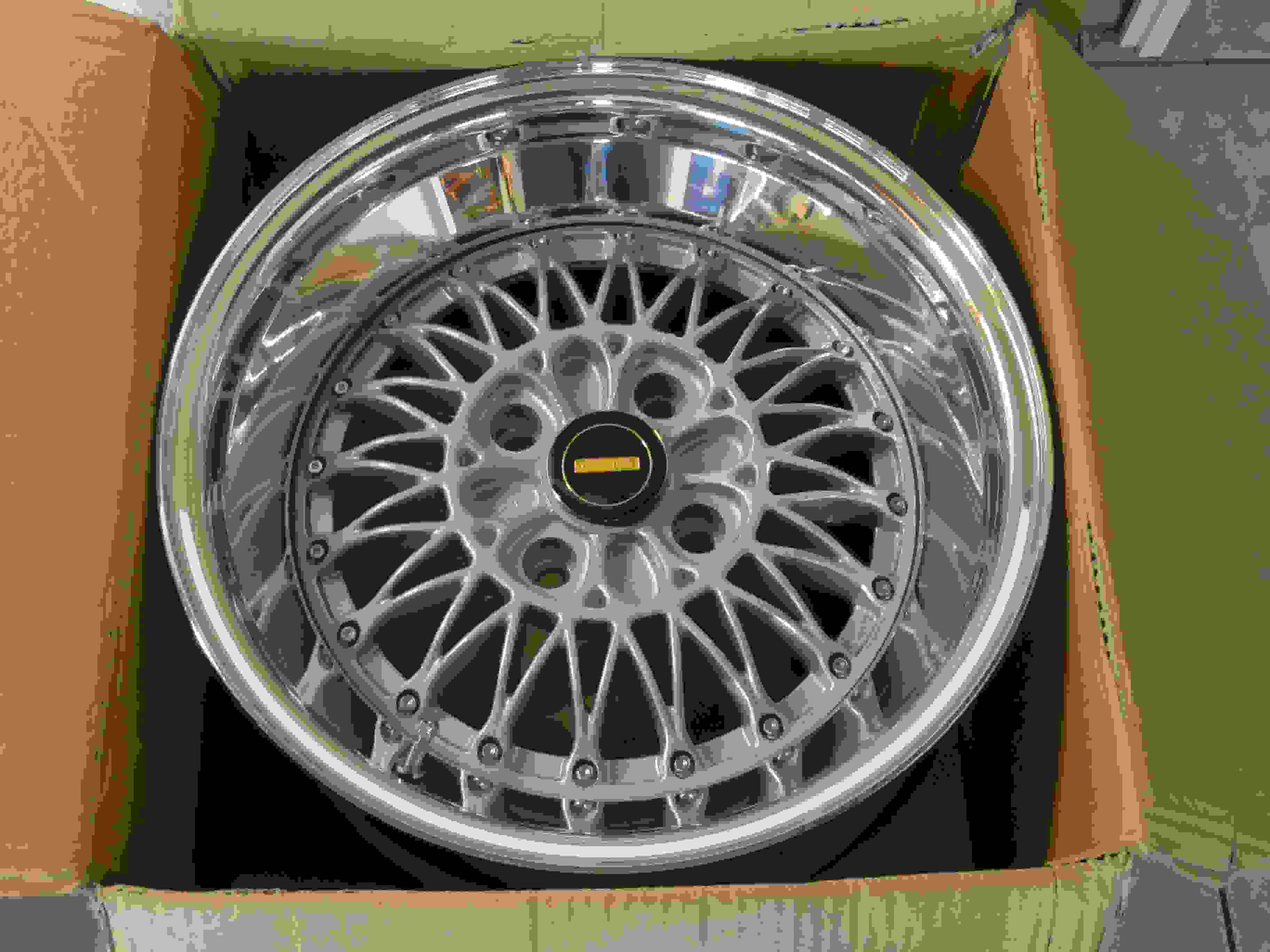

Z Posted August 1, 2010 Posted August 1, 2010 Simmons arrived, old Z guy who used to fit Zeds for years prescribed: Front: 16x7.5 (0 offset) Rear: 16x8 (-6 offset) AND 4 1/3 backspace all round. All I can say is...DISH!!! Hope this helps. Quote
