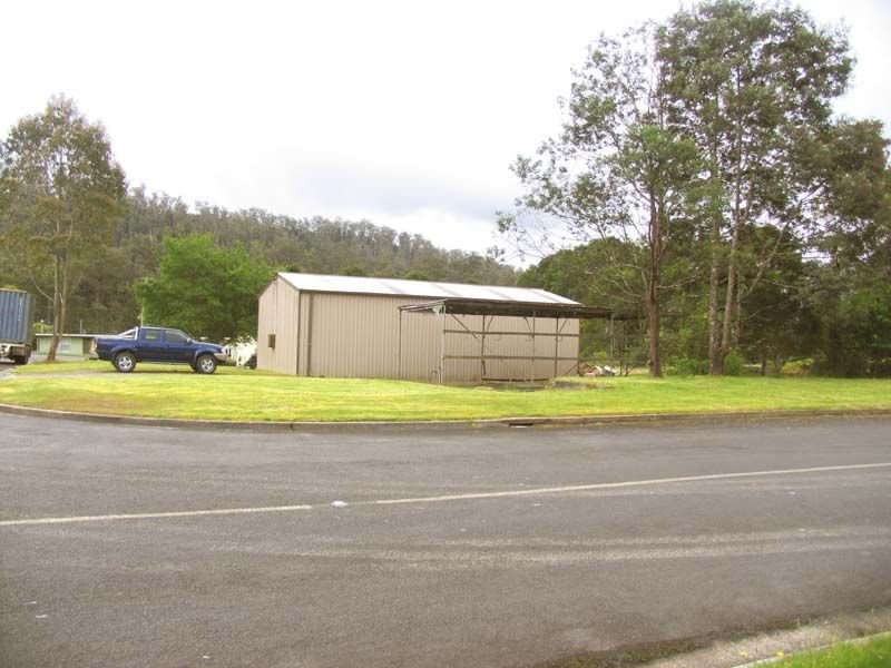

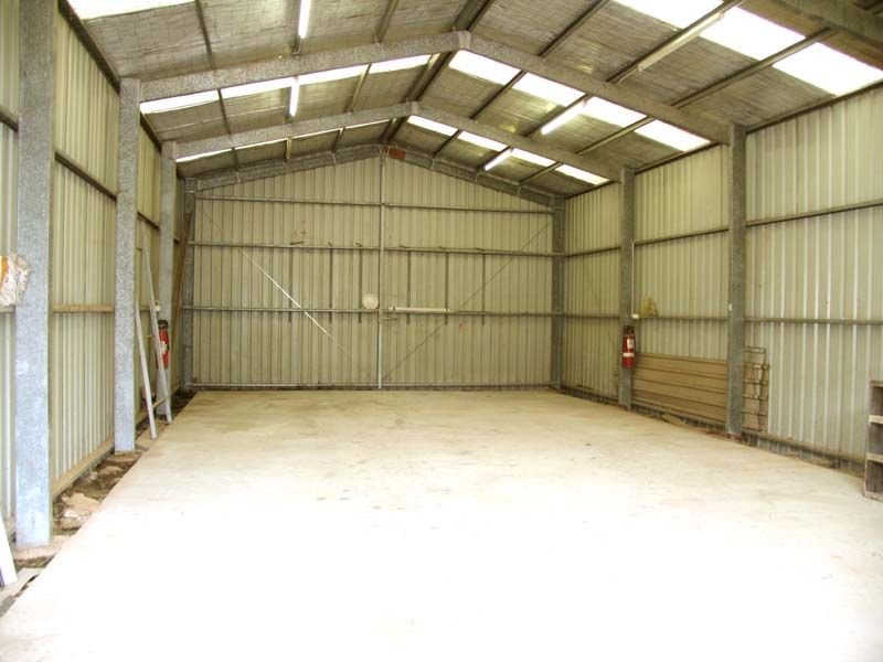

Hunter Posted June 14, 2010 Posted June 14, 2010 I just bought this double block with one and a half sheds on it. The land area is 1856m2, Shed come with Mig Welder, Aircompressor, wood heater, gas heater, bench grinder, benches and heaps of other stuff. Quote
