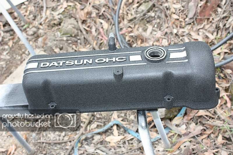

NZeder Posted May 18, 2010 Posted May 18, 2010 Here is a pic of one of the guys here in NZ cover - I like what he did with this one Quote

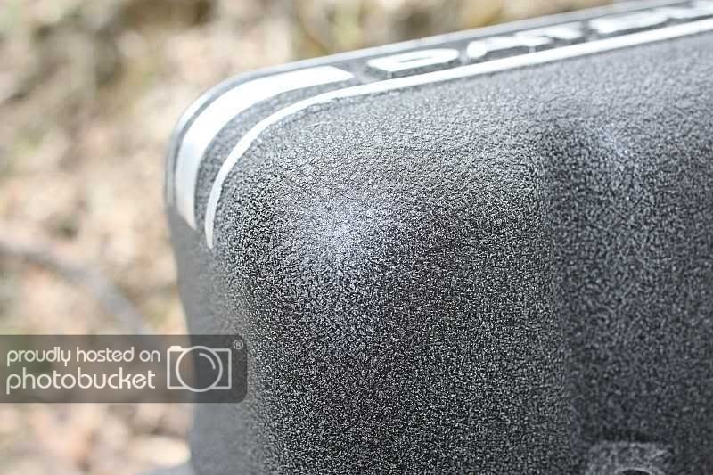

1600dave Posted May 18, 2010 Posted May 18, 2010 I did mine with VHT black wrinkle paint - cleaned it perfectly, sanded, polished then masked the bits that ended up being not painted, sprayed it, carefully removed masking while paint was still wet, then cooked it in the oven for an hour at low temp (as per the instructions on the can) and it came out perfect. Its actually quite a bit "blacker" than the photo's show. Quote
