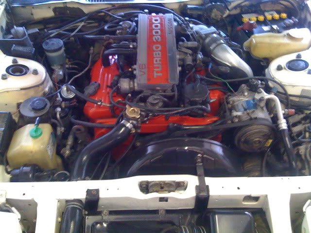

zzzzed Posted April 1, 2010 Author Posted April 1, 2010 i did some work on the calli over the last couple of days. I found that the rack ends are rather warn. I rang adelaide z cars and they are going to rebuild the rack with new rack ends and new seals for $450 and they are going to do it while it is still in the car which is even better. It occured to me i dont have any engine bay shots so here it is Quote

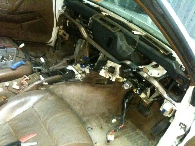

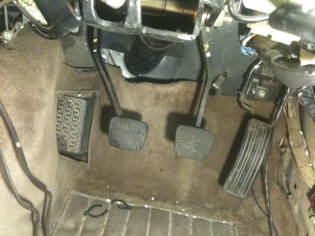

zzzzed Posted May 29, 2011 Author Posted May 29, 2011 Ok i am a bit of a stale mate with the s30 so i decided to do some thing to the z31 this is where i am at I just purchased a 5 speed conversion kit so ill be going from auto to 5 speed . so far i have the dash half out ready to install the pedal box I also removed the tail shaft today to have the front yoke changed to suit the 5 speed. I didnt realise what a pain in PITA it woulkd be just to get the tail shaft out. I had to removehalf the exhaust Ill let you guys know any other pit falls i have along the way ok i got the dash removed during my lunch brake today. If you follow the steps in this link it really is a pice of cake \ http://www.az-zbum.com/repair.dash.removal.shtml this evening I managed to fit the brake pedal. I was told that tis is a PITA of a job but I managed to get it first time. All i did was use a screw driver Through one side of the pedal pin hole as i guided the pedal pin through the other side. Easy peazy I also have the clutch pedal in position but not yet bolted up. I hope to have the dash back in tomorrow eve Yesterday I managed to remove the auto box with out to much hassle. I probably would have managed to get the 5 speed in today but i had a bit of a set back with the spigot bush. Reference for people attempting this conversion, there is a spacer in the back of the crank shaft for the auto flex plate. This has to come out or the spigot bush wont go in. Ditch this spacer, it is not needed I have to wait till tomorrow so i can get a new spigot bush because i trashed the last one trying to force it through the crank spacer Quote

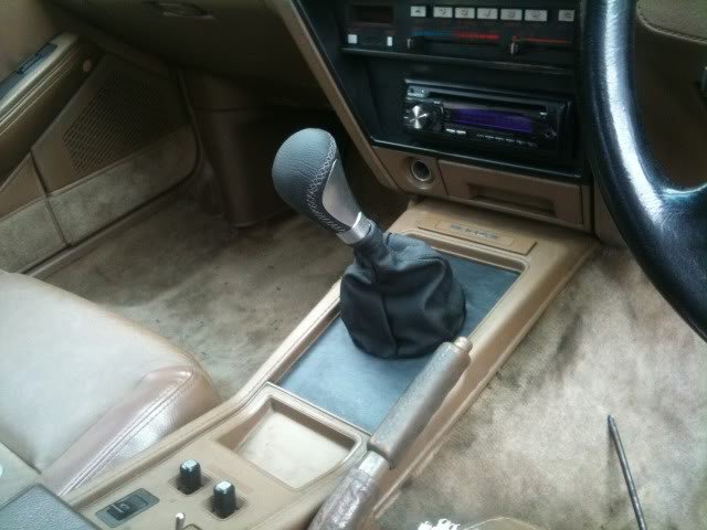

zzzzed Posted June 13, 2011 Author Posted June 13, 2011 I got the 5 speed in and working great. I didnt realise that it was going to make such a huge difference.. Wow this thing pulls hard now. Its like a different car. It was a pain in the ass but well worth it. Im never selling it now I highly recommend this conversion to any one (scoota) Quote
