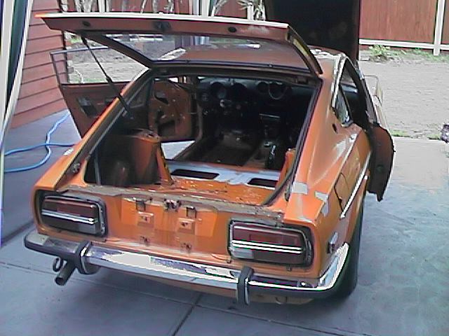

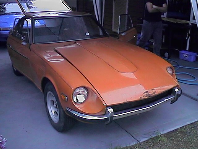

Moderators Zedman240® Posted January 12, 2010 Moderators Posted January 12, 2010 Dimitri, I'm tipping your reffering to Georges car. Yep and you can still notice it's a non aussy car if youtake a walk around it. Reallyt cool to see a US spec'd 240 in person. Sulio Yep Sulio, Not many people know of that or seen that car...I have some pics when he first brought it to Oz, it was in a sad state to say the least.... Some farm animal was sleeping on the roof and rust was in lots of places...the trick of importing a zed from the US is to bring one without the rust! Excuse the poor quality of the pics..back then I had a .36 Megapixel camera.. Quote
