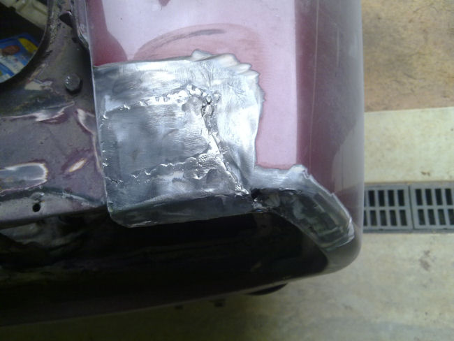

C.A.R. Posted September 5, 2009 Posted September 5, 2009 Well I've finally gotton a chance to start on Joel's Bus & atm it's stripping & inspecting. I've taken the front PS guard off as the guard is a bit sad & also where the guards bolts onto in the engine bay 'flange'. More to come later... (Pics taken with my Nokia phone!) P.S. I'm COVERED in bog & rust dust Quote

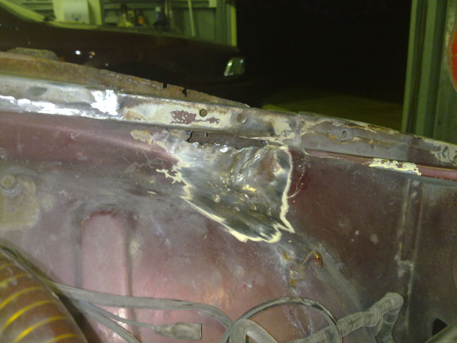

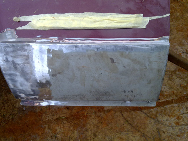

C.A.R. Posted September 5, 2009 Posted September 5, 2009 Well in between the SPAmaster poping in for a chin-wag, a dizzy change & a quick tune, I managed to get a new panel formed & welded in on the PS guard. There was 3 previous repairs (ie 3 layers of sheet (badly) welded over the old rusted section) so I cut the lot out and started again... Quote

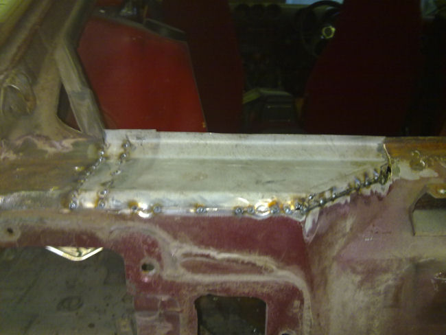

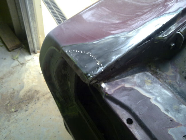

C.A.R. Posted September 5, 2009 Posted September 5, 2009 I also cut out a rusted section on top of the guard, formed up a patch & tacked it in. Quote

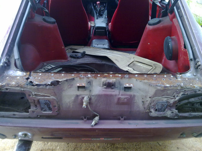

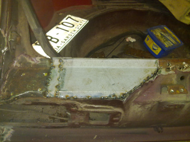

C.A.R. Posted September 12, 2009 Posted September 12, 2009 Today I was busy working on the back of Joel's Bus... :-\ There were a lot of bog & rust holes in the 'slam panel' where the hatch locks into, & since you can get new panels easily I decided to unpick it & see what the panel(s) was like underneath - I'm glad I did! Quote

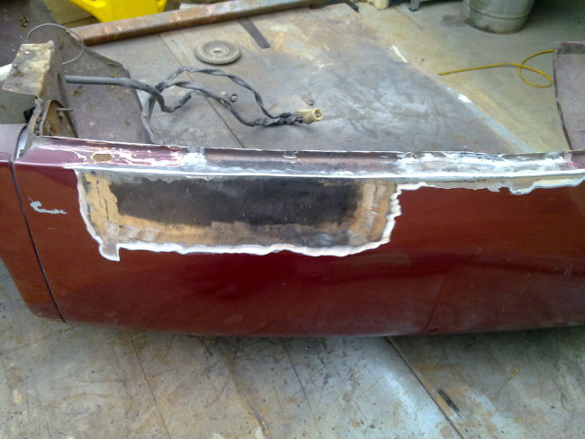

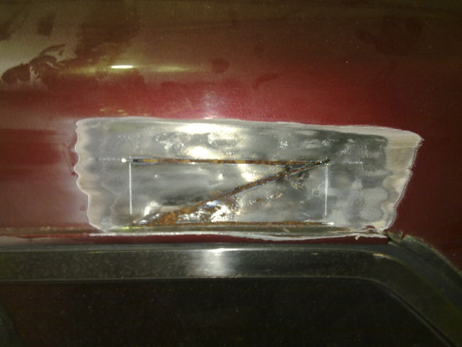

C.A.R. Posted September 12, 2009 Posted September 12, 2009 And a couple of bodgy repairs a PO to Joel had performed on the rear 1/4's... I'll be tackling these after the rear slam panel is fix0rd... Quote

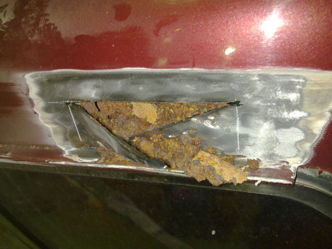

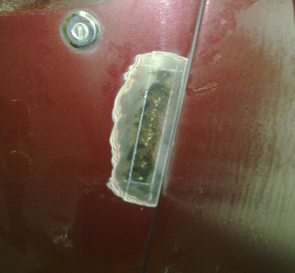

C.A.R. Posted September 13, 2009 Posted September 13, 2009 No way in heck I'm doing that, Dimitri! Few more pics too: Quote
xa1973 Posted September 13, 2009 Posted September 13, 2009 Good work Lurch... What are you replacing the parent metal with.... Quote
