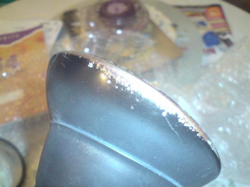

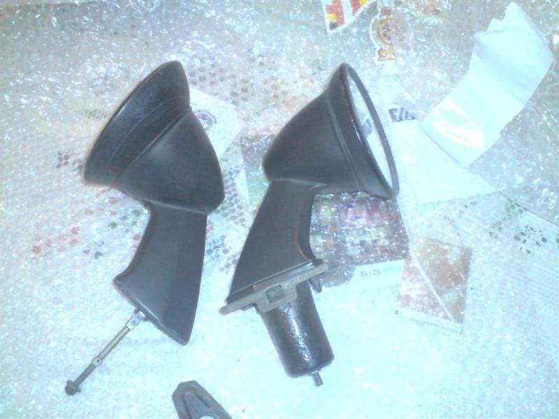

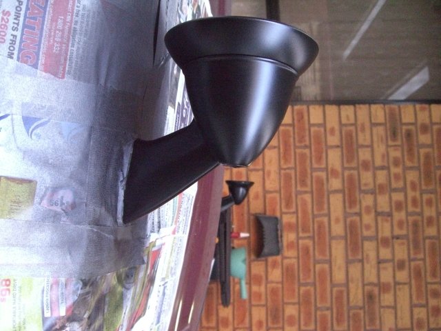

ol_skl_jp Posted June 12, 2009 Posted June 12, 2009 I just recieved my set in the mail today, and they are not in the best condition, they are ok but not great. Anyway what can i do to make them look like new again. I was thinking of just spraying them with a satin black pressure pack can. The thing is im not the best when it comes to preping for paint. i have dismantled it so i can spray every part separately. I have a can of spray putty from supercheap, what number sand paper do i use. When ever i sand i leave marks on the surface like where the grains are. Also is there a special brand paint i could use that lasts longer than others, like the supercheap ones dont last very long. Sorry for the camera phone photos Quote
Scoota G Posted June 12, 2009 Posted June 12, 2009 Sounds like you need to work more on your wet & dry rubbing between coats. 400 wet and dry (The Black color) used wet between coats is a good starting point for primer, i always tend to buy the norton brand paper but you need to buy it in sheets. You can buy dry paper from a roll which tends to be cheaper but i haven't seen it in roll form. Also as you get more coats on you can go for 600 or 800 grade. Quote
xa1973 Posted June 12, 2009 Posted June 12, 2009 Add Note: I would rub them back as far as you can After the initial sand use etch primer, then primer then spray putty to fill in the small gouges, works a treat, you need to sand between each coat My advice: don't mix product brands, K&H or Septone make mid range quality products of etch primer, primer, spray putty and paint and are very good for small jobs like your mirrors and trim bits etc, available in aerosol cans from Autobarn or the like. Don't forget to wipe over ( one way direction not back and forth ) with wax and grease remover before each coat of paint after sanding,( three or four coats for longevity ) if you want you can then spray the finished items with a protective coat of clear The key is to take your time with each step Quote

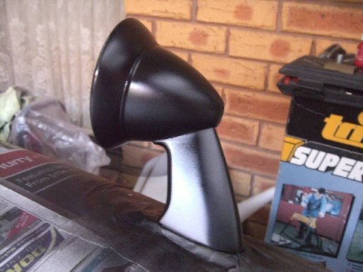

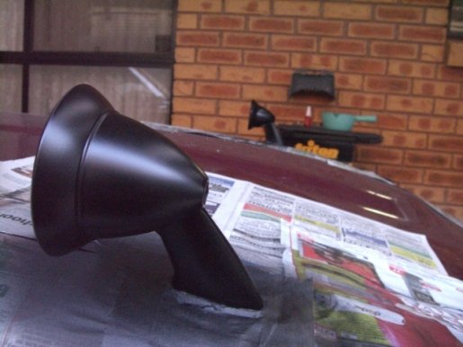

ol_skl_jp Posted June 16, 2009 Author Posted June 16, 2009 sanding and more sanding hope u love it. i sure dont. I dont either but being such a small thing i didnt mind. What was worse was waiting for things to dry. Well i finished them i got them all nice and what not, then i went to fit them once finished i saw that i had left fingerprints on it, tried to wipe it off just made it worse by smudging it, mind you the mirrors were drying since Sunday arvo. Since i spent so much time prepping i didnt feel right just leaving them like that. So i adjusted them sanded them down and applied another final coat. Below is the result, looks alot better than when i received them Quote
Scoota G Posted June 16, 2009 Posted June 16, 2009 Dude, you're a natural This is my below standard effort at painting stuff. Quote

sexual_sushi Posted June 16, 2009 Posted June 16, 2009 Looks like new, if not better. Good work Quote
xa1973 Posted June 16, 2009 Posted June 16, 2009 Good Work Sach........ Glad they turned out for you, you started small, now onto bigger things... NB: Grab an old panel from the wreckers and practice your painting, it wont take you long, there are plenty of good simple reading technical articles / books to get you started youll be surprised how easy it can be once you understand the principles Quote
