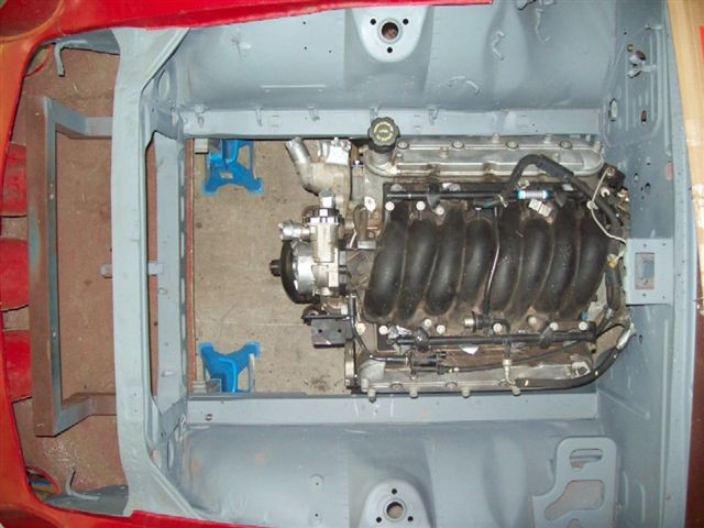

zed240au Posted May 9, 2009 Posted May 9, 2009 have you considered a ls1 holden v8 dearer to buy though they are getting cheaper with more becoming avaliable from wrecked commodores can get with 6 speed manual more hp in std trim than toyota v8 and if you want more hp huge aftermarket supply of parts and tuning just idea to consider i am biased though as i have fitted ls1 to my 240z Quote
towndrunkensmurf Posted May 9, 2009 Posted May 9, 2009 how does the 240 handle with the heavy LS1 in the front?? doesnt throw the cars geometry out too much?? Quote
PeterAllen Posted May 9, 2009 Posted May 9, 2009 The LS1 and six-speed t56 weigh only 15 kg more than the original 240Z engine and gearbox. When the LS1/t56 is set back in the bay, all 15 kg ends up on the rear wheels. Cost wise - I bought a 2005 VZ SS Ute at salvage for $5200 and sold the unwanted (and undamaged) bits for $2400 on eBay. The LS1(335bhp), t56, LSD diff, loom, etc, owes me $2,800 - cheap as chips. Quote
