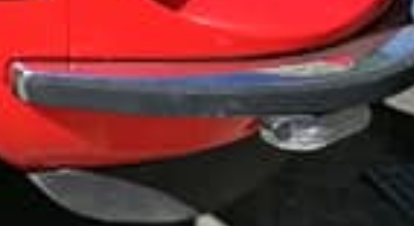

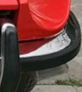

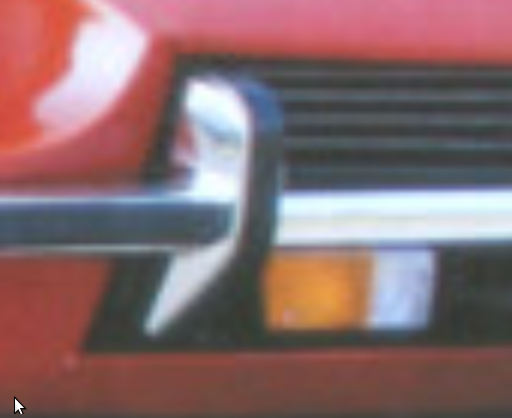

gilltech Posted August 14, 2022 Posted August 14, 2022 Hmm, neither of those set-ups look nice do they, both look like the add-ons they are. I totally agree with the direction you wish to go! Bear in mind that if you do obtain a pair of the Australian / NZ spec two bulb 260Z units then you will need either the valance corner panels with the cut-outs to house them, or get a template off one of us so you can cut out your existing ones. Quote

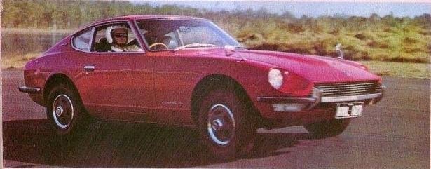

gilltech Posted August 15, 2022 Posted August 15, 2022 (edited) The clear lenses you ask about are on eBay Australia presently. PS. In your 4 photos, which one is your car, the one with the bumper over-riders or the one without? Edited August 15, 2022 by gilltech question added Quote
datsunnyit Posted August 23, 2022 Author Posted August 23, 2022 my z is not in the pictures, but ufficialy sold from the dealer in years '70 with little clear lens ( italian product used in other italian car) visible in a car test with Fittipaldi. The Italian market not have the over - riders, in the picture probably is Alfa Romeo over riders. Quote
