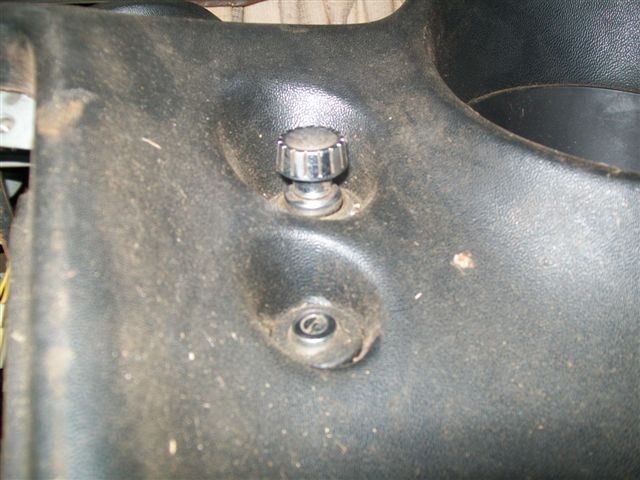

I have 3/72 240Z and it has the lighter in the dash and nothing in the console. The instruments are imperial (MPH etc). I got the car in bits so there is no certainty it's the original dash but I'm fairly confident it is.
Also, on the dash below the lighter there is a similar shaped indentation which has a tumble lock - like a small ignition switch. Anyone know what that's about?
Have a look at the car on the '240Z Dump or restore' thread - may help.
