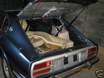

Hi All, brought this one off ebay a few months back and hope to have it back on the road before Xmas with the end goal to compete in Targa Tasmania (2011).
Its missing loads of bits that have been lost during the last few owners failed attempts at reserection and the 2+2 seams to be more difficult to source parts and information than the 2 seater.

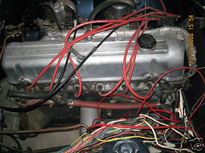

It has a L28 with carbs ATM and I'm currently trying to correct the butchered engine bay wiring that replaces the volt regulator with the self regulated alternator.
I have read all post on this topic but it still won't charge when fed power from the charge light but will if its direct from the Battery. Has anyone done this on a 2+2 before?

Anyway, hows the body/paint condition? It looks alright from the photos.

FActory manual is pretty good. 2+2s are far easier and cheaper to get parts than 2 seaters as 2 seaters are more desirable and more pricey. I saw that one on ebay too, it had a respray done on it didn't it? Paint looks immaculate. If I could undo everything the PO did to my car it would be running by now ;D
Yeah the respray is pretty good but there is some reaction to the primer (I'm guessing) on the bonnet and a the top of the hatch has a few bubbles forming. I have cleaned up the internal rust in the driver side which was mostly just surface rust and the rest of the inside is in very good nick as far as rust goes.
Will do a full clean out inside when the roll cage goes in but that could be a while away yet. The drivers side chassis rail has a 4 cm section rusted out from being dented often and will need to be wielded up. and thats about it.
The Haynes manual is very vague and I've down loaded a few variations of wiring looms but not that match all that well. Have ended up getting familiar with the old multi meter and test light to solve some of the gremlins.
I now have most of the Nissan factory manual that has helped lots (thanks for the tip rbz 260).
