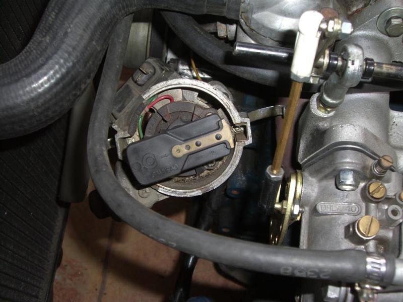

ol_skl_jp Posted September 13, 2008 Author Posted September 13, 2008 Here is a pic at the TDC isnt the rotor meant to be pointing straight ahead. I have plugged the wires like this aswell Quote
Scoota G Posted September 13, 2008 Posted September 13, 2008 Yikes!!! The rotor is supposed to be like the one in this pic i just took. That means that the distributor drive is not set properly. I had the same problem when i bought a new points distributor. This requires you to take off the oil pump and set it up right. On page 22 of the Haynes manual you can find the info that you need. If you are still having problems PM me and i'll call you and try to walk you through it. Quote

Zeddophile Posted September 13, 2008 Posted September 13, 2008 The other alternative is to simply to loosen the adjusting locknut on the distributor, and rotate the body of it anticlockwise until the tip of the rotor lines up with the lead for number 1 in the distributor cap. Assuming you don't have the distributor 180 degrees out, it should start then, and you just need to get the timing light on it and set the timing at idle to spec. Going by the photos, you are currently set to somewhere around 40-50 degrees advance, which is why it won't start - the spark plug is going off while the piston is still on its way up on the compression stroke, and is halting the engines momentum, meaning it can't actually spin fast enough to start. Yes, I know it won't be set up exactly as factory (in terms of where everything lines up to), BUT you know how its set, and it will work fine, as the only thing that really matters is that the tip of the rotor button is hitting number 1 on the dizzy cap at just before TDC when number 1 cylinder is on its compression stroke. Also, its a lot quicker and easier than resetting your drive gear! As a side note, if you've been cranking it over a lot to try and start it, its probably worth pulling the plugs out and cleaning them before attempting to start it after making your adjustments - they may well be fouled with fuel. Quote
