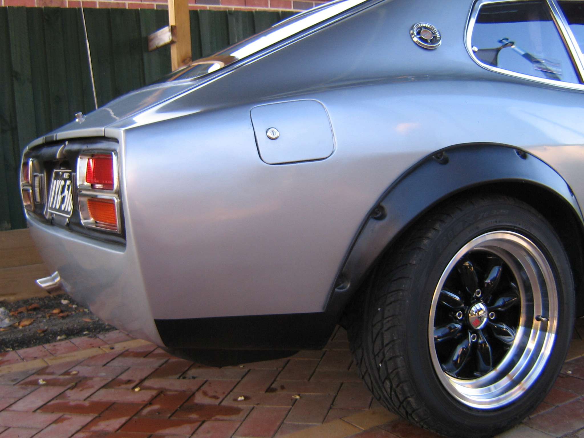

chartoo Posted August 29, 2008 Posted August 29, 2008 Will these size rims fit on my 76 260z 2+2. http://forums.hybridz.org/showthread.php?t=136846 They fit on this 75 280z so they should fit on my 76 260z 2+2 right? I got this quote form Kim at Rota wheels in America for a set of 4x 17x8.5 +04 114.3 RBR's in Royal Hyper black. He quoted $ 650 + $ 400 shipping to Western Australia = $1050. Andrew Quote

modular9 Posted August 30, 2008 Posted August 30, 2008 Mick has these on his 77 260z 2+2 with no modifications. So yes they will fit. Paid the same sort of cost as well from 18racing.com. But then he can tell you that himself Gonna get a set of these myself. Quote

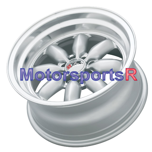

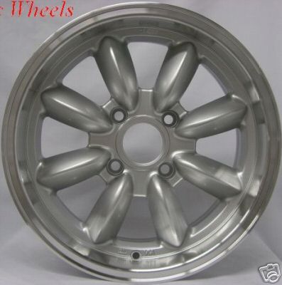

chris240 Posted August 30, 2008 Posted August 30, 2008 does anyone know what the difference in quality is between Rota rb's and Sport Max Racing rims..I assume the rota's 1 piece ? see pics.. has anybody dealt with SG motoring from US ebay before ? Quote

Add Posted August 31, 2008 Posted August 31, 2008 I've been told by some guys on the 86 forums that the sportmax rims are not as well made, how true that this is i'm not sure. I would check over at hybridz there seem to be a few guys with them over there. But it could explain as to why they are cheep. Quote
