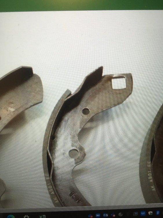

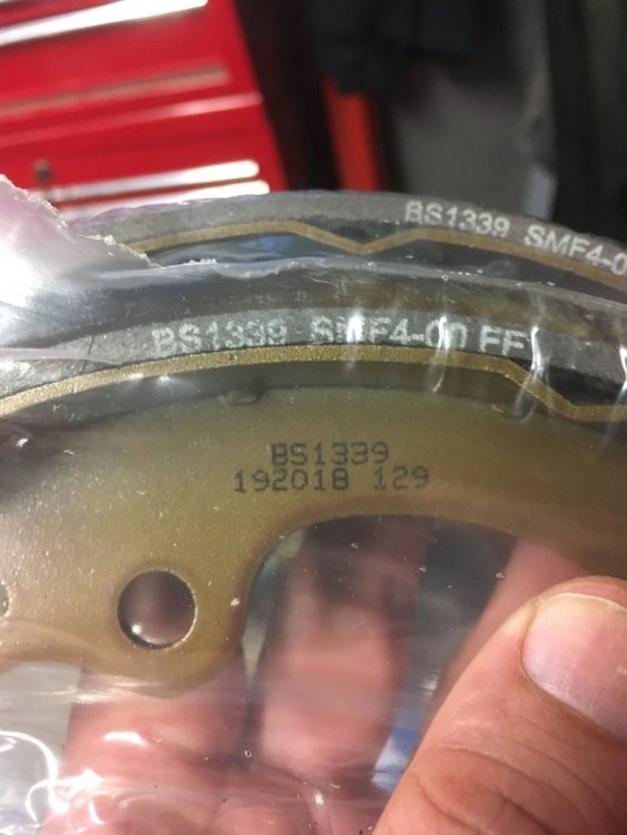

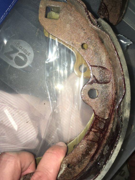

ok. the story is that i went to change shoes on my 'aug 71 plated z due a fluid leak ( more on that later). picked up a set from supercheap - bendix BS1339
had a compare to the old ones ( not really old, about 3 years old) and they look different
see the phots. you can see the hole for the rattle pin is off by about 2 cm. went to the zcardepot site ( first photo) and sure enough the OEM shows match my old ones. states that it fits 240/260 are the same
trawled the net and found these
https://www.ebay.com.au/itm/New-PROTEX-Drum-Brake-Shoes-Rear-For-NISSAN-260Z-S30-2D-L-B-RWD-/122227897918
https://www.ebay.com.au/itm/New-PROTEX-Brake-Shoes-Rear-For-NISSAN-240Z-S30-2D-Cpe-RWD/124063324500?hash=item1ce2c01954:g:JA4AAOSw1kxeL9Hm
so sounds like the bendix catalogue is wrong?
