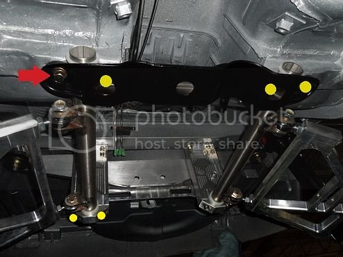

Hi all,
In changing diff strap and mount noticed that 2 of the bolt holes for the front diff cross member partially stripped.
Passenger far side is worst but passenger inner is not 100 either.  Neither will torque down fully.
Hasn't been apart (by me) since restored in '06 as a uni student - so may be one of the many crimes of inexperience. Or I can say it was the PO who installed the blue shag felt over the vinyl....(long gone!)
I believe it goes straight to body rather than to a captive nut.
So the decision is:
- drill out and tap one bigger;
- helicoil (M10,1.25),
Erring on the helicoil route but welcome any views from those with more knowledge than me.
Don't think the loctite and hope is a good option!
Photo pinched off another forum illustrates location. View on that one was 'timesert'(??)
