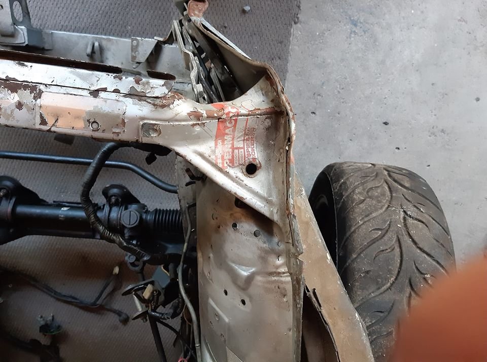

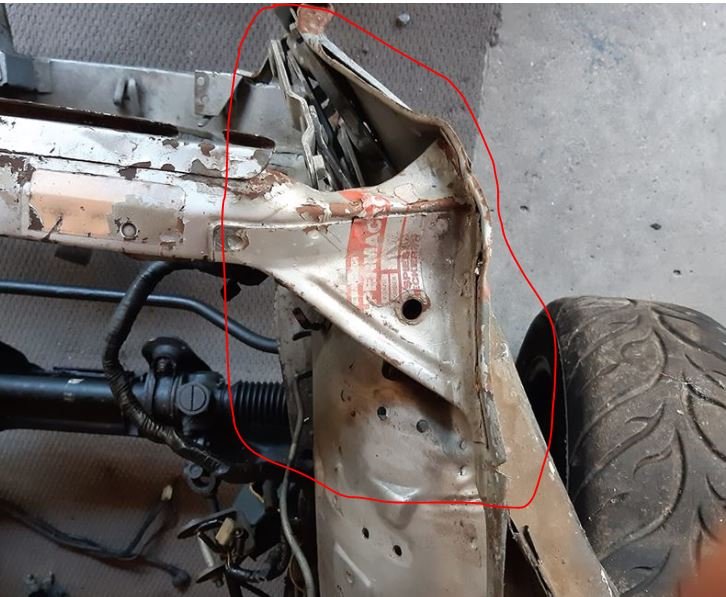

Desperate! Wanted Right Hand front Guard section
Posting for a mate
Looking for a r/h front guard section complete with headlight support and bezel please see photo we don't want to start cutting up a perfectly ok 2+2 for this one piece
Please see attached photos
I wouldn't be cutting that out Dave. Get the car on a Caroliner (chassis straightener) & pull it out straight with the chassis rail as it looks like it's gone over as well.
