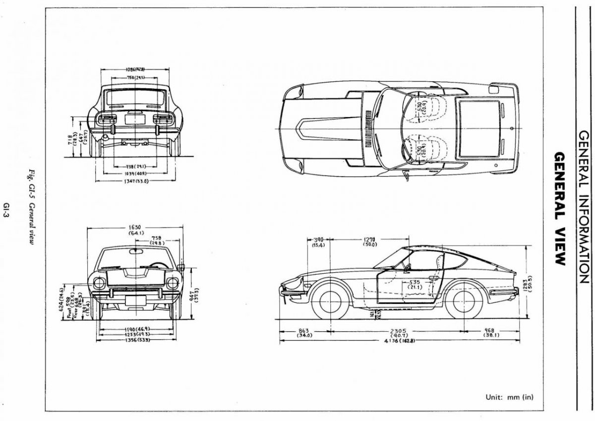

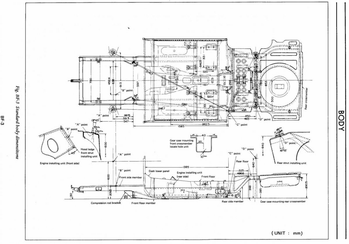

vspecrob Posted February 18, 2020 Posted February 18, 2020 Hi Z lovers, Does anyone have a link to the dimensions of the Z (240z or 260z) front end? Particularly the section at the front that shows the dimensions without the bonnet. Has to show dimensions from radiator support to tip of the nose and the bonnet bolt holes (not the bonnet itself). I have to reconstruct that section so I can fit my bonnet to my 240. Hope I’ve explained it well enough.. cheers in advance, Rob Quote
Gtv240z Posted February 18, 2020 Posted February 18, 2020 Pretty sure there is tech drawings in the back of the factory service manual. https://www.nicoclub.com/datsun-service-manuals#240z vspecrob 1 Quote
Gadget007a Posted February 25, 2020 Posted February 25, 2020 not sure if these would help vspecrob 1 Quote
nat0_240_chevZ Posted February 26, 2020 Posted February 26, 2020 Youll need measurements, as this i believe is not shown in book. A good side pic with some blank lines showing what you need will help someone measure up for you. Ie Someon with their car in their carport (not me unfortunately). Your after the bonnet hinge mount holes correct? Nat0 vspecrob 1 Quote
