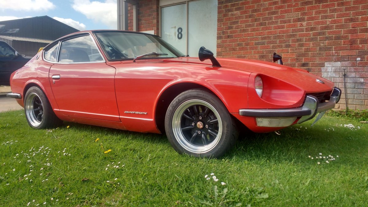

C.A.R. Posted January 25, 2020 Posted January 25, 2020 Like this: Les Collins Racing sells a package consisting of shortend struts, coil-over platforms, king springs (in whatever rate you want) and Koni Sport dampers: $2600 I've driven the above car and can attest it's firm, yet buttery smooth on the road Quote
