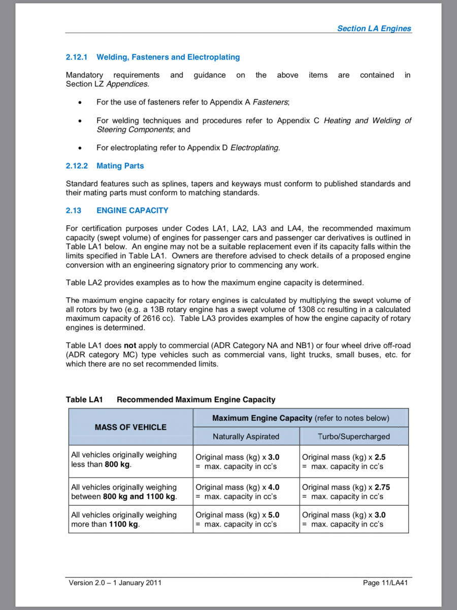

600Z Posted May 19, 2019 Posted May 19, 2019 (edited) Hello Elias, Have a look at the attached guide lines for engine transplants but certainly get a list together of what your wanting to do and speak to your engineer on how to go about it so you do it right the first time and don't have to redo anything. There are a few around and some very nice ones but seldom come up for sale. Best of luck and they are a lot of fun with the V8 in them. Cheers, Justin Edited May 20, 2019 by 600Z Quote
mossy Posted May 19, 2019 Posted May 19, 2019 https://www.infrastructure.gov.au/vehicles/vehicle_regulation/bulletin/files/NCOP3_Section_LA_Engine_01jan2011_v3.pdf Quote
600Z Posted May 19, 2019 Posted May 19, 2019 (edited) Ah cool Mossy sent you the link to it, I had it on file. Download it from Mossy’s post and have a read and chat to your engineer. Justin. Edited May 20, 2019 by 600Z mossy 1 Quote
KatoKid Posted May 19, 2019 Posted May 19, 2019 Remember that NCOP is only a guide/recommendation, it’s up to the engineer to decide what is appropriate and approve. Quote
