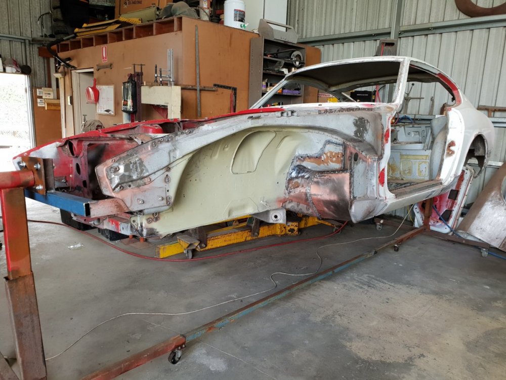

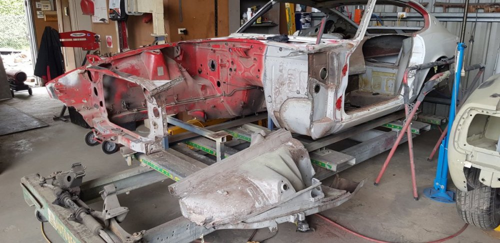

The bloke with the evay ad is the same gentleman currently doing rust repairs on my z. The 1973 front radiator support is different to the 260z one which he makes.
I have contacted Rob in Melbourne and will upload some photos this arvo when my mechanic gets it out.
A few people have looked at it.
The main issue is that now it has been removed straightening the car is much more diffucult as there is no reference point. I will upload a photo of how it sits currently.
Thankyou for your input.

Ah, I remember seeing these photos in a previous post. The 260Z one your panelbeater makes is for the later 260; he may not realise there are different 260Zs (the later 260 panel is quite different, the front rail dips down, the radiator is taller). Early 260s - like mine, a '74 - would have much the same panel as your '73; it looks the same comparing your photos above to my car. So who removed it? If he makes the later 260 type can he not fabricate an 'early' panel for your car? He has the original to go by. Or repair. What about the chassis front X-rail, is that reusable?
There are published chassis dimensions to check whether the upper & lower frame rails are within spec - jack them apart, or pull them in - and re-install & adjust the X-rail & panel to suit. Is the car on a chassis alignment machine? I'm not understanding why this is holding you up, must be so frustrating.

Personally, I'd just make a new Rad. support panel.
It's not rocket science to fix them. I do it reasonably often:
