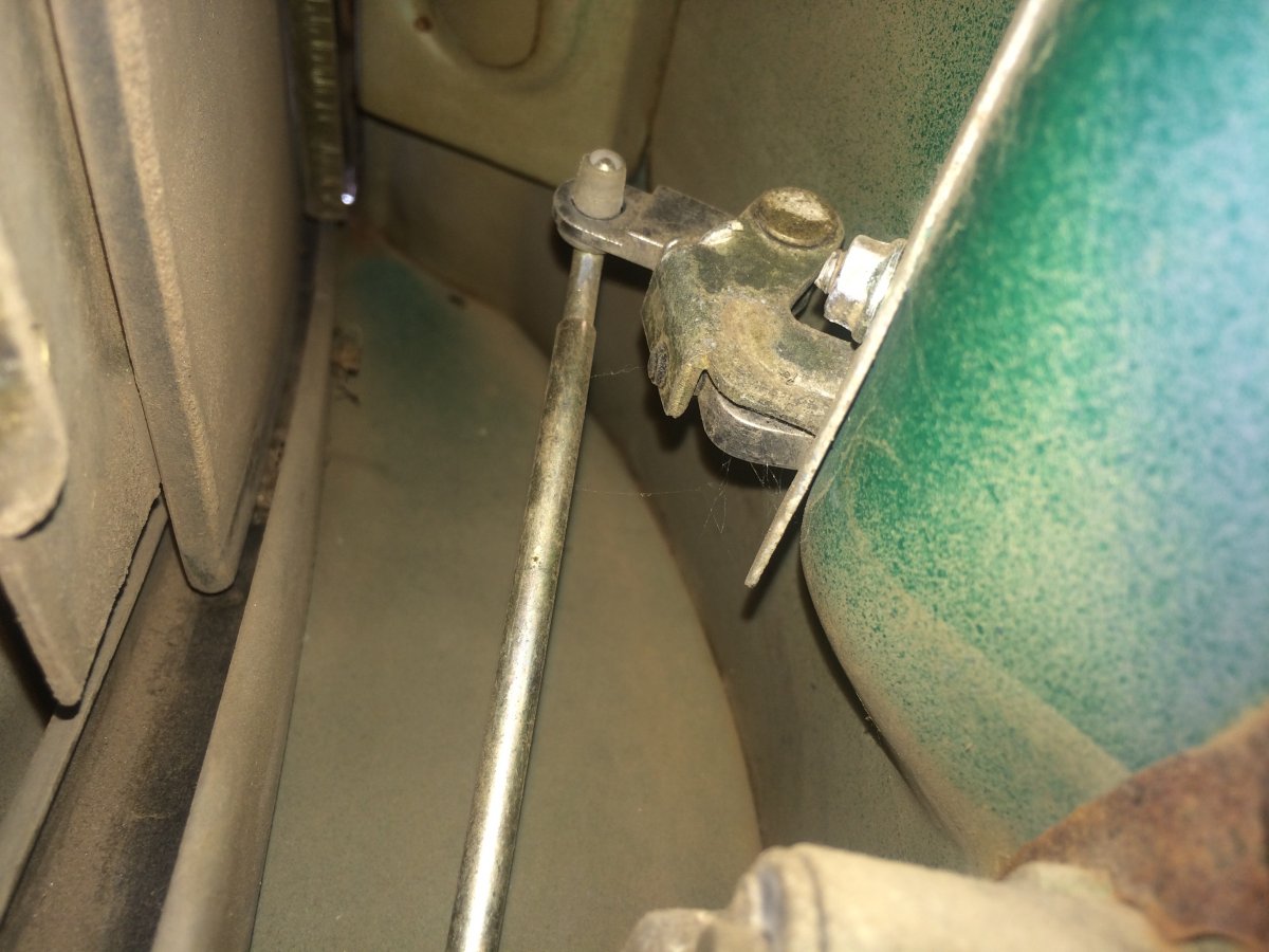

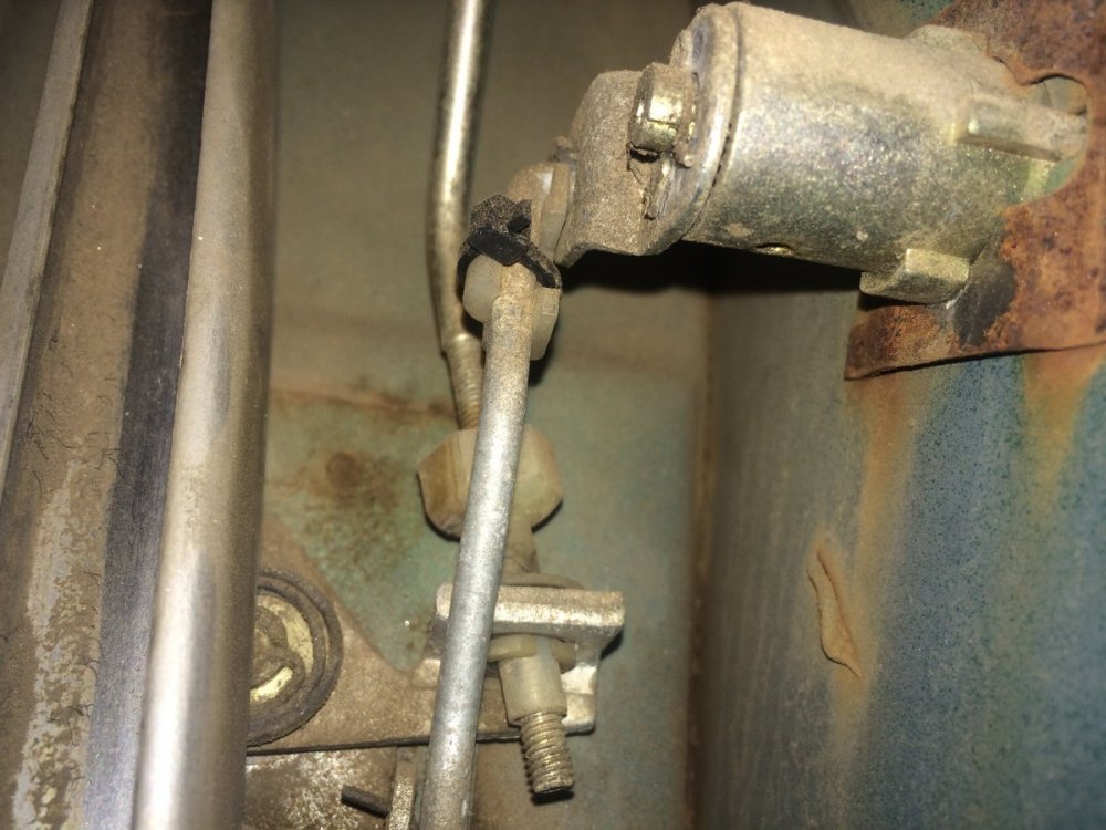

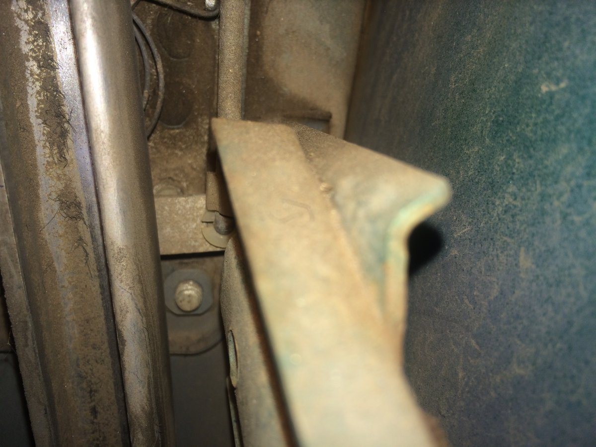

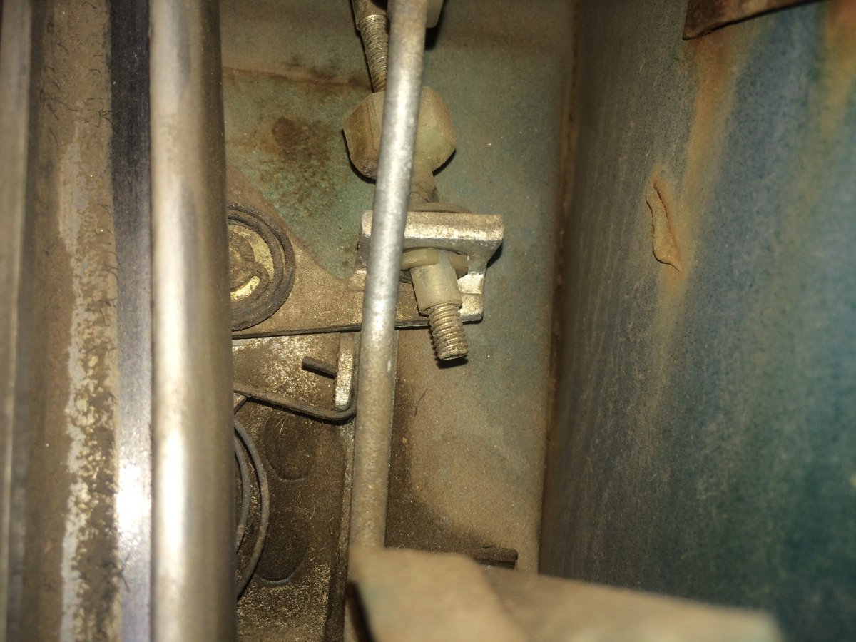

AndBir Posted December 23, 2018 Posted December 23, 2018 I took some pics of my 1973 made (1974 complianced) 260Z door inner workings as shown below - may or may not help? Quote
