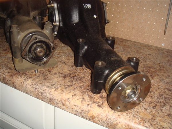

GregTas Posted September 1, 2018 Author Posted September 1, 2018 (edited) Thanks I did some checking and it looks promising. I didn't realise they might bolt straight. The flange is a good size. I found a pic of a Sti diff that could be suitable Do you know what model Subby would work? Edited September 1, 2018 by GregTas Quote

Cozza Posted September 1, 2018 Posted September 1, 2018 I think all sti’s had R180’s so any sti one should work. Yes they use the same spline, I currently run an sti LSD diff I just swapped the input flange and use some output shafts from the states to suit the Subaru spline count and circlip hold in method. Ill check out the shed/tip and see if I can find my one. You’re welcome to it. Quote
TOO60Z Posted September 4, 2018 Posted September 4, 2018 There is the possibility of the larger flange fouling on the sway bar if you are going to run one. Quote
