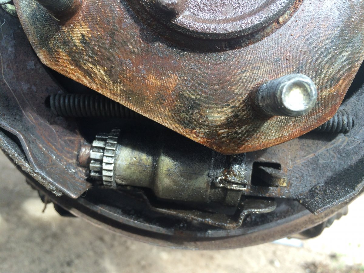

Brabham Posted August 29, 2018 Author Posted August 29, 2018 Thanks guys, will give it another go on the weekend. Andbir do you have a photo of where the adjuster sits on the rear left? Cheers Quote

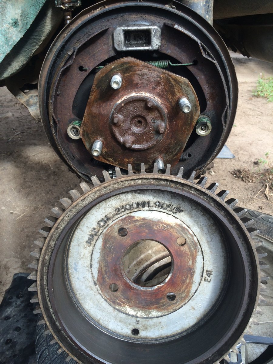

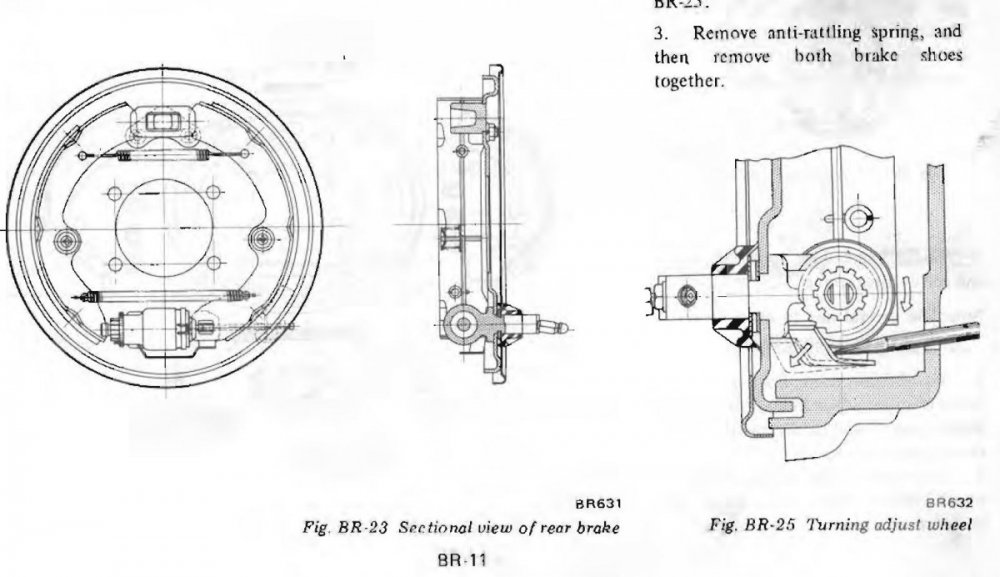

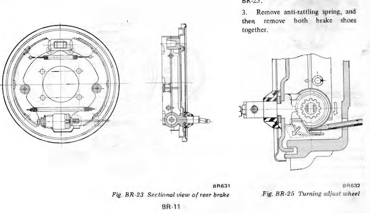

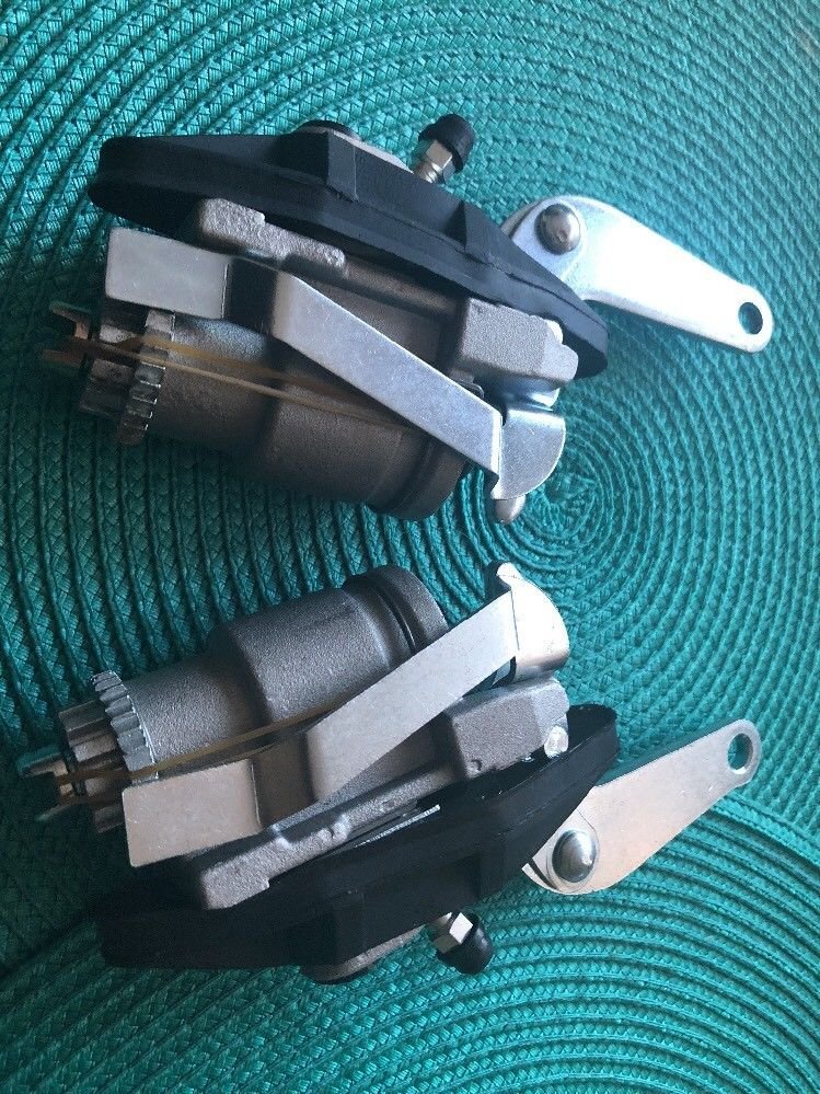

AndBir Posted August 29, 2018 Posted August 29, 2018 33 minutes ago, Brabham said: do you have a photo of where the adjuster sits on the rear left? Here it is and a pic from eBay showing new cylinders with the lever you need to move to allow adjustment. Also a image showing how to move the lever using a screwdriver. Quote
Brabham Posted August 29, 2018 Author Posted August 29, 2018 Thanks for that, will give it a try Quote
