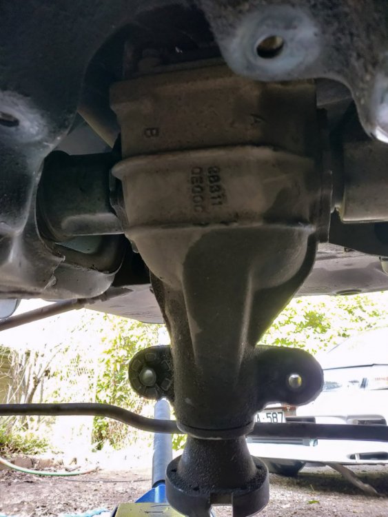

Andrew_L26 Posted August 27, 2018 Posted August 27, 2018 Hi guys, I've got a shortnose 3.36:1 R180 LSD from a car I'm parting out. Would it be worthwhile swapping out the internals into a longnose housing? It's going into my 2+2 turbo which I'm hoping for a fair bit of power out of (250kw+) I was originally going to do an R200 as they're a bit heavier duty and should handle the power much better. I'm running an RB30 gearbox with the L-series bell housing, pretty standard ratios. Andrew Quote

Andrew_L26 Posted August 27, 2018 Author Posted August 27, 2018 31 minutes ago, 260DET said: Short nose pinion is too short to fit a long nose diff, the R* series R180 are stronger than the earlier Z 180's, they can be identified by a big R cast into the top of the case. For circuit work that R will take a few hundred horses but go easy on the burnouts. NB * Been ages since I had anything to do with these, I'm fairly sure the big letter is a R. Nah, the letter is a B and there is also an A Not to worry, didn't think it wouldn't be suitable but I just thought I'd double check! Thanks guys, Andrew Quote

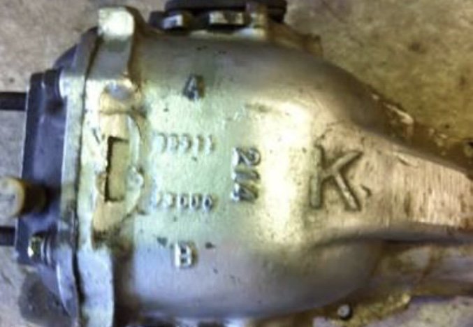

Riceburner Posted August 28, 2018 Posted August 28, 2018 It will be a large ‘K’ cast in the top of the diff case, this differentiates it a late R180 with 115mm crown wheel. They were from the mid 80’s onwards. 260DET and Andrew_L26 2 Quote
