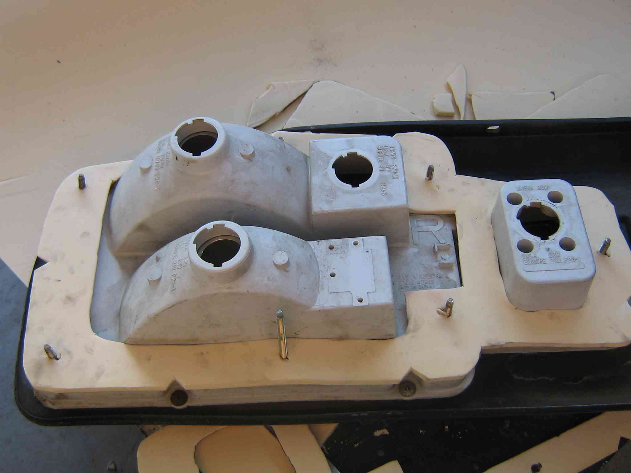

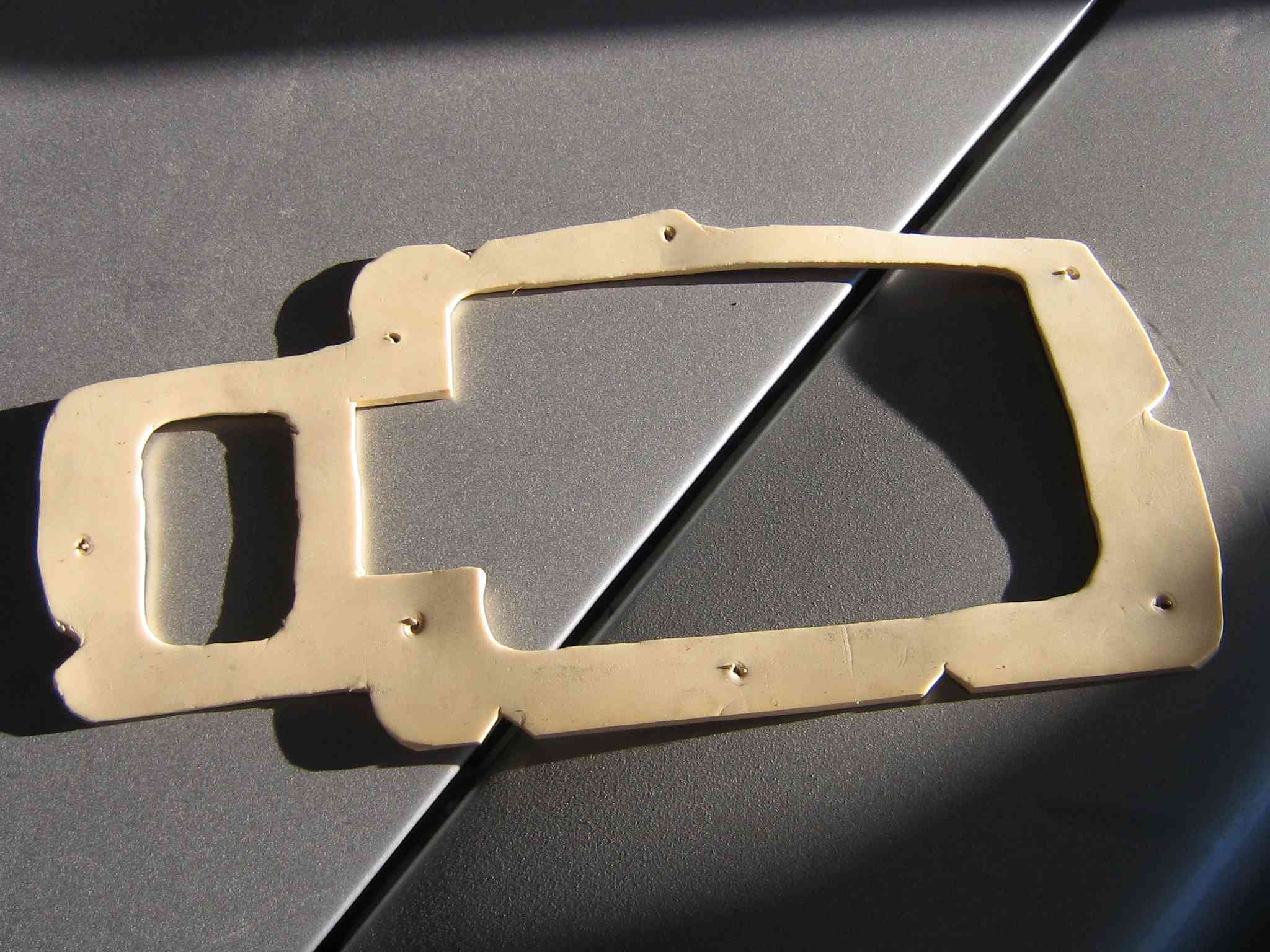

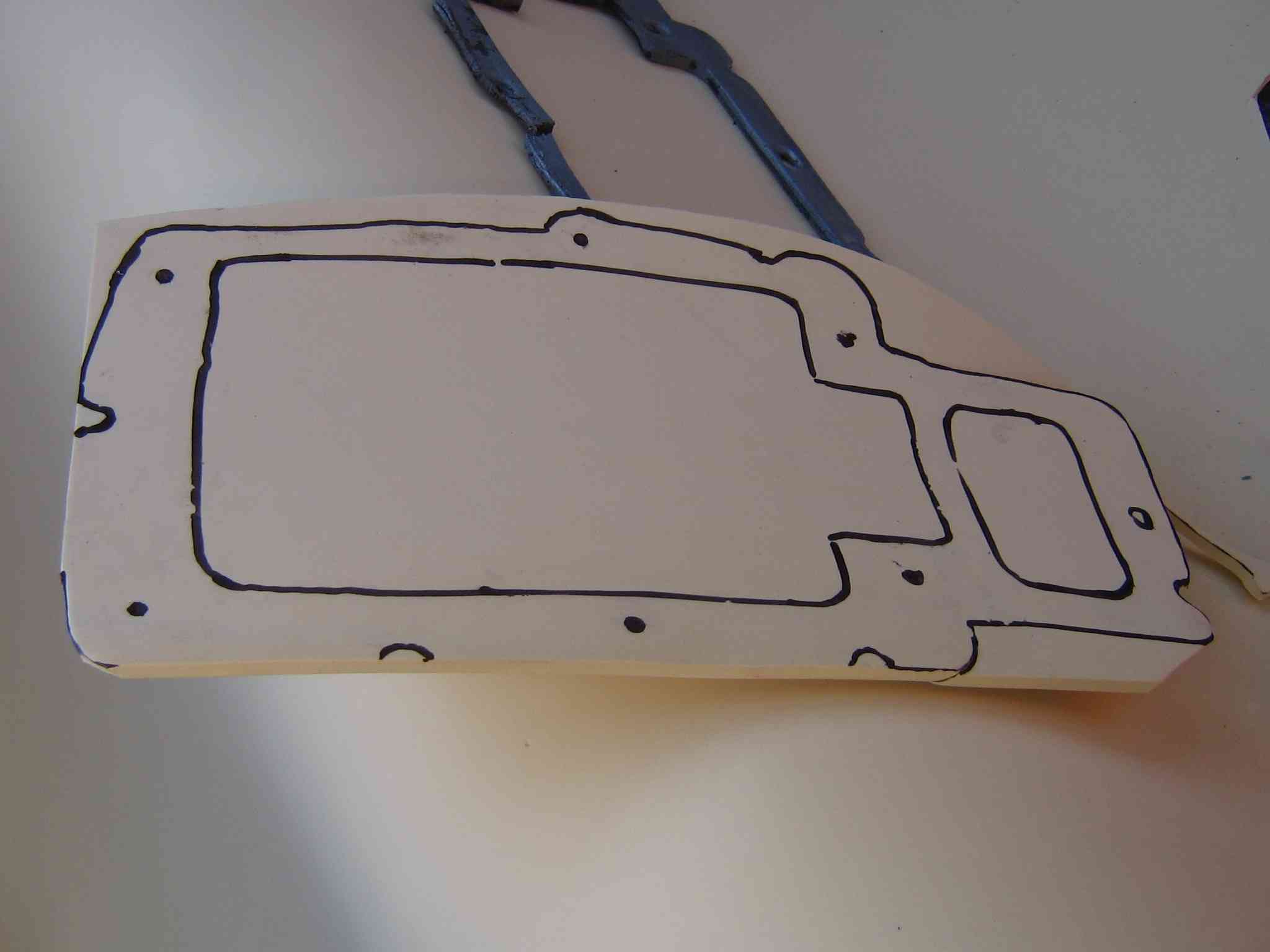

Here's a better way than importing or trying to find tail light gaskets D.Y.I!  We went to Clark Rubber and bought some high density rubber in exactly the right thickness, retrieved the old gasket, made a template and off we went....fits perfect!

bit of DIY and u cannot tell the difference. so u can pay $50 for one seal for tail light or make your self two for $10
