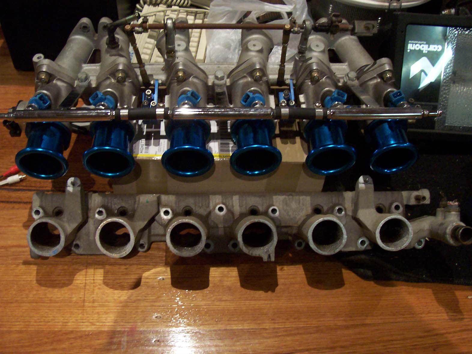

NZeder Posted May 18, 2008 Posted May 18, 2008 ill explain later. email is buggered, and the forum just spat out my last post and lost it!!!!!!! or im losing it @ the pc!!!! attached is the dwg of the throttle body flanges, forgot what you wanted me to do with them? cheers nato Cool - the bottom is a copy of the Tomei metal TB gasket which is larger than the actual manifold/TB as they diameter of the TB is 44m and 45mm at the manifold. In fact if you rotate a DCOE flange (ie the top one) it looks like the bolt holes are in the same location. So basically I will make a single flange/adaptor that will bolt up to the RB26 manifold with counter sunk allen bolt this adaptor will also have the DCOE bolt pattern on it with the DCOE studs locktite in place. I will make the flange/adaptor 12mm-15mm thick. Regards Mike Quote

Moderators Zedman240® Posted May 19, 2008 Author Moderators Posted May 19, 2008 Hey Nzeder, are you using and modifying the RB26 inlet manifold or the RB25? I'm starting to cut up the RB25DE manifold. I've located water jet cut mounting plates for DCOE pattern carbs to weld to the runners of the RB25 manifold. Trick is how to cut the manifold? I'm thinking of buying a sabre saw (bigggg jigsaw thing) to cut down the casting marks about 80mm from the mounting face. Then if all goes well, near my work there are places that can weld aluminium (plates to inlet). Then all thats left is to machine the front face where the TB's mount. Quote
NZeder Posted May 19, 2008 Posted May 19, 2008 Well as I have 2 x RB26 heads I am using the RB26 manifold and making up an adaptor to change from the 26 throttle body bolt pattern to the DCOE pattern. The DCOE have a 90mm centre to centre for the throttle plates and with my weld on flange that I have (purchased from Tweakit.net in Sydney some time ago when I purchase the EFI hardware DCOE TB) there is next to nothing in the centre to centre of the standard 26 TB spacing it is the bolt holes that are different (maybe 91mm). So I have ordered my 5083 Alloy (read marine grade) plates today - 20mm thick x 120mm high x 200mm long (3 of them one for each TB) I will see if I can find a pic of the little 26 manifold that I have/will be using for this task - as I have dropped of the manifold in question ready for the making of the flanges/adaptors. Quote
NZeder Posted May 19, 2008 Posted May 19, 2008 here is pic from the Tomei Website which shows were their metal gaskets for the Rb26 head go. You will see the little manifold I will be using as the one that goes next to the head before the standard 26TB's I hope this helps. Quote
Moderators Zedman240® Posted May 20, 2008 Author Moderators Posted May 20, 2008 I managed today to cut up the original plenum/inlet manifold of the RB25 with a sabre saw, was also surprised how quickly it got through it with minimal cursing! Its amazing how close the spacing is to my Redline triple DCOE manifold..Going to pickup the DCOE plates from EFI Hardware tomorrow to test fit and hopefully weld on then assemble the throttle bodies and linkages (which should be heaps of fun!!) Nzeder, I thought you were going to use the same manifold but looks like we are going different directions to finish in the same place! Yesterday I farewelled a nice motor; Monaroz picked up the L28 to fit in another Z engine bay...anyways, time to evolve the Zed! Quote
NZeder Posted May 20, 2008 Posted May 20, 2008 I managed today to cut up the original plenum/inlet manifold of the RB25 with a sabre saw, was also surprised how quickly it got through it with minimal cursing! Its amazing how close the spacing is to my Redline triple DCOE manifold..Going to pickup the DCOE plates from EFI Hardware tomorrow to test fit and hopefully weld on then assemble the throttle bodies and linkages (which should be heaps of fun!!) Well done Nzeder, I thought you were going to use the same manifold but looks like we are going different directions to finish in the same place!nope the RB26 has different intake mounting setup so I have to use this little manifold first which does make it easier to make a bolt on adaptor. But your weld on setup will do the same thing Yesterday I farewelled a nice motor; Monaroz picked up the L28 to fit in another Z engine bay...anyways, time to evolve the Zed! I still have 3 x L28 and my original L26 + my RB30E and other RB26 head so I have lots of engines I just can't get rid of the old L6's in case I want to race the car in a different class that does not like the idea of the RB as a S20 replica or as close as I can get these days I don't have the 30+K for a real S20 engine. Quote

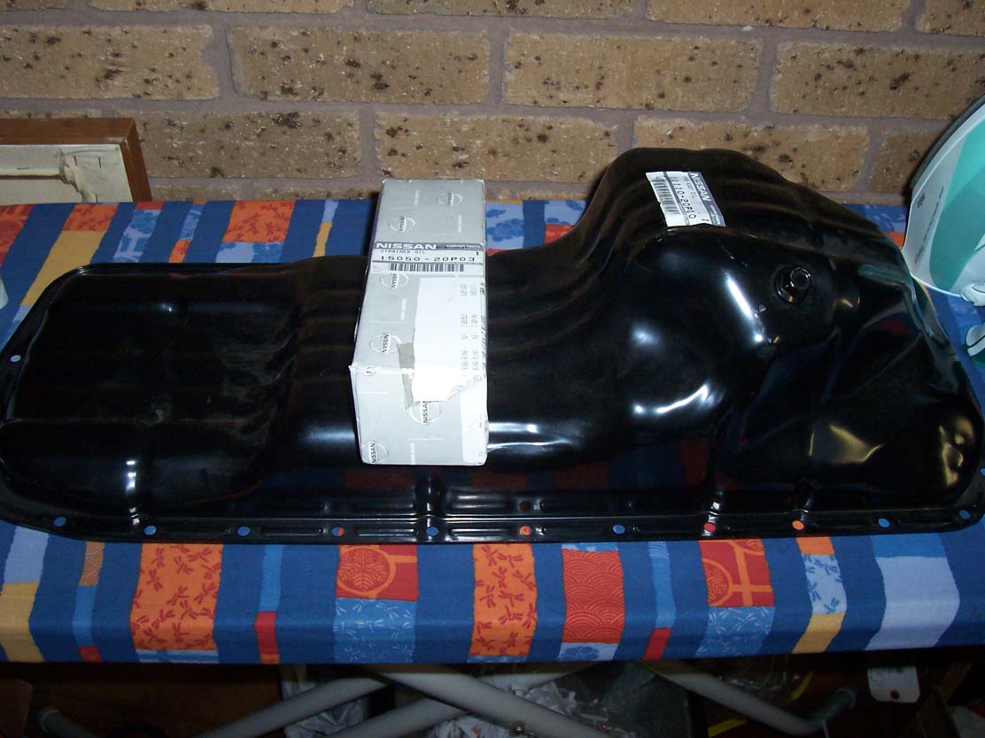

Moderators Zedman240® Posted May 22, 2008 Author Moderators Posted May 22, 2008 Good news everyone, (just watched Futurama) I'm a happy little camper this afternoon, well anyone would be when you find out your RB20 sump and pickup arrived from Texas! A big thanks goes to Butch at Courtesy Nissan in Texas for getting it to me in about a week! The project is snowballing now!!!! Quote
NZeder Posted May 22, 2008 Posted May 22, 2008 Nice - I installed my sump the other week when I did the test install. I must say the rear sump looks a little small when on the block and sitting in place - if you look at the pic above you can make the sump larger from the first hump/raise to the rear there is that much room. See my earlier pics to see this. I am thinking that when the engine is removed so the engine bay can get painted I will have my nice new sump modified to extend the bowl and add a wing and trap door setup thing. Or I might just modify the standard front sump and sell this one on. Not sure yet. :EDIT: oops did not post the pic I thought I had so here it is. Quote
Moderators Zedman240® Posted May 22, 2008 Author Moderators Posted May 22, 2008 Hey Nzeder, I was going to ask you about modifications to the sump but you just answered it! It does look small but I was going to try it anyways and just as a precaution, overfill the oil by about 1/2 litre or so when I do a circuit event. My old L28 never had a modified sump and I also overfilled slightly and never had an issue. Zedevan, all up cost including shipping was $US400 (sump/oil strainer) You will also spot the GQ Patrol sump I put on ebay! Quote
NZeder Posted May 22, 2008 Posted May 22, 2008 That sounds about right for the sump. Locally Nissan NZ wanted around $600 for sump and pickup. I got mine from the US too. But I got mine via a friend in the US as the guy I got mine from (http://www.nissanpart.cc) would not sell to an international purchaser but his price was the best $149 USD. So I collected when I was in the US on business from my friend so I was lucky it cost me under $200 USD for the sump, pickup and o-ring as shipping was via my suit case. Quote

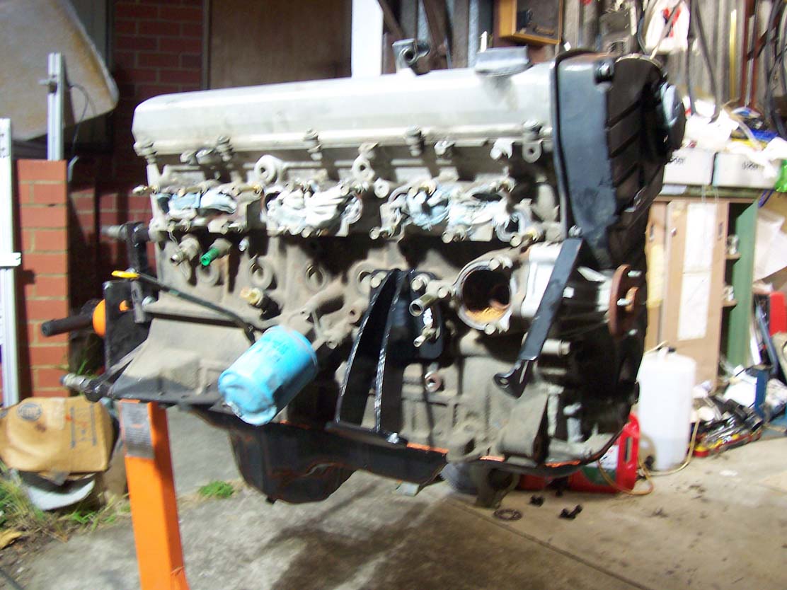

Moderators Zedman240® Posted May 26, 2008 Author Moderators Posted May 26, 2008 More progress to report on... Tonight oil strainer and sump went on, dipstick moved to the rear and manifold was machined (after my hacking away with a saw by hand!) and dropped off to be welded together. I was concerned a little when they welder told me "hope you are not expecting it this week!" How long do you expect to be? I'm sure I'll let the forum know...I think while the engine is on the stand, it would be wise to do a cam belt/idler pulleys. Knowing my luck, you install the engine and then you are greeted by a whining sound from the front of the engine you just cant work out where it's from..... Quote
