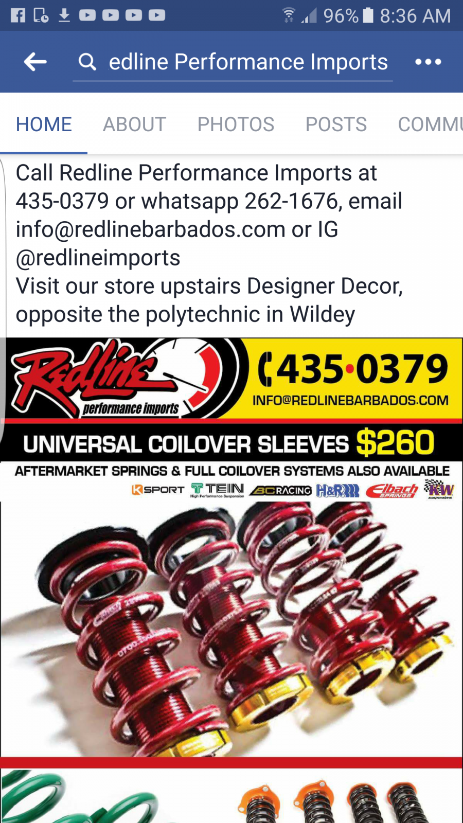

Retro Z Posted April 28, 2017 Share Posted April 28, 2017 Those cosmo springs bind. And don't have alot of travel. You'll be riding on the bump stops or with the springs fully compressed. Redline performance is currently selling proper coilver sleeves for not much more. You'll need to section (remove a inch or so) from the strut tube to gain more travel. Its not hard or expensive to do. Www.redlinebarbados.com Quote Link to comment Share on other sites More sharing options...

theremm Posted October 28, 2017 Share Posted October 28, 2017 Redline performance is currently selling proper coilver sleeves for not much more. You'll need to section (remove a inch or so) from the strut tube to gain more travel. Its not hard or expensive to do. Www.redlinebarbados.com Anyone using these in their car currently? Considering purchasing a set however would be good to speak to someone/hear feedback before going ahead. Quote Link to comment Share on other sites More sharing options...
