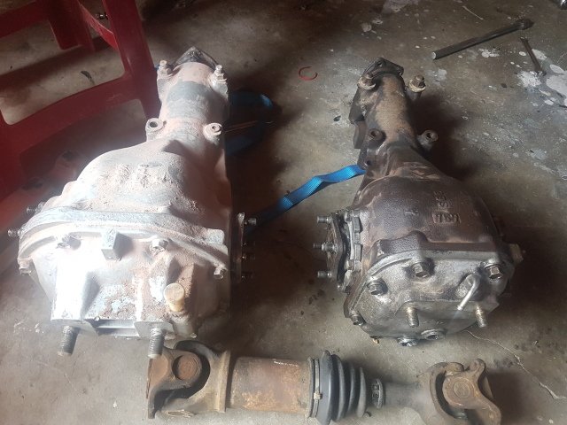

aircobra Posted March 4, 2017 Posted March 4, 2017 just about to put it back (once i get the new mount) and the fsm only shows the entire assembly being removed? Quote

aircobra Posted March 5, 2017 Author Posted March 5, 2017 mine's a standard 180 http://oi33.tinypic.com/uu8ap.jpg so i was wondering if can push the shafts in enough to clear the bolts Quote
Retro Z Posted March 5, 2017 Posted March 5, 2017 (edited) The stub axle is bolted in on 240z (r180) and clipped on 260z (r200) But aircobras question is can he bolt in the driveshaft afterwards, Which is yes. Either diff has the flange on the stub axle to bolt onto the halfshaft (drive shaft) If you loosen the rear control arms you can move the whole assembly (strut and brakes) out of the way but the shafts have enough compression and extension to clear the studs on the stub axles to install/uninstall the diff) Edited March 5, 2017 by Retro Z Quote
Moderators PB260Z Posted March 5, 2017 Moderators Posted March 5, 2017 The stub axle is bolted in on 240z (r180) and clipped on 260z (r200) But aircobras question is can he bolt in the driveshaft afterwards, Which is yes. Either diff has the flange on the stub axle to bolt onto the halfshaft (drive shaft) If you loosen the rear control arms you can move the whole assembly (strut and brakes) out of the way but the shafts have enough compression and extension to clear the studs on the stub axles to install/uninstall the diff)] Yeah, I lost sight of aircobra's original question.That is exactly how I did mine, and it was a simple enough job. Retro Z 1 Quote
dat2kman Posted March 5, 2017 Posted March 5, 2017 Squeeze the two ends of your halfshafts together. There is enough room to slip over the studs in the diff output flanges. Quote
