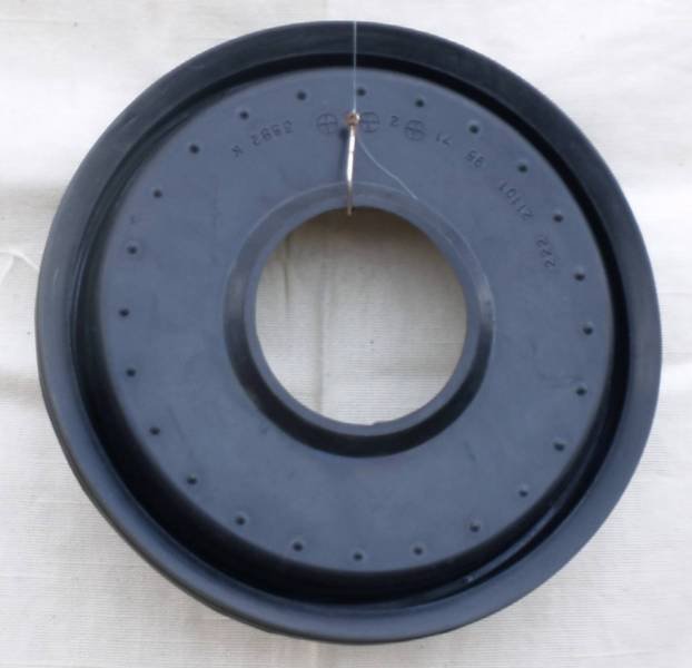

GongZ Posted February 27, 2017 Posted February 27, 2017 The Z shop in Victoria sells a "Datsun 7" brake booster new rubber diagfram 240Z 1600 180B SSS" for $55 + postage http://www.gumtree.com.au/s-ad/burwood/brakes-suspension/datsun-7-brake-booster-new-rubber-diagfram-240z-1600-180b-sss/1129727719 Quote
Moderators PB260Z Posted March 1, 2017 Moderators Posted March 1, 2017 The Z shop in Victoria sells a "Datsun 7" brake booster new rubber diagfram 240Z 1600 180B SSS" for $55 + postage http://www.gumtree.com.au/s-ad/burwood/brakes-suspension/datsun-7-brake-booster-new-rubber-diagfram-240z-1600-180b-sss/1129727719 Handy to know, but as Jason inferred, they are a PITA to work on. Quote
