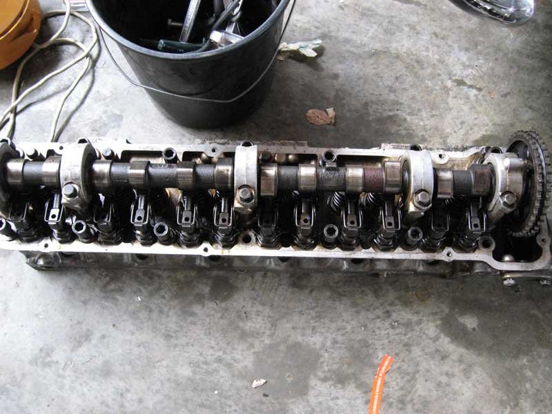

At 5850 rpms  ( and a lot of smoke ) the above engine made 105 hp at the wheels and then I think it died! As the car is basically undrivable now.
I have a n42 head that i stripped down to its bare essentials that is going off to be cleaned ( remarkably good condition though ) and hopefully a l28 bottom end from d3c0y coming.
Yep I get to build an engine again to my specs. Piccies of how anally retentive i am in number valves , springs etc coming.
