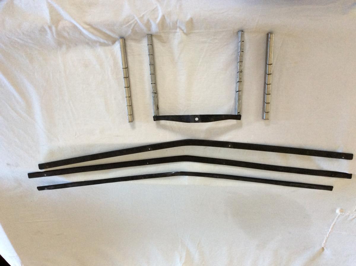

aircobra Posted July 31, 2016 Posted July 31, 2016 couple of the uprights are damaged it looks like a u-channel 0.5mm folded ali section with slots cut out my understanding is that a normal mig setup won't do ali has anyone tried making new set? Quote
dat2kman Posted July 31, 2016 Posted July 31, 2016 Got a set here, fabricated, and slitted. Also incomplete number of horizontal slats ( no f TBA Sell the lot, $70 includes postage Quote
aircobra Posted July 31, 2016 Author Posted July 31, 2016 super. all 4? pm me your paypal address Quote

dat2kman Posted August 1, 2016 Posted August 1, 2016 Only 3 slats, and four slitted vertical pieces. Quote
aircobra Posted August 1, 2016 Author Posted August 1, 2016 2 orignals and 2 repaired verticals? Quote
