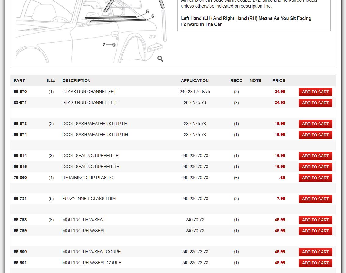

AndBir Posted February 24, 2018 Posted February 24, 2018 Can someone provide some further info on the best source for the inner and outer window "weatherstrips" - outside rubber and the inside felt. Numbers 5 and 6 on the diagram below (ex Black Dragon) Quote

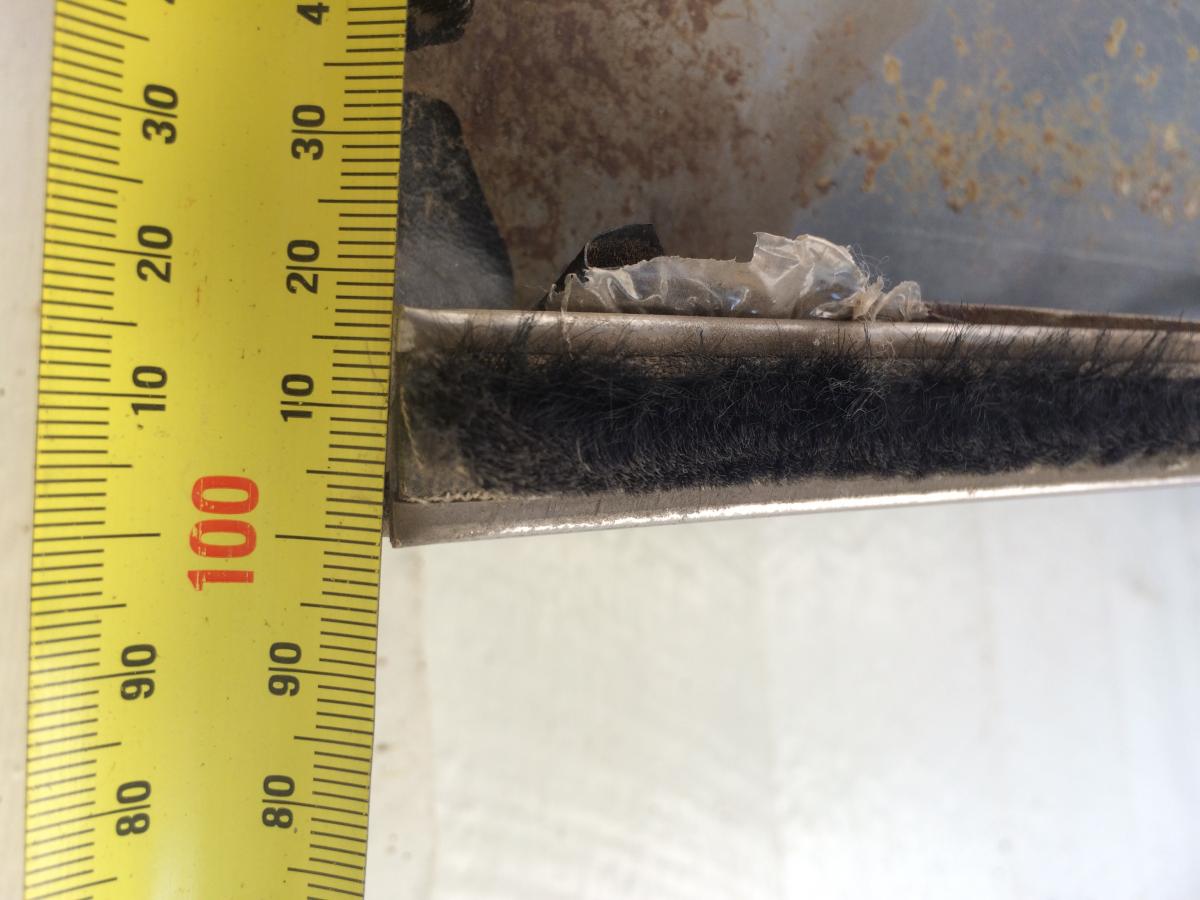

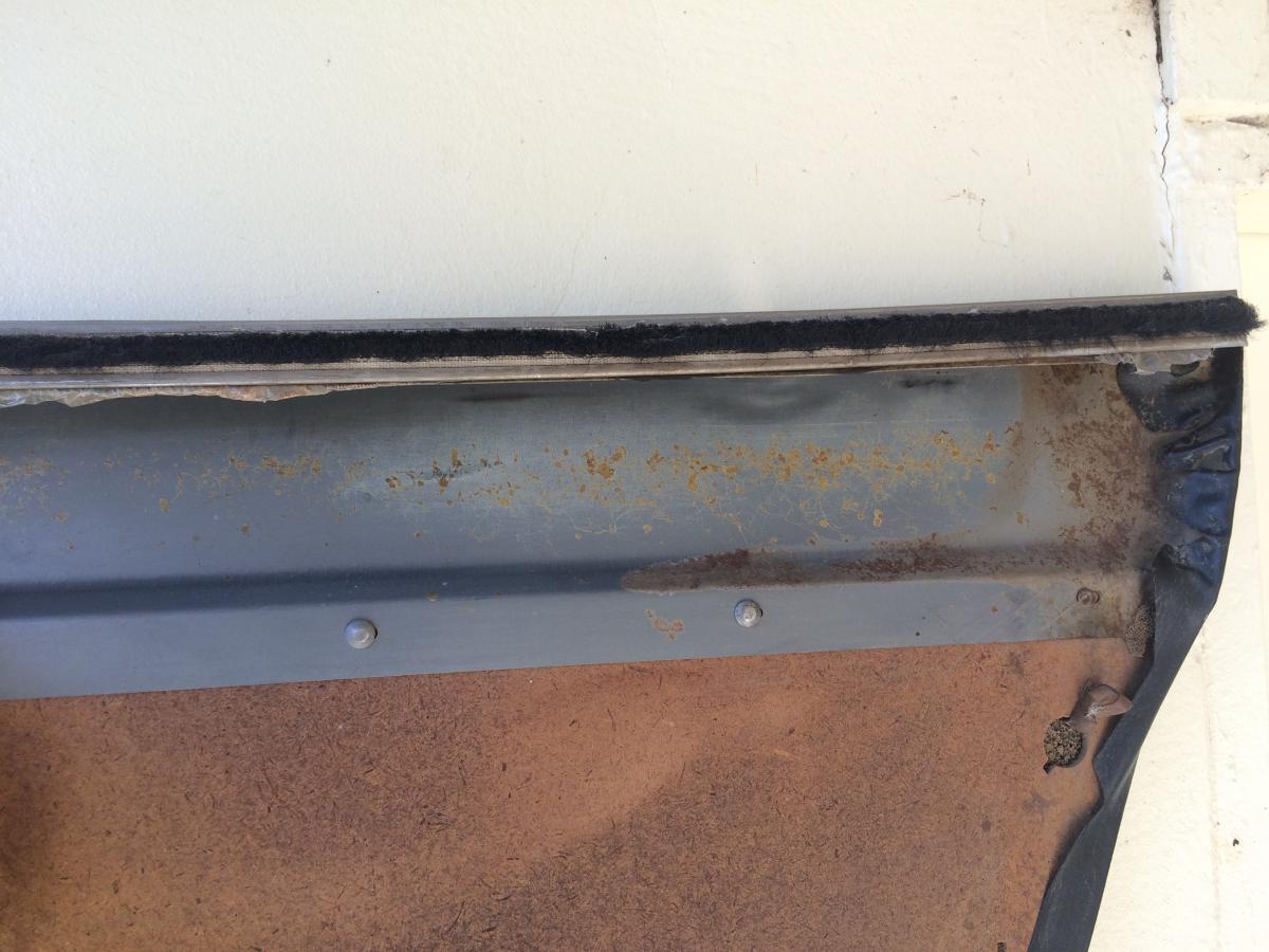

AndBir Posted March 5, 2018 Posted March 5, 2018 (edited) What are people doing to replace the inner felt "weather" strips on their doors that is attached to the top of door cards? Mine have seen better days : I have found a company in the UK that supplies what looks to be very good replacements however it appears they only supply in bulk lots. http://www.automobiletrim.com/popup_ws132.html http://www.automobiletrim.com/images/windowchannels/ws132.jpg I will see if I can get the minimum order down to something more reasonable than the current 100 x 2 metre long strips (at a very reasonable price of AUD$6 per length! ex shipping) !! Edit: I emailed Rare Spares and asked if they stock this and if not then they should get some in. Edit#2 : Apparently Rare Spares do have the door inner belting : "They are supplied as part number RDB0019, but are a non-stocked item. The last price was $30.85 each, but that may change slightly. Delivery to our shop will take anything from 4 -8 weeks from ordering, and we will require a deposit." Edited March 6, 2018 by AndBir lightmaster240z 1 Quote

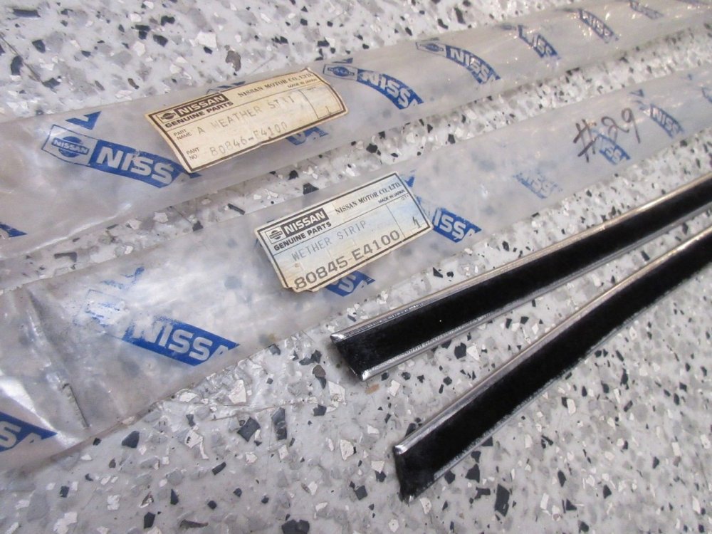

AndBir Posted March 8, 2018 Posted March 8, 2018 Here are the NOS part numbers for the inner door belt, a L & R pair just sold on eBay for USD$99 (plus USD$89 postage) lightmaster240z 1 Quote
AndBir Posted March 19, 2018 Posted March 19, 2018 Managed to source the 80845-E4100 for JPY3,097 (~AUD$38 each) from Motors Head Japan. Purchased two, as the only difference between the left and right ones is the angle the ends are cut. Postage from Japan AUD$20 Quote
