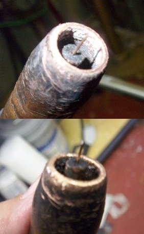

blu260z Posted April 3, 2016 Author Posted April 3, 2016 (edited) Sirpent I havent heard of that before. The gasless mig doesnt even need a shroud/nozzle, it uses the flux in the wire to protect the weld. Here is my nozzle setup it is what is supplied by Lincoln welders. Edited April 3, 2016 by blu260z Sirpent 1 Quote
Sirpent Posted April 3, 2016 Posted April 3, 2016 Im trying to find the YouTube tutorial, but I believe that what he was conveying was that the nozzle set up on a gas set up creates a chamber for the gas to shield the wire with the welding tip tucked inside the nozzle some 5mm. Reducing the nozzle length brings the welding tip closer to the weld area but still protects it from melt down. Effectively, the tip set up you have shown has the tip fully exposed The pic attached shows the set ups I was refering to. Still think you have done many on here a service with your tutorial, well done, its just that many will have a traditional nozzle set up and some fine tuning may be needed to get the right results, it was good that you clarified your set up. Cheers John Quote
blu260z Posted April 3, 2016 Author Posted April 3, 2016 John that setup would work perfectly fine. But for gasless no nozzle is required. Only real reason I can see for making the nozzle shorter is so the end doesnt fill up with spatter because there is so much more with gasless. Quote
